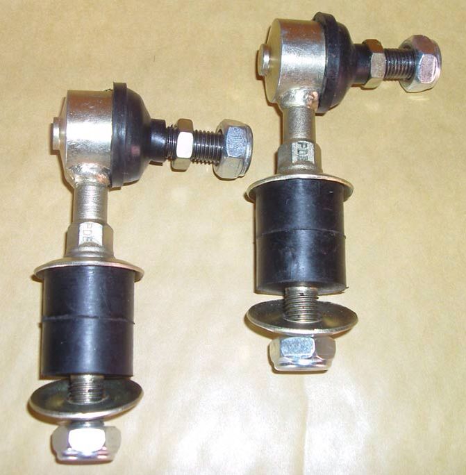

akyakapotter Posted January 3, 2013 Posted January 3, 2013 Hey people have a bit of a problem that's got alot worse in recent months. When pulling off from a stand still I get a knock from the suspenssion some where and also when I'm driving like over bumps ect. its driving me Insane it's not the engine mounts as there Polybush any help would be great I don't wanna go replacing parts that don't need to be thanks in advance nick. Quote
steve-gers Posted January 3, 2013 Posted January 3, 2013 Anti-rollbar bushes possibly. Worth a check. Quote
steve-gers Posted January 3, 2013 Posted January 3, 2013 Could be them rubbers or could be the d shaped ones that attach to the body Quote
Skimmy237 Posted January 3, 2013 Posted January 3, 2013 Try the top and bottom ball joints maybe ? I'm just a car painter so not 100% but they were fucked in my last car and it knocked ?:/ so could be worth a try Quote
akyakapotter Posted January 3, 2013 Author Posted January 3, 2013 Ill have a look in a bit I hope it's something easy Quote
steve-gers Posted January 3, 2013 Posted January 3, 2013 Get it up in the and use a pry bar for leverage to check all the rubber bushes. Quote
akyakapotter Posted January 3, 2013 Author Posted January 3, 2013 It's those drop links think its time to replace the whole thing with a whiteline one Quote
akyakapotter Posted January 3, 2013 Author Posted January 3, 2013 No need to worry now I ordered white line to replace it all Quote
