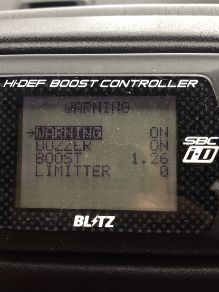

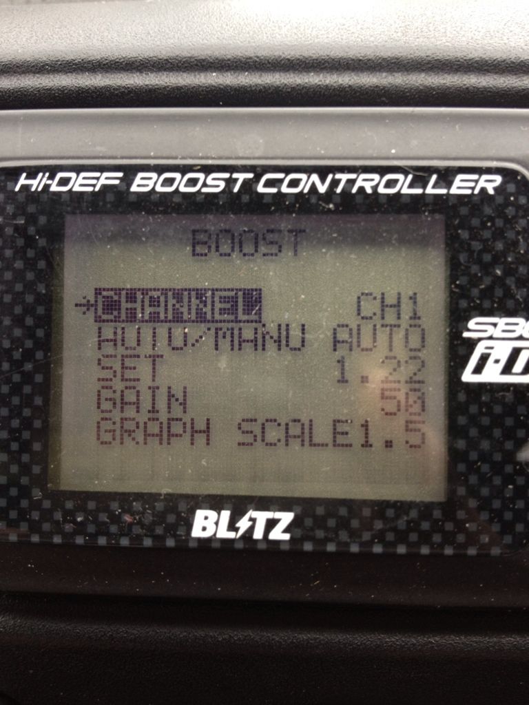

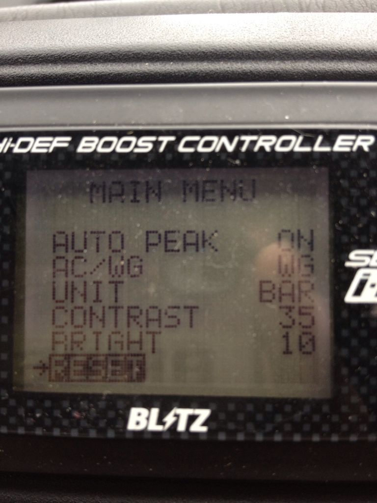

jakeep82 Posted February 4, 2013 Author Posted February 4, 2013 There you go bud ive always used ch1 and just made sure its still on ch1 Quote
AdamB Posted February 4, 2013 Posted February 4, 2013 Looks ok to me mate. You could try adjusting the gain but if its only started doing this recently I doubt it would have anything to do with it. Quote
