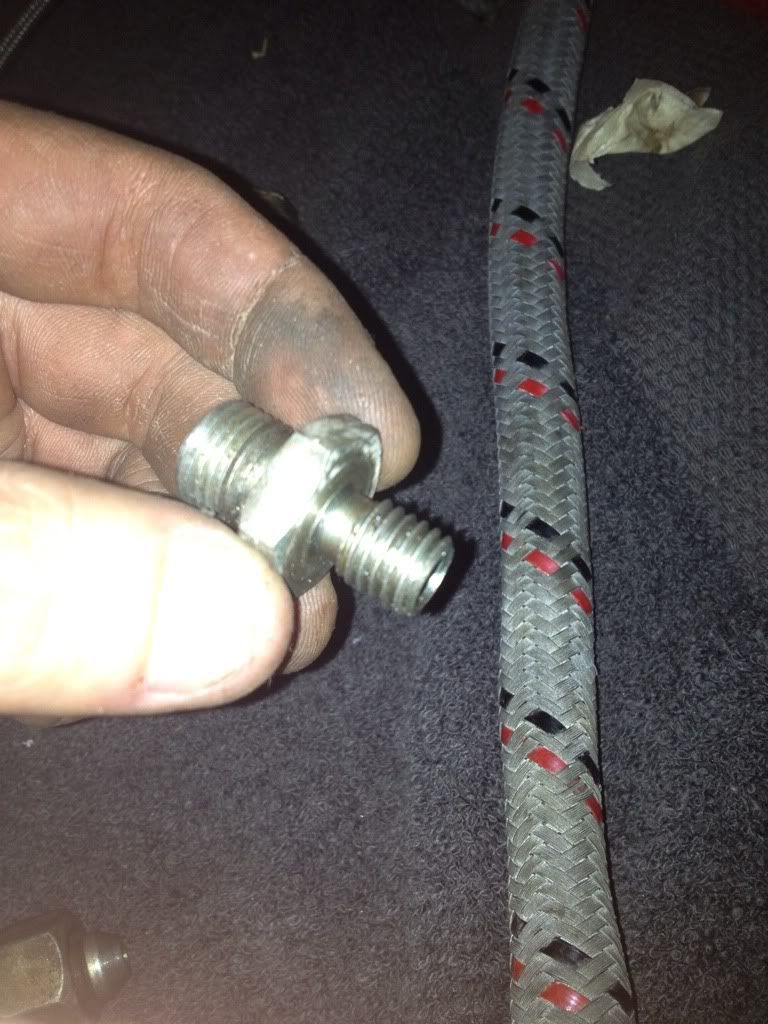

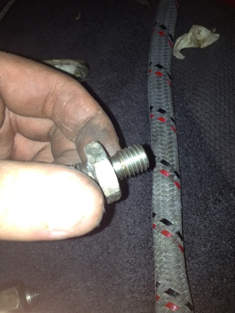

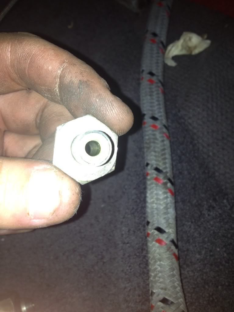

A L 3 X Posted February 12, 2013 Author Posted February 12, 2013 Something similar mate i'll get a quick pic? Ah really? Yeah i read somewhere late td04's came with a really fine holed bolt or something and mines from a 52 plate car so didnt want to over feed it thats all Quote
A L 3 X Posted February 13, 2013 Author Posted February 13, 2013 Here we go mateExcuse the state of my hands was giving the turbo a clean lol Quote
WallaceGlanza Posted February 13, 2013 Posted February 13, 2013 That's just a metric to BSP fitting, looks like the kits Dave B (TMD) sold so will be fine. Quote
A L 3 X Posted February 14, 2013 Author Posted February 14, 2013 Yeah the line screws onto this after this has screwed onto the turbo.That sounds good then, heard good things about Dave(r.i.p) Quote
