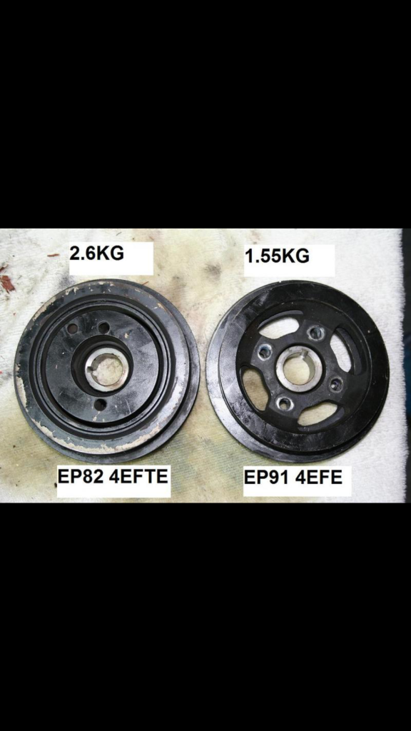

Towbar Posted January 20, 2014 Posted January 20, 2014 Does anyone know if the crank pulleys are the same on a 4E and 4efte?One of my local parts places reckon so? Quote
maddox710 Posted January 21, 2014 Posted January 21, 2014 I thought they were different. The n/a one is 1.5kg without the harmonic damper in the middle were as the fte one weights nearly 3kg Quote
AdamB Posted January 21, 2014 Posted January 21, 2014 Part numbers are the same according to ToyoDIY for a 97 glanza and euro N/A. Quote
maddox710 Posted January 21, 2014 Posted January 21, 2014 Part numbers are the same according to ToyoDIY for a 97 glanza and euro N/A. I have both on the shelf but the n/a one is solid and fte has all the rubber damper in it, so now my question is which would you use on your fte build??? Quote
AdamB Posted January 22, 2014 Posted January 22, 2014 (edited) I have both on the shelf but the n/a one is solid and fte has all the rubber damper in it, so now my question is which would you use on your fte build???Harmonic damper all day long. I would take the extra reliabilty over the weight of a turd anyday. Edited January 22, 2014 by AdamB Quote
AdamB Posted January 25, 2014 Posted January 25, 2014 Just to add my 5E has a harmonic damper pulley on it as well, so I'm guessing pulleys changed based on the year the engine was produced, probably to do with costs. Quote
