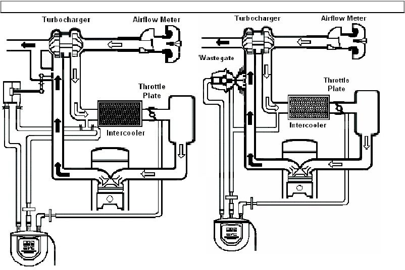

Basically I'm mid way through td04ing my glanza and I have a HKS ebc on the car the further eat left port goes to the map sensor boost gauge and back of the inlet, the middle one was to the actuator on the ct9 and the furthest right was on the turbo I was wondering if anyone knew how to plum this in for a turbo smart external wastegate which has two ports lower and upper, much appreciate
So from that I got middle one goes to bottom of WG and turbo and then far right goes to too of WG then the far left leave where it is, thanks bud
