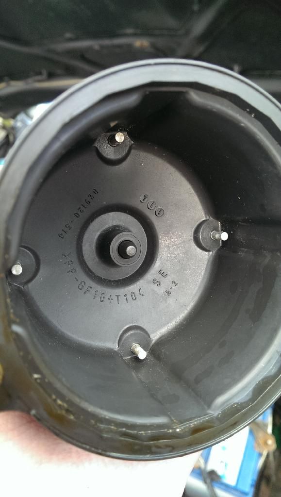

white-gt Posted February 16, 2014 Author Posted February 16, 2014 Does this cap look alright to u guys? Cleaned up. Quote
sosolid Posted February 20, 2014 Posted February 20, 2014 (edited) that looks brand new mate. u shud see mine after I cleaned. The cuts in the metal bits are deeeeeeper. I might neeed to change it. Also mate what ECU you got. I got a Blitz ECU for 2 years now. What I did today I took the negative terminal off the battery and left it for abut 20 mins. Then connected it and guess what. No splutter or misfire or jerkiness lol. Hope it stays like that. Edited February 20, 2014 by sosolid Quote
white-gt Posted February 20, 2014 Author Posted February 20, 2014 yeh thats what i thought also! ive seen worse. not even getting boost, as soon as you try get accelerating it splutters. bought new plugs and its just the same,im borrowing leads from a mate to see if that helps.i ordered a cap into toyota but if you dont think it needs it then i wont bother with it.. im running a dastek unit, i was only getting miss fire higher up the range in 3rd really but strange how it suddenly got so bad after i changed the rotar arm and cleaned the plugs.. i started a new thread in "engines " with more detail and pics.. Quote
