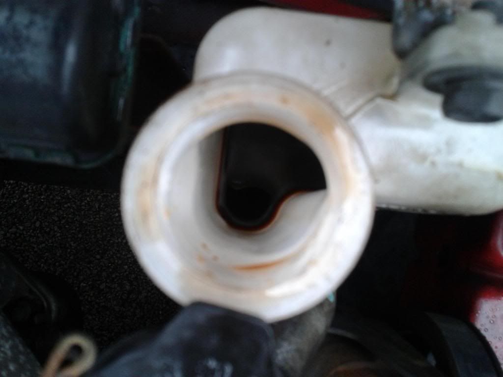

Manny Posted March 2, 2014 Posted March 2, 2014 (edited) looks very dark brown almost black, cant presume if its a colour of the anti-freeze? Edited March 2, 2014 by Manny Quote

morgey Posted March 2, 2014 Posted March 2, 2014 (edited) Yeah you should really. Something to do with the type of seal used is suited to red coolant. And yeah it is but you will want to pull the pipe off to flush it properly Edited March 2, 2014 by morgey Quote
