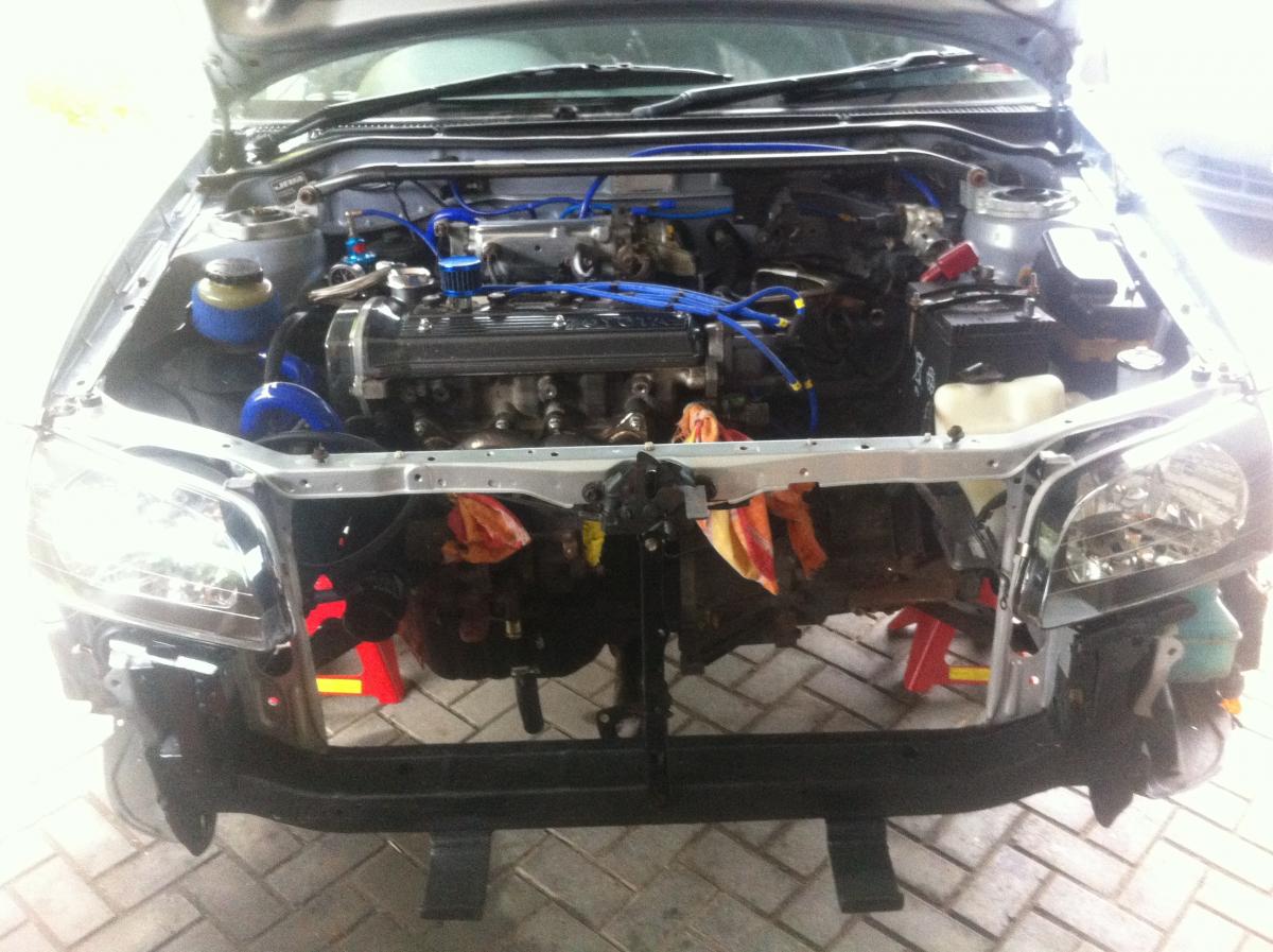

Got magnecor leads, new plugs, cap, points and roose hoses. Sticking to the blue theme

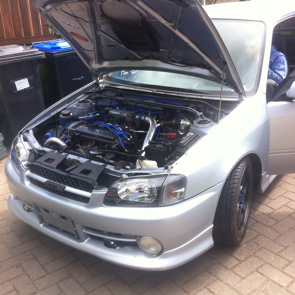

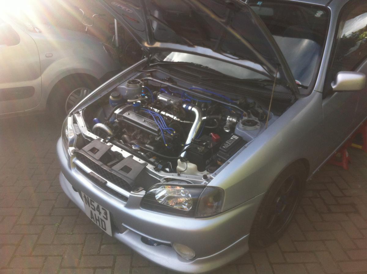

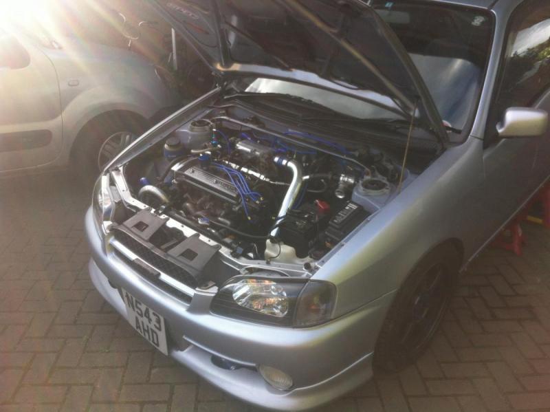

Finally got it running again and sorted my idle problem. Flushed the engine and cooling system before topping it up with new fluids

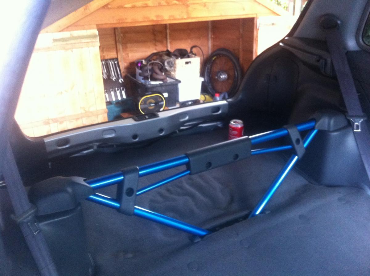

Greddy Profec Boost controller and boost gauge fitted, along with my OMP steering wheel.
post-12398-0-34790900-1437691956_thumb.jpost-12398-0-37477400-1437691908_thumb.jpost-12398-0-17289200-1437692024_thumb.jpost-12398-0-08080600-1437692055_thumb.jpost-12398-0-17257500-1437692081_thumb.jpost-12398-0-26286000-1437692162_thumb.jpost-12398-0-57243600-1437692184_thumb.j
