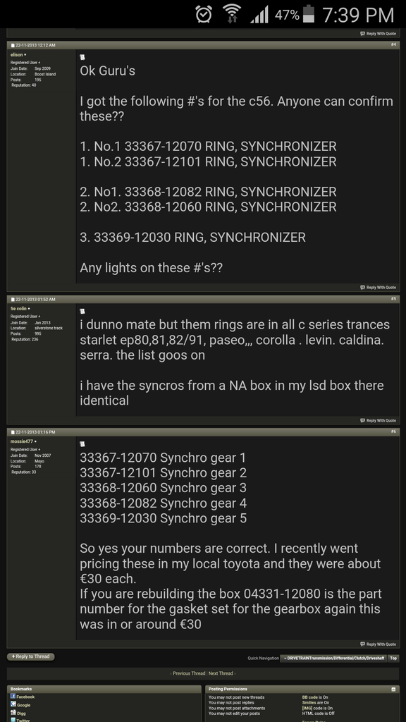

Does anyone have any idea what syncro I will need as I'm going to give it to the gearbox specialist but want to supply the syncro myself.
I got this list off tgtt
Screenshot_2015-04-15-19-39-29_zpskqcycx
33367-12101.
