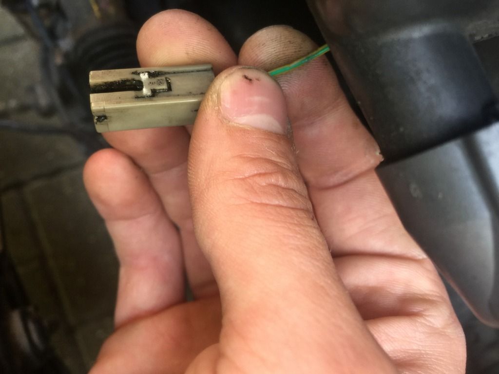

Thanks buddy that's a great help. So I've got two plugs that are not connected to the thermostat housing one is a small square plug with a single wire this has no place to connect as I'm running n/a I have the sensor with the two vacuum fittings on it wich is also not in use. And another single wired plug wich is more of the common shape. Wich has no cable connected to it as all but has a place to go wich I presume is my issue? 5397463A-0985-4CC1-9522-66B2EA0BA52B_zps
AABBB4CB-5718-407B-9BA8-BEBD6E696A41_zps
How can I solve this issue as I have not got the single spade type fitting for the plug in the first picture.
