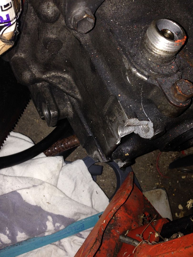

Okay well I have a spare gearbox that works fine in my shed but the casing is broken after a little crash last year. My current gearbox has died a death so I was wondering is it possible to put a new casing on? The mount bolts have been ripped from the casing. Here's a pic but it's not the best. 7D06BCA9-C61D-4767-AFA1-41EA5A471886.jpg
Yeah mate easy as pie I just switch bell housing on mine in a night
Alright man cheers for that! Better than buying a new box
Yeah theres a how 2 install and lsd guide that taggy did. Just use that to swap the housings over and you'll be as good as gold.
Only thing i would say though is that the diff bearings would really want reshimming as you'll be using 2 different boxes. And thats more of a chore lol tbf though not many people bother do it lol
