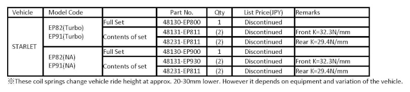

from memory...and a very distant memory i think they drop the glanza about 25-30mm....the front sits a bit lower than the rear
they dont go as low as many of the other brands
however, i found them rather comfortable for everyday usage without having to worry about the car bottoming out
if you want your car scraping the ground car show low....then the TRD springs are not for you
