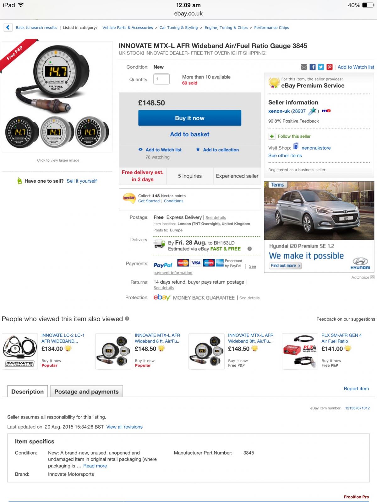

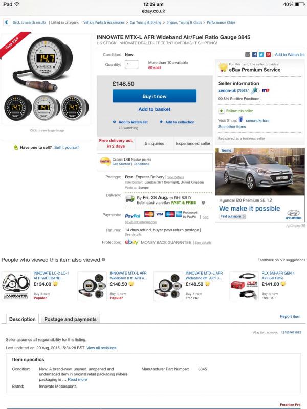

GlanzaV33 Posted August 25, 2015 Posted August 25, 2015 (edited) Hello guys Is there any pros or con with this kit. Do u still run the Oem lambda sensor. ?? Edited August 25, 2015 by GlanzaV33 Quote
5e colin Posted August 26, 2015 Posted August 26, 2015 ya man still run stock o2 sensor great kit indeed this runs on its own not ecu ( stock ) Quote
Flaminsam Posted August 26, 2015 Posted August 26, 2015 I have this same wideband. It features a 0-1v output from the back of the gauge so you can wire that Into your ecu and get rid of the stock lambda. Been running mine for years and not had a problem. Quote
GlanzaV33 Posted August 26, 2015 Author Posted August 26, 2015 I'm running e man blue would I need it linked tin to that Quote
GlanzaV33 Posted August 26, 2015 Author Posted August 26, 2015 Are you still running the lamdba In the same place or have you moved it ? Quote
Flaminsam Posted August 26, 2015 Posted August 26, 2015 Not on emanage blue no. I've put my wideband in the same place as where the standard lambda is. Not had a problem. Quote
epcashin Posted August 26, 2015 Posted August 26, 2015 you haveit in the exhaust pipe close to the front Quote
Flaminsam Posted August 27, 2015 Posted August 27, 2015 I have it in the down pipe from the turbo. Quote
5e colin Posted August 27, 2015 Posted August 27, 2015 flaming sam isnt the output a 0 to 5 volts and our stock sensor is 0 to 1v if im not mistaken how did you wire it up blue or white wire ?? Quote
Flaminsam Posted August 27, 2015 Posted August 27, 2015 The innovate widebands have a narrowband out put. It's a brown wire on the back of the gauge. It's a 0-1v output that can be wired into the ecu. Quote
