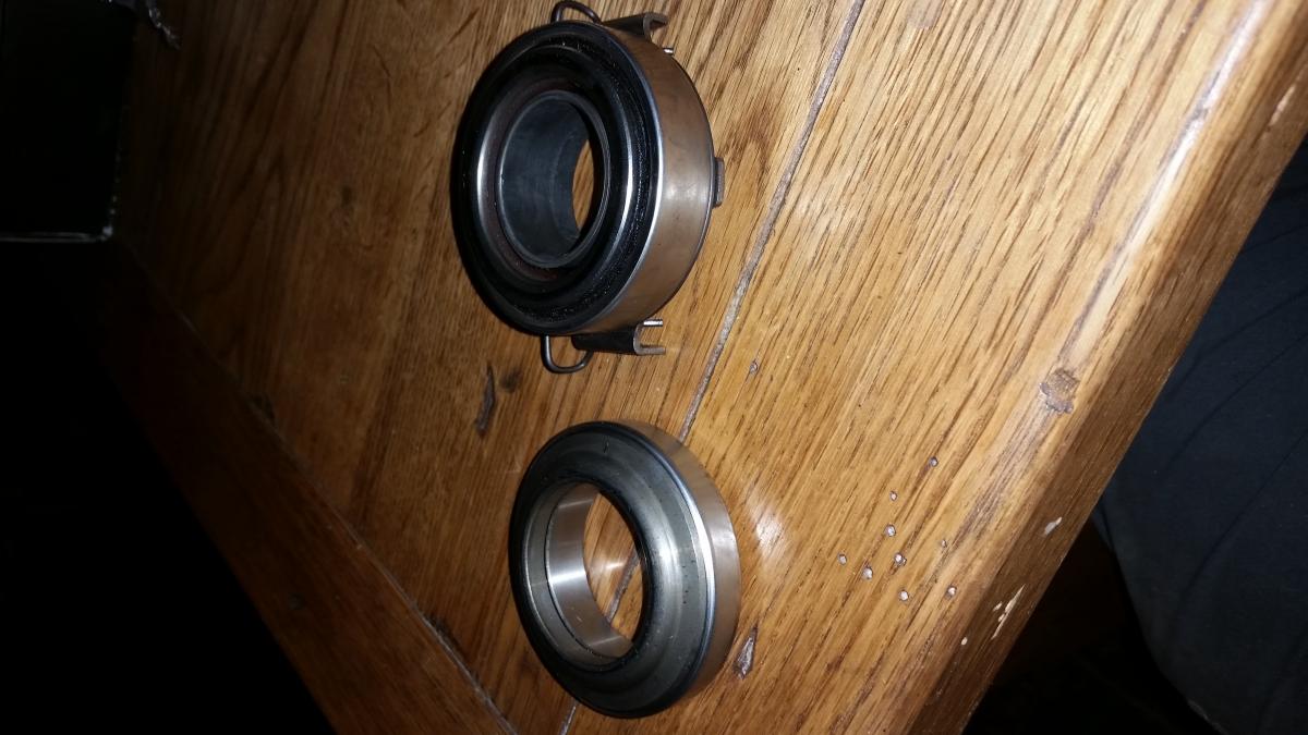

matthews512 Posted October 15, 2015 Posted October 15, 2015 Hi guys just wondering whilst I've still got the box apart if one of the guys using an org/blitz active clutch can comfirm this is the right release bearing for it ? as I've seen alot of different types now and dont fancy stripping the thing down again and also is it as simple as removing the old bearing and pressing the new one onto the existing sleeve ? Thanks Tom Quote

Broony Posted October 16, 2015 Posted October 16, 2015 (edited) That is what you need fella They come pre assembled? Edited October 16, 2015 by Broony Quote
Bluebear Posted October 17, 2015 Posted October 17, 2015 I can confirm that you should have a bearing like Broony's. Both bearings I had for both my ORC kits looked like that, despite the size difference between them. Quote
matthews512 Posted October 17, 2015 Author Posted October 17, 2015 That is what you need fella They come pre assembled? Quote
matthews512 Posted October 17, 2015 Author Posted October 17, 2015 No wasnt pre assembled couldnt find any that were an i looked everywere! it looks like I've got to take the bearing off the carrier and press the new one onto it! Cheers for the help tho bud couldnt find a picture of ona anywere aha Quote
Broony Posted October 17, 2015 Posted October 17, 2015 They come from orc/ blitz pre pressed, just hope it works for you pal. you can buy them new from RHDJapan Quote
matthews512 Posted October 17, 2015 Author Posted October 17, 2015 They come from orc/ blitz pre pressed, just hope it works for you pal. you can buy them new from RHDJapan Quote
matthews512 Posted October 17, 2015 Author Posted October 17, 2015 That was the bearing from RHD japan but there was no luck with it ill have to try and sort something in the week now 😕 Quote
Bluebear Posted October 17, 2015 Posted October 17, 2015 Did you buy the bearing on its own? There should be a bearing and sleeve set, that's what you needed EDIT: This: http://www.rhdjapan.com/orc-release-sleeve-bearing-set.html Quote
dj-rix Posted October 18, 2015 Posted October 18, 2015 you have the correct bearing, just needs to be pressed onto your existing Orc sleeve, 5min job with a bearing press Quote
Broony Posted October 18, 2015 Posted October 18, 2015 he doesnt have an orc sleevehe has a standard bearing/sleeve Quote
