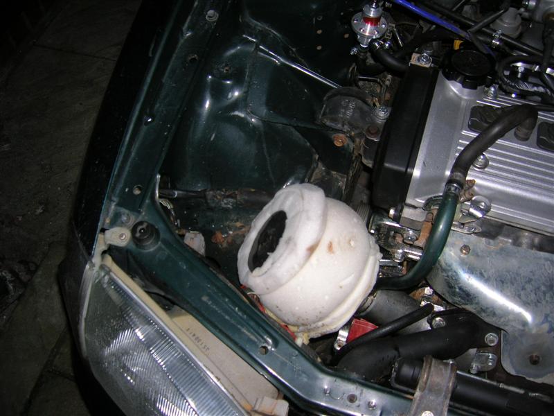

WallaceGlanza Posted February 26, 2008 Posted February 26, 2008 indeedy, or thisfoam, i found this to be very effective at controlling creep, but it looked shite :lol:My attempt was even more ghetto...2 pairs of sport socks! Didn't really have much effect though.
