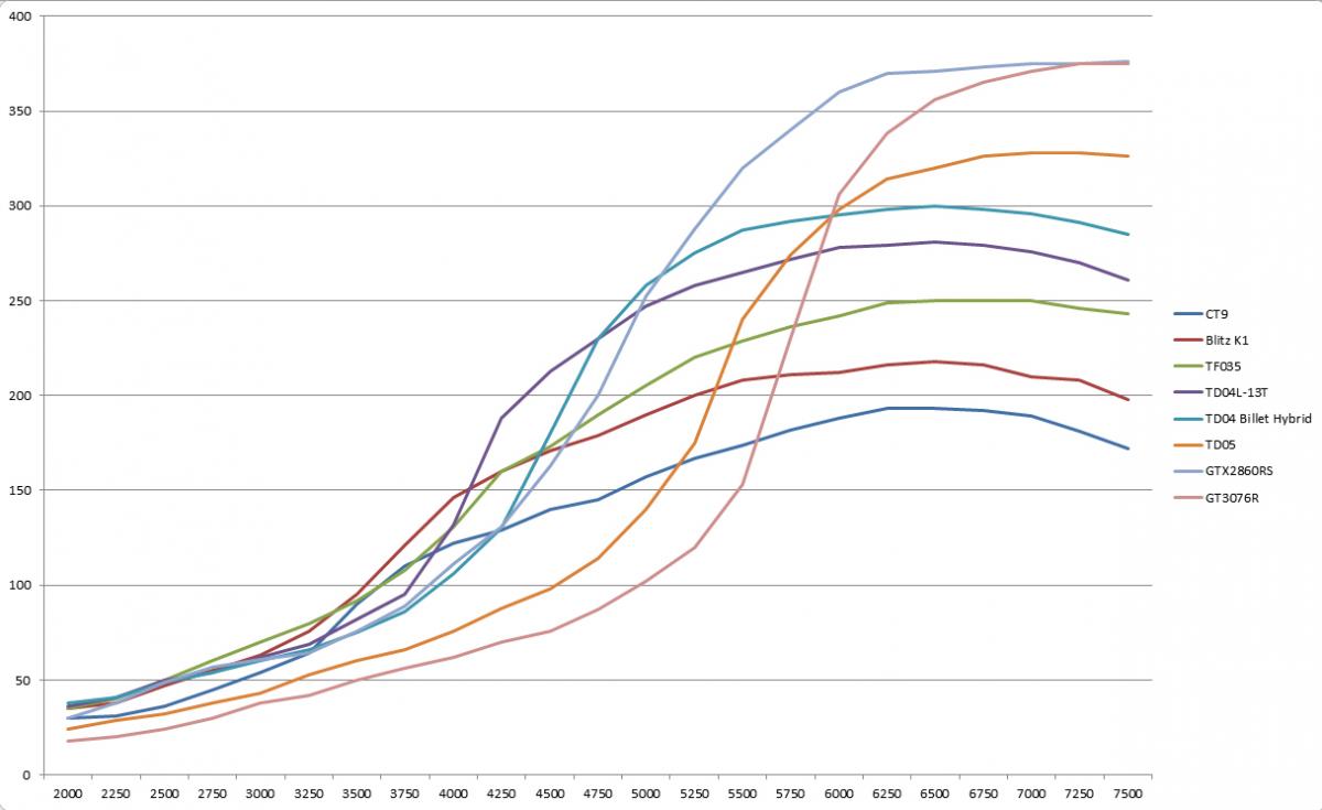

Something I forgot to share the other day... This seems like it gets asked daily these days! Using the leaderboard that you guys have kindly posted results too, we can paint a nice picture on turbocharger behaviour on a 4E-FTE. (All Pump Fuel) CT9, Blitz K1 & TF035 Results were Stock engine. Rest were Forged engines. The Blitz K1 (Gainzys Car). Really shows how impressive it is. Beating all the turbos mid range. We can also see, just why the TD04 is so popular! And w
