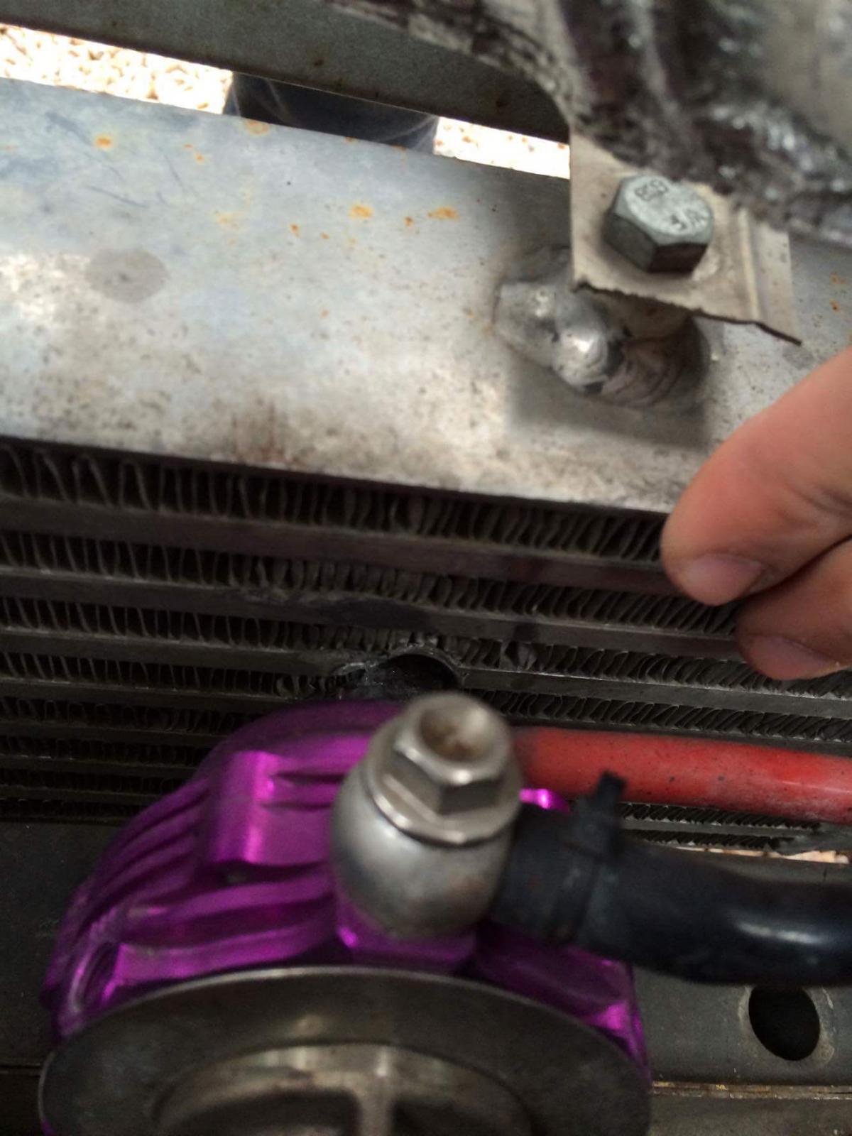

JarredsaintEP91 Posted March 13, 2016 Posted March 13, 2016 I need some help, went out in my glanza the other day and it suddenly stopped boosting, checked all boost pipes and they're all clean, but on my e manage blue there is a red light for intersector, any ideas? Quote
JarredsaintEP91 Posted March 14, 2016 Author Posted March 14, 2016 seized turbo ??? Not sure as the wastegate is still making a tiny flutter? My actuator is welded shut also so that may have snapped off inside? Quote
starletezy Posted March 14, 2016 Posted March 14, 2016 what turbo you running and have you checked the shaft on the turbo? Quote
JarredsaintEP91 Posted March 19, 2016 Author Posted March 19, 2016 what turbo you running and have you checked the shaft on the turbo? shaft is all good and im running td04 mate Quote
5e colin Posted March 20, 2016 Posted March 20, 2016 what a very stupid place to have the waste gate sure the owner must of heard that high pitch wissle sound of the leak Quote
JarredsaintEP91 Posted March 20, 2016 Author Posted March 20, 2016 what a very stupid place to have the waste gate sure the owner must of heard that high pitch wissle sound of the leak I bought it with the wepr manifold and screamer pipe like this, also a bracket from the intercooler had came off and started digging into it :/ oh well new intercooler for me! Quote
