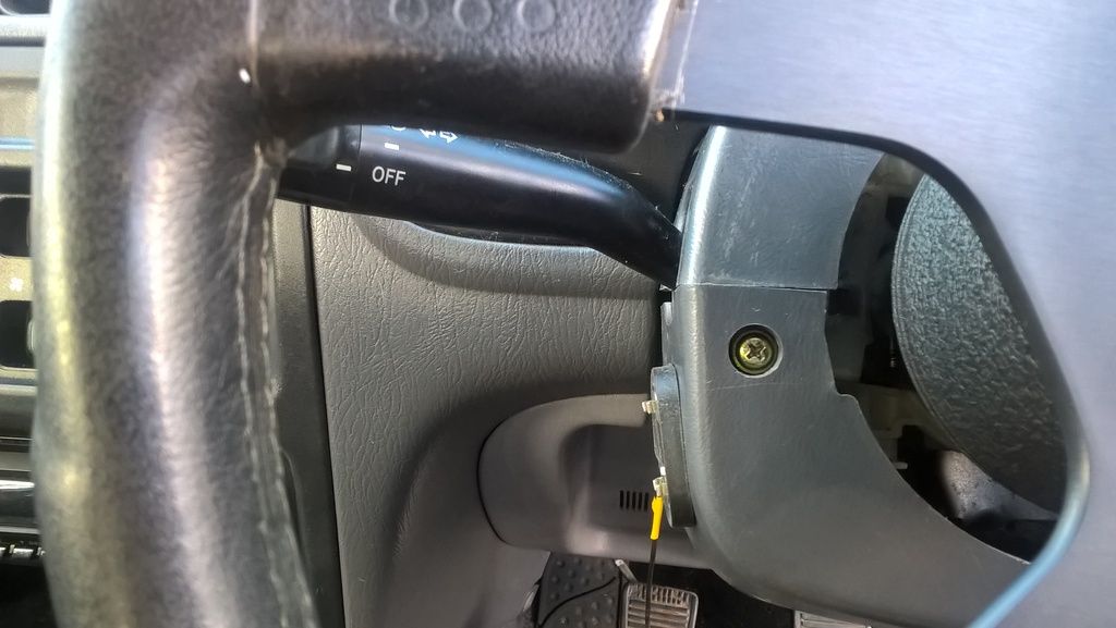

SKINY Posted March 30, 2016 Posted March 30, 2016 So I'm baffled by this, it just doesn't line up with the barrel at all there are a few clips missing but it will close properly when I provoke it. There is a pop in clip at the top and it's well out, the 2 screws holding it at the front I can get in but why no ignition line up ??? I've had it apart, steering lock off and still can't figure it out fsI have had to remove the indicator cancel or to fit my non-airbag TRD wheel Quote
Aamir Posted March 30, 2016 Posted March 30, 2016 That's the wrong steering column cover for your car, what year is your car? Aamir Quote
Aamir Posted March 30, 2016 Posted March 30, 2016 Looks like you've got a 96 spec steering column surround. You'll need a 98 spec one as the 96 doesn't fit. Aamir Quote
