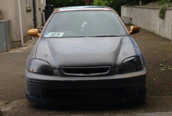

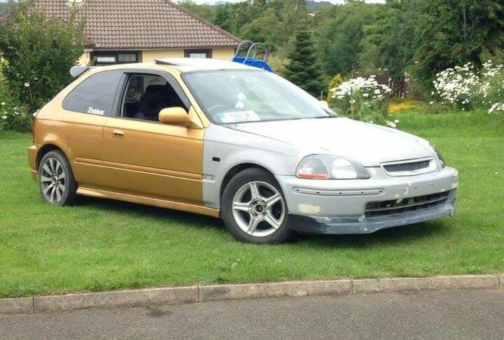

Thanks :) added some there now, that was late summer when it was all together only new exterior parts are new splitter and type r bumper

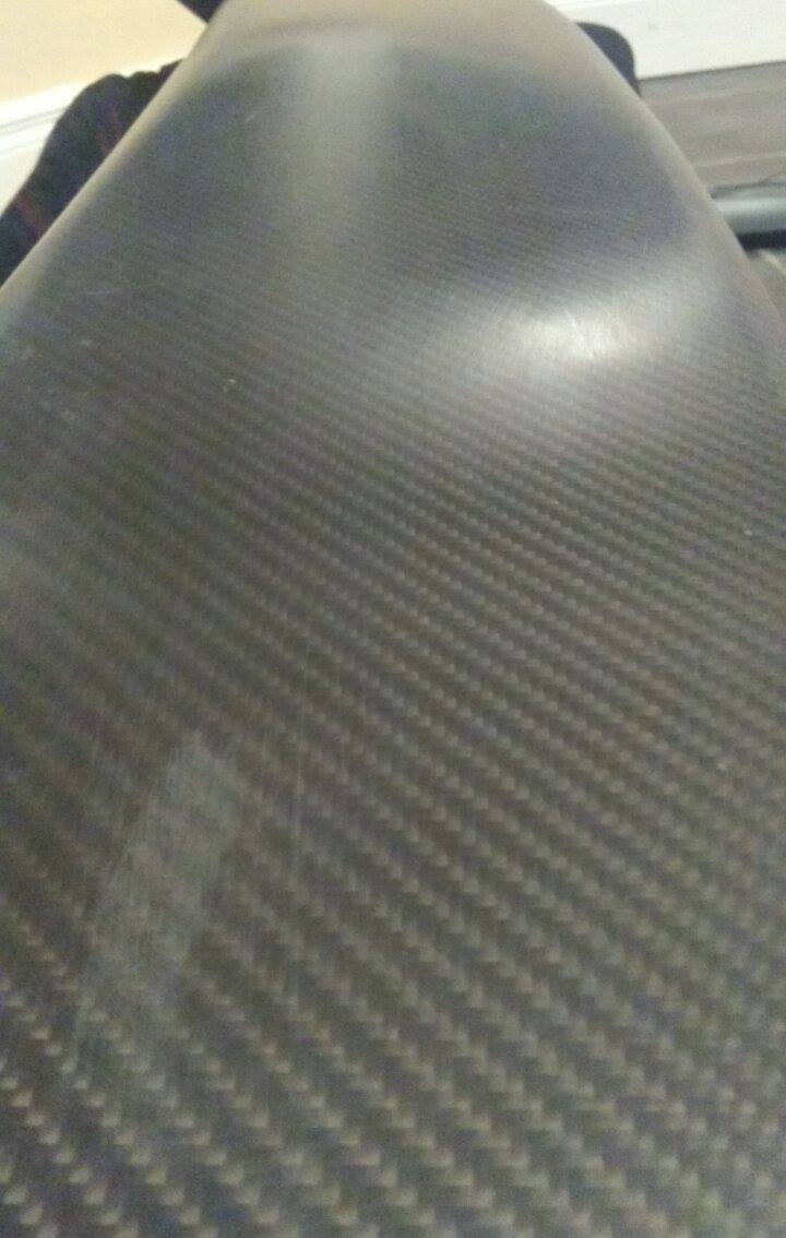

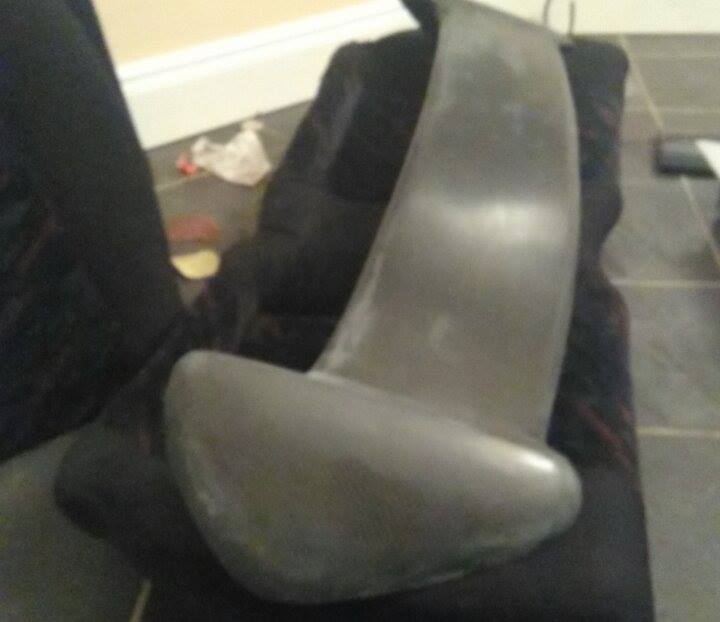

Firstly the spoiler, I bought this for €40 and it was painted in what looked like black hammerite and once I started sanding it I discovered carbon fibre :p, recently finished prepping it and the weave is not damaged at all so should come up like new when it is lacquered when the car goes for paint.
post-14534-0-25915700-1461011607_thumb.j

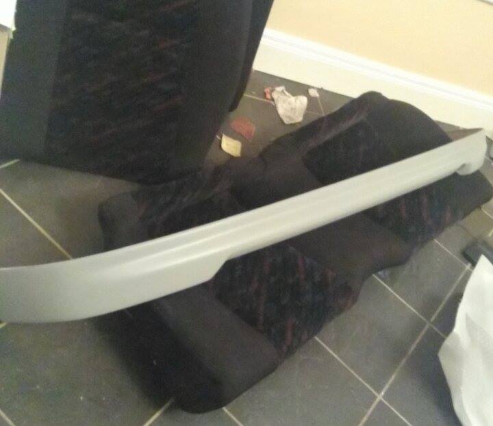

Also got the rear Type R splitter prepped

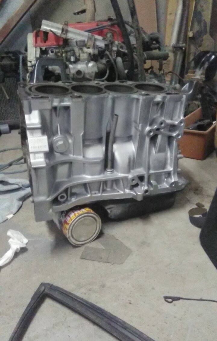

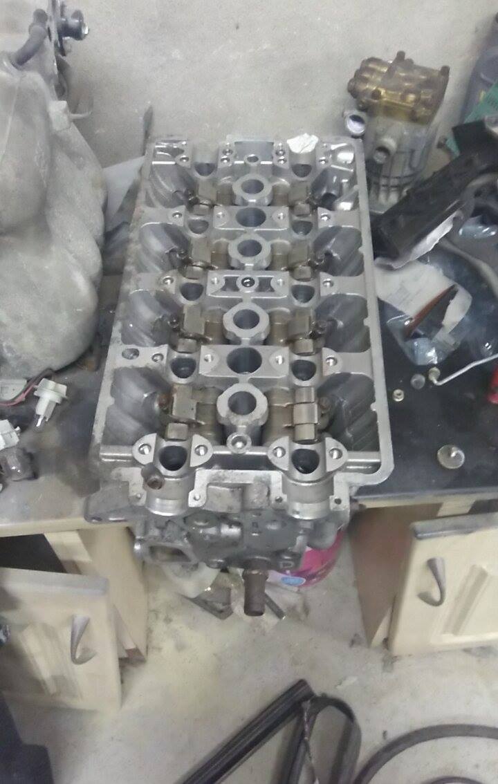

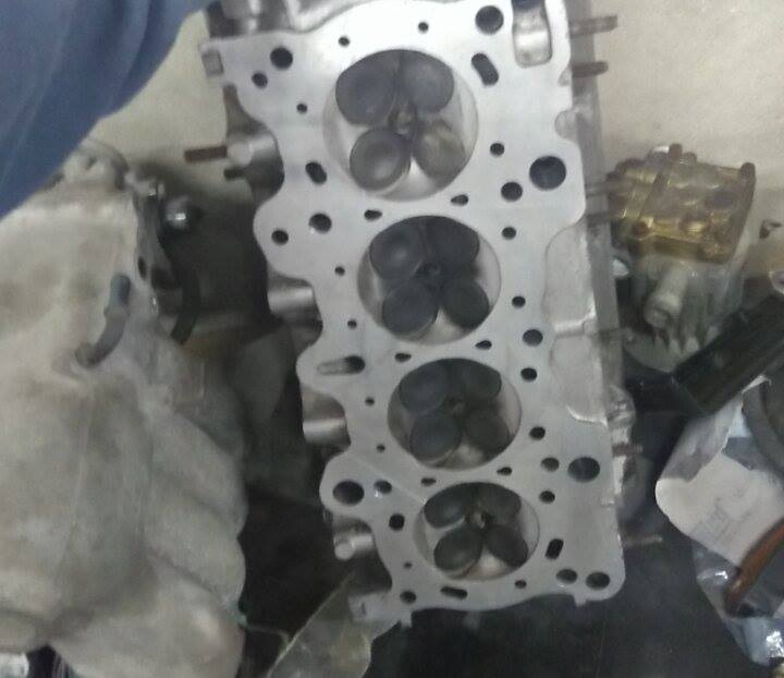

The engine got some attention next, painted the block silver and the head was skimmed and pressure tested

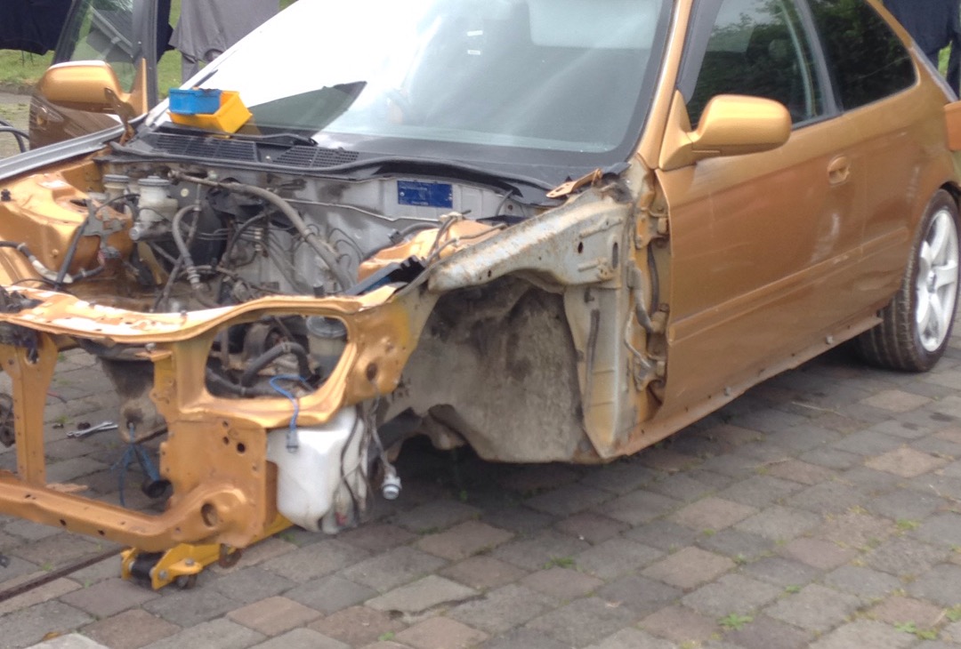

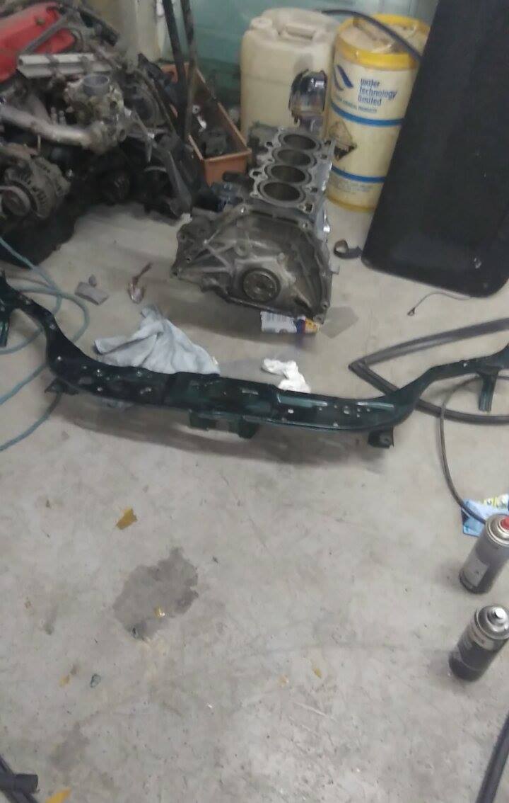

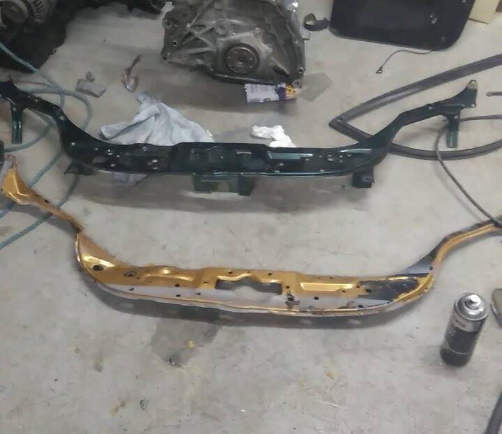

Then came the most serious part of body work, the front rad support was bent and it caused the front panels and lights to not line up correctly so I bought another from a breakers yard, hopefully should get it welded in this weekend
post-14534-0-09745500-1461011993_thumb.j

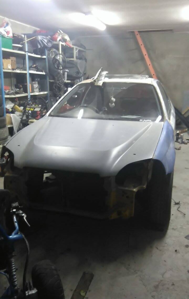

And here it is today, looks very tatty but have a lot of prep time planned for the weekend
