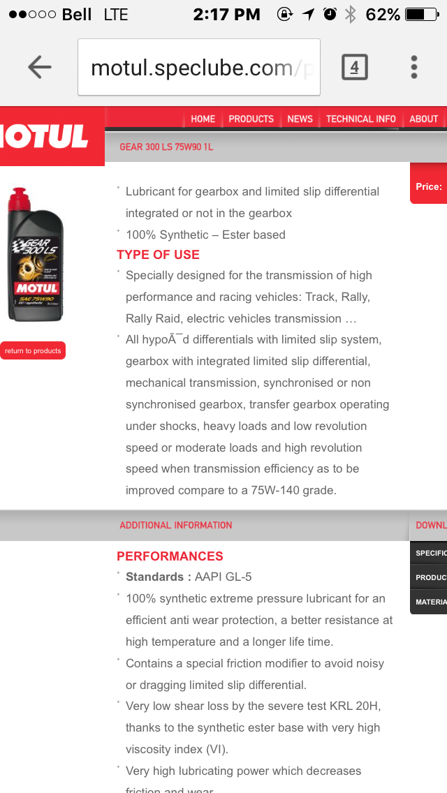

Haha will give that a go
this i believe :p:p:p
