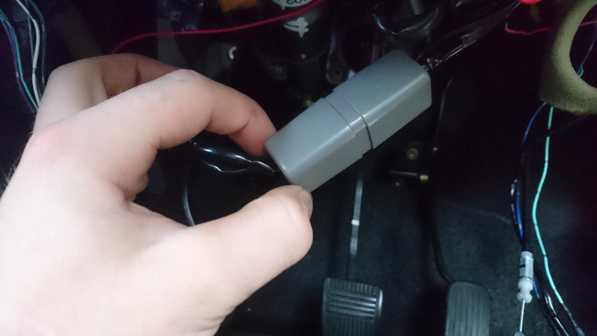

Okay, so you got your footwell and/or ignition lights, take a look at what you got exactly, you must have a small grey or black control box within the wiring
This box is what controls the dimming effect when the door closes. Without this box, well, I only hope you didn't pay very much for it otherwise you've been mugged off

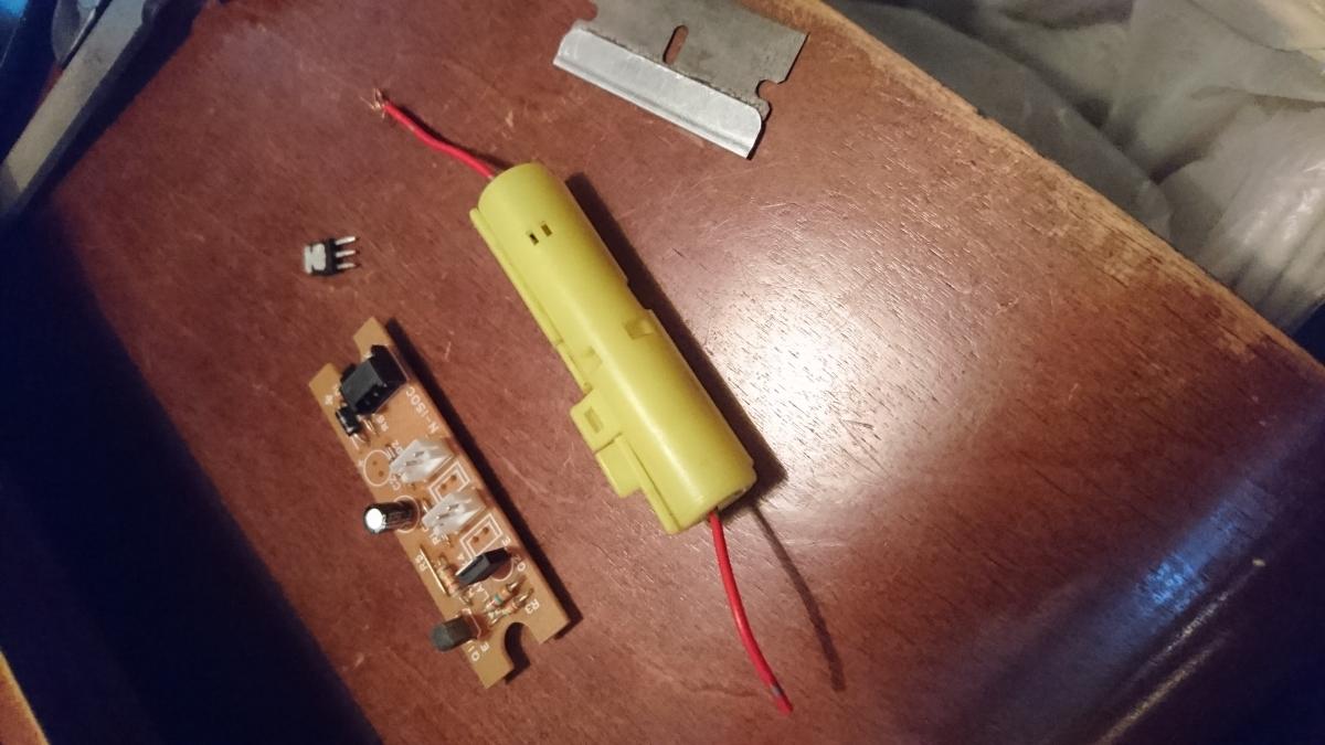

You should also have a yellow tubular case with a 1A glass fuse inside, attached to the red wire (pictured below), if this has been cut off also then you will need to add one later

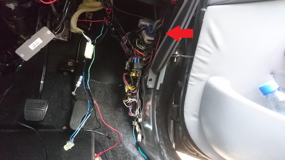

If for some reason you wish to connect it up behind the kick panel, then the only wire that I remember off the top of my head being a permanent 12v that you can tap into is within these bunch of connectors.
You will have to remove the lower part of the dash and remove the ventilation duct to access them
post-9573-0-62434600-1467918431_thumb.jp
Among them is a blue connector and on it is a blue/yellow wire (At least on the N/A, may be different on Glanza & GT). This wire goes to your interior light and is permanently live.
You will need to tap the red wire into the blue/yellow wire either by soldering or crimping 🤮 (whichever is your preferred preference), I would also highly recommend adding an inline 1 or 2 amp fuse at this point if the original one was cut from the wiring. This is because the circuit board that controls the dimming is very sensitive in the event of a short or power surge
However, as I mentioned above, tapping into the 'DOME' fuse wiring will probably be the easier option, but you should still add a 1 or 2 amp inline fuse if the original was cut off

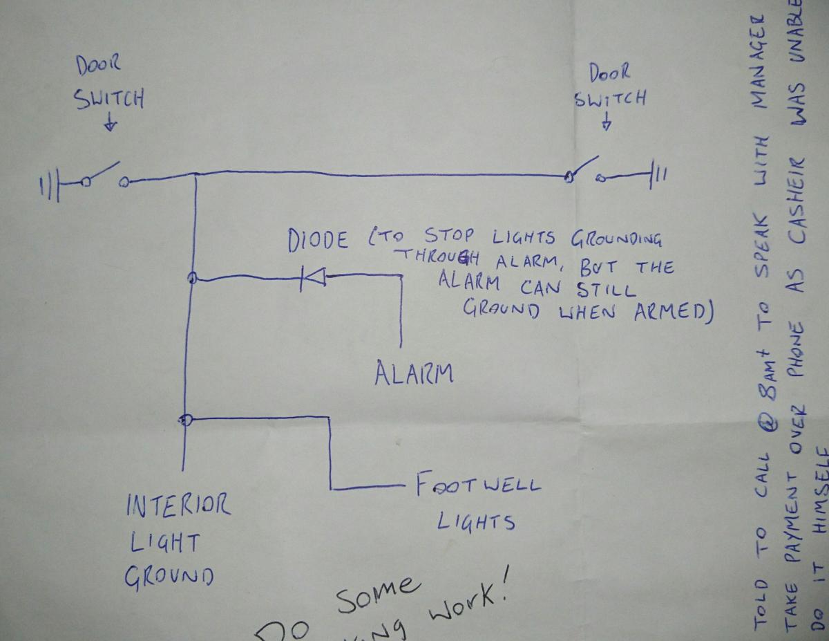

-Do you have a aftermarket alarm? Some aftermarket alarms such as Cobra (not sure about factory alarm), the way they work can be a little strange. The wire from the alarm that attaches to the door switches, to detect when the door opens, can actually act as an earth causing the lights to stay on, but dont worry, you dont need to remove your alarm!! This is a very simple fix.
Go buy yourself a '1N4004' diode, and install it to the alarm wire (*with the band facing away from the alarm) so that the alarm can still operate and sound the alarm when the door opens, but stops the lights earthing out through the alarm. See diagram below
If you dont know how a diode works, it basically only allows current to flow in one direction only
post-9573-0-94651700-1467919575_thumb.jp
-If you dont have an alarm then you may have some other aftermarket device within the wiring that is acting as an earth, it might not be 'leaking' enough to light up the interior light fully, but enough to make the footwell lights think the door is open, this is probably something for the more experienced to trace

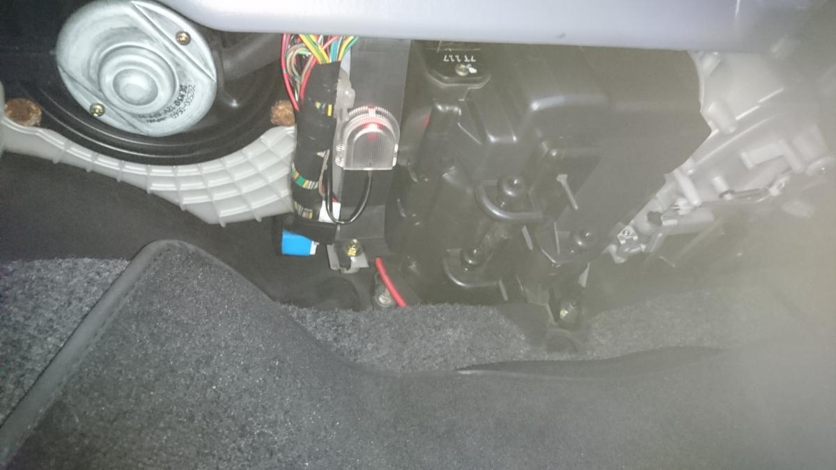

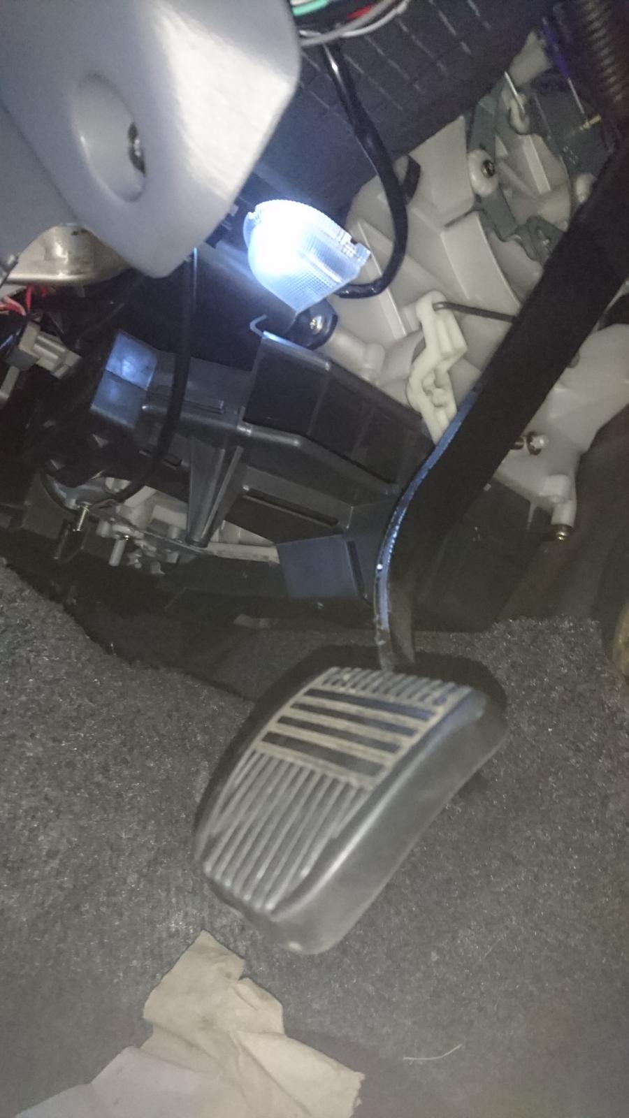

There actually isn't anywhere specific to mount the lights, at least not on the N/A, its more of a trial and error and just seeing what works for you, just get yourself some double sided tape and get sticking! Below I have taken some pictures to give you an idea as to how I have mounted them:
- Driver side
post-9573-0-70206000-1467918800_thumb.jp
- Passenger side
post-9573-0-83022000-1467918869_thumb.jp

Woah! Hold on a minute there buckaroo! Youve gone to all this effort to fit these damn things, lets not fuck things up now! Reason I say this is because the bulb holders (particularly for the footwell lights) are designed differently compared to any others like the ones behind your heater controls on the dash for example.
You can't just put any style of LED in there as you can/will actually short it out and damage the circuit board, and you will have completely wasted your time fitting them. In particular it will damage one of the transistors on the board (I'm speaking from experience here!) which are hard to find because they are no longer made and therefore expensive to replace, and you'll need to do some soldering
Plus most LEDs won't sit at the correct angle to disperse enough light anyway (facing to the sides rather than down), so it will actually be less bright than a normal bulb, so maybe think twice before fitting LEDs! It may be better to just leave them alone and use normal bulbs
If you really really really must have LED's then the only way you're going to make them work is by making sure the LED's you intend to use have ONE pin on each side of the bulb, not 2! Otherwise it will short out and fuck the transistor on the board I mentioned above!
