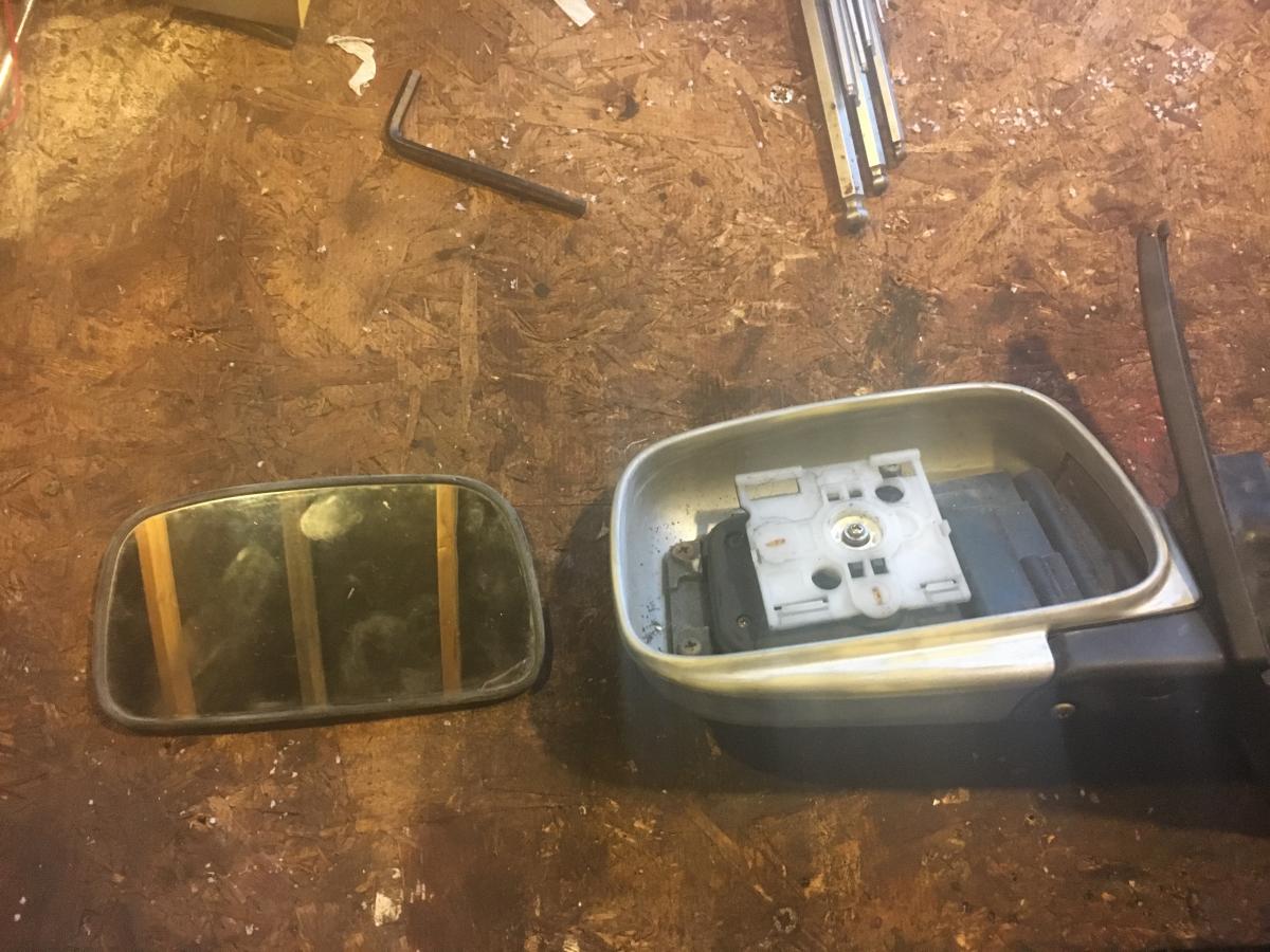

SpikeyJp_68 Posted July 9, 2016 Posted July 9, 2016 I'm wanting to remove the glass from my electric mirror as I'll be painting them. I've pulled at it relitivley hard thinking it would pop off but no joy. How do I get this to come off ? Also looking for drivers side glass as I've lost mine..Thanks in advance Quote
morgey Posted July 9, 2016 Posted July 9, 2016 Pull the glass from the bottom. That releases it from its clips then slide the glass down to get it out from the top retainers Quote

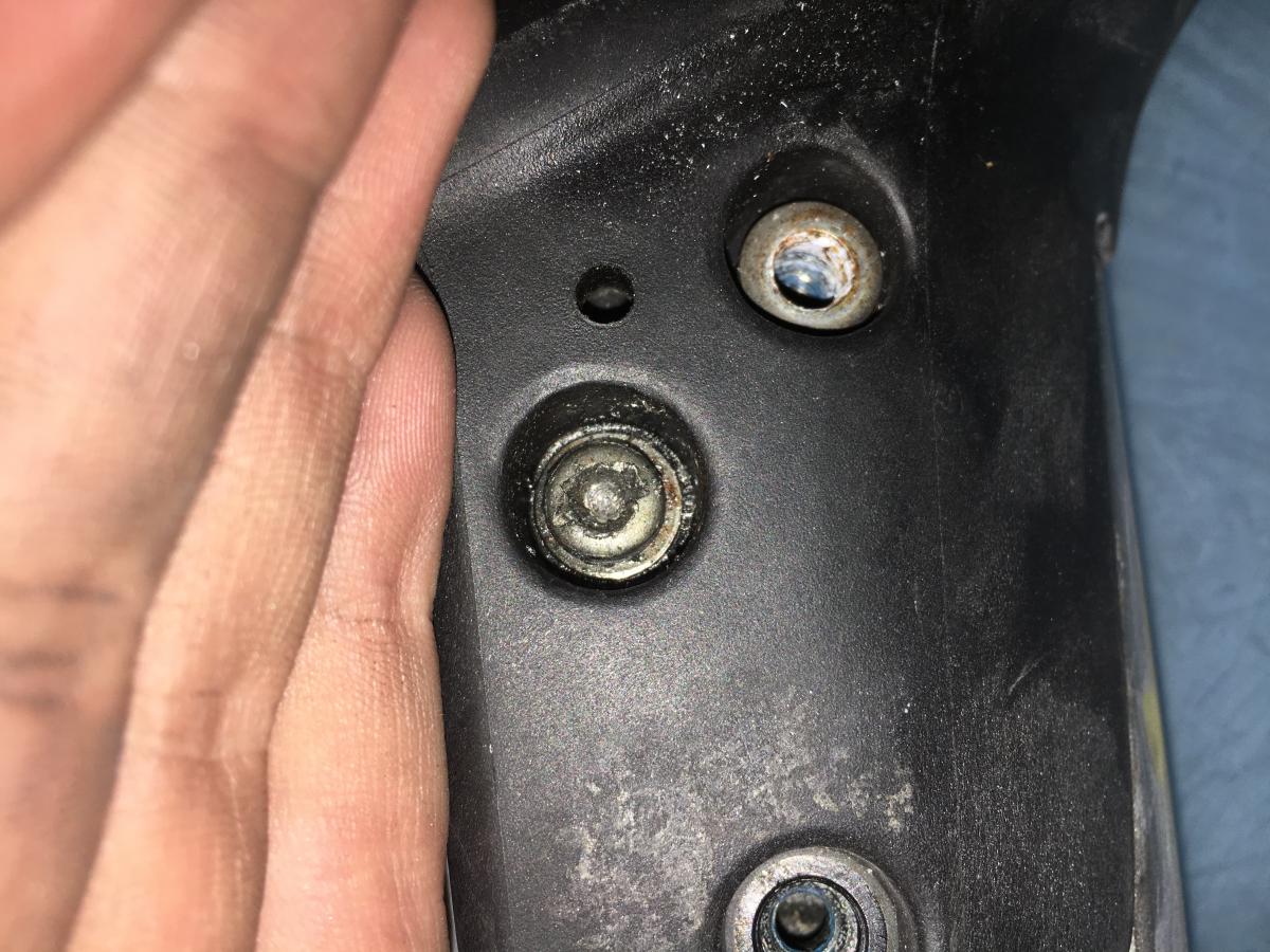

SpikeyJp_68 Posted July 9, 2016 Author Posted July 9, 2016 Top man morgey Next problem is I've ended up rounding one of the three screws holding the black bit to the actual mirror, other 2 had loads of thread lock on. Any tips on getting this out ? It's pretty butchered.. Quote

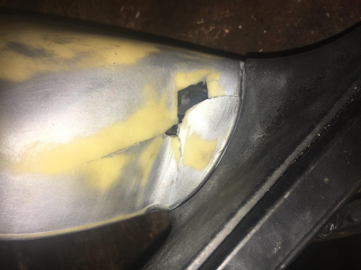

SpikeyJp_68 Posted July 9, 2016 Author Posted July 9, 2016 (edited) Might just get a whole new unit as this is why I wanted to dis-assemble it. Wouldn't want it to break after paint. Big chunk taken out of it and another piece barely hanging on Edited July 9, 2016 by SpikeyJp_68 Quote
