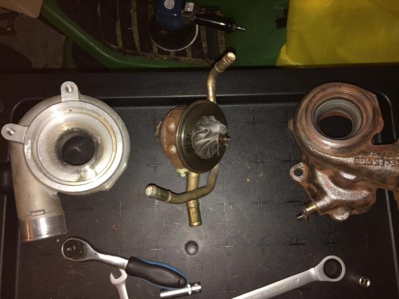

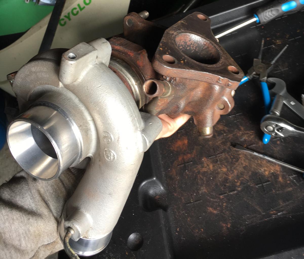

SpikeyJp_68 Posted September 9, 2016 Posted September 9, 2016 Hi guys,I've gotten round to rotating my TF series turbo and just wondered if both housings have to be rotated so the oil feed is at 12 o'clock and the drain is at 6 o'clock or does just the compressor housing need rotating ? Thanks in advance Quote
5e colin Posted September 9, 2016 Posted September 9, 2016 (edited) ya oil feed down and compressor housing outlet down to and tutbine to manifold flange strait up remove the location pin on the housing now its apart can you measure the compressor wheel and inducer so i can update the tfo thread ?? cheeeers Edited September 9, 2016 by 5e colin Quote
SpikeyJp_68 Posted September 9, 2016 Author Posted September 9, 2016 (edited) ya oil feed down and compressor housing outlet down to and tutbine to manifold flange strait up remove the location pin on the housing now its apart can you measure the compressor wheel and inducer so i can update the tfo thread ?? cheeeers So both to housings need the pins removing and rotatinghave put the pics in your thread Colin Edited September 9, 2016 by SpikeyJp_68 Quote
5e colin Posted September 9, 2016 Posted September 9, 2016 So both to housings need the pins removing and rotatinghave put the pics in your thread Colin yup and thanks for that amigo Quote

SpikeyJp_68 Posted September 10, 2016 Author Posted September 10, 2016 Never ever ever again do I want to see another circlip......Thanks again Colin Quote
5e colin Posted September 10, 2016 Posted September 10, 2016 (edited) ha ha there a fucki8ng cunt to do somethimes i usses c clamps to squash the torbo together makes fitting circlip easier and expecially if you fit a thicker rubber on the core to stop any leaks there !!! set you actu to 1.1bar if you have P&p Edited September 10, 2016 by 5e colin Quote
