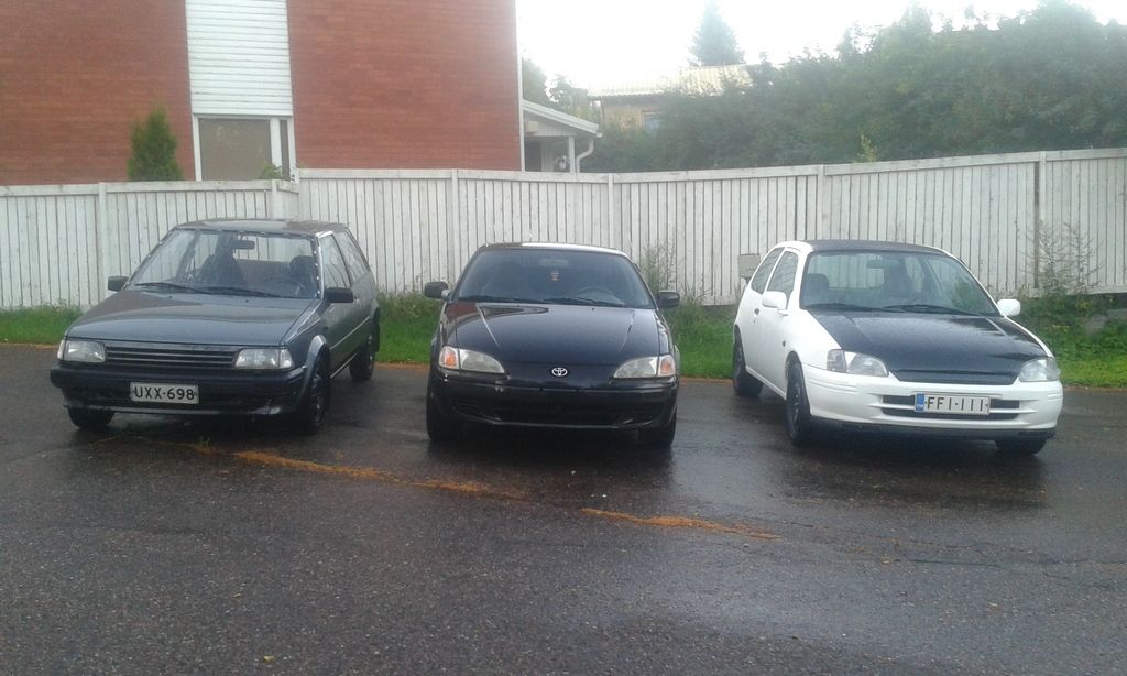

Fabrics can't be moved, too different seats. Maybe sitting part can use some how, but back is much narrowed and attacment on both side is very different. And backseats are for two person in Paseo by the way.
Carpets maybe, floor is same basically but maybe little bit longer than Starlet, front/rear axle measurement is longer what I compared side by side.
