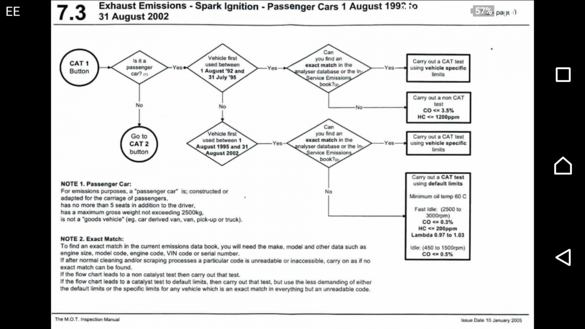

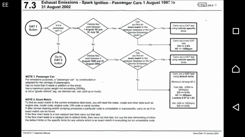

akyakapotter Posted September 20, 2016 Posted September 20, 2016 (edited) Take this to your tester he's tested it wrong Just seen its nct not mot not sure on your rules there Edited September 20, 2016 by akyakapotter Quote
