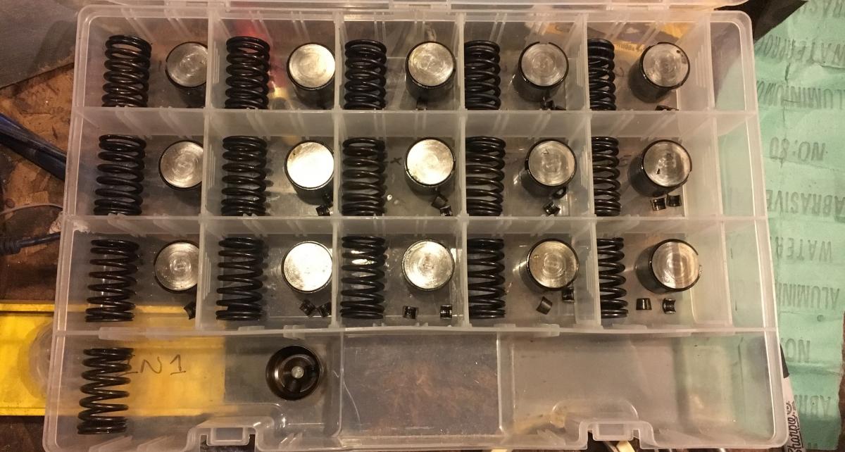

As for keeping everything together you'll need a box like this and label the different sections in1 in2 ex1,2 and so on
post-12017-0-65660800-1480895762_thumb.j
You'll also need a valve spring compressor to get the little collets out that keep the retainer in place.
