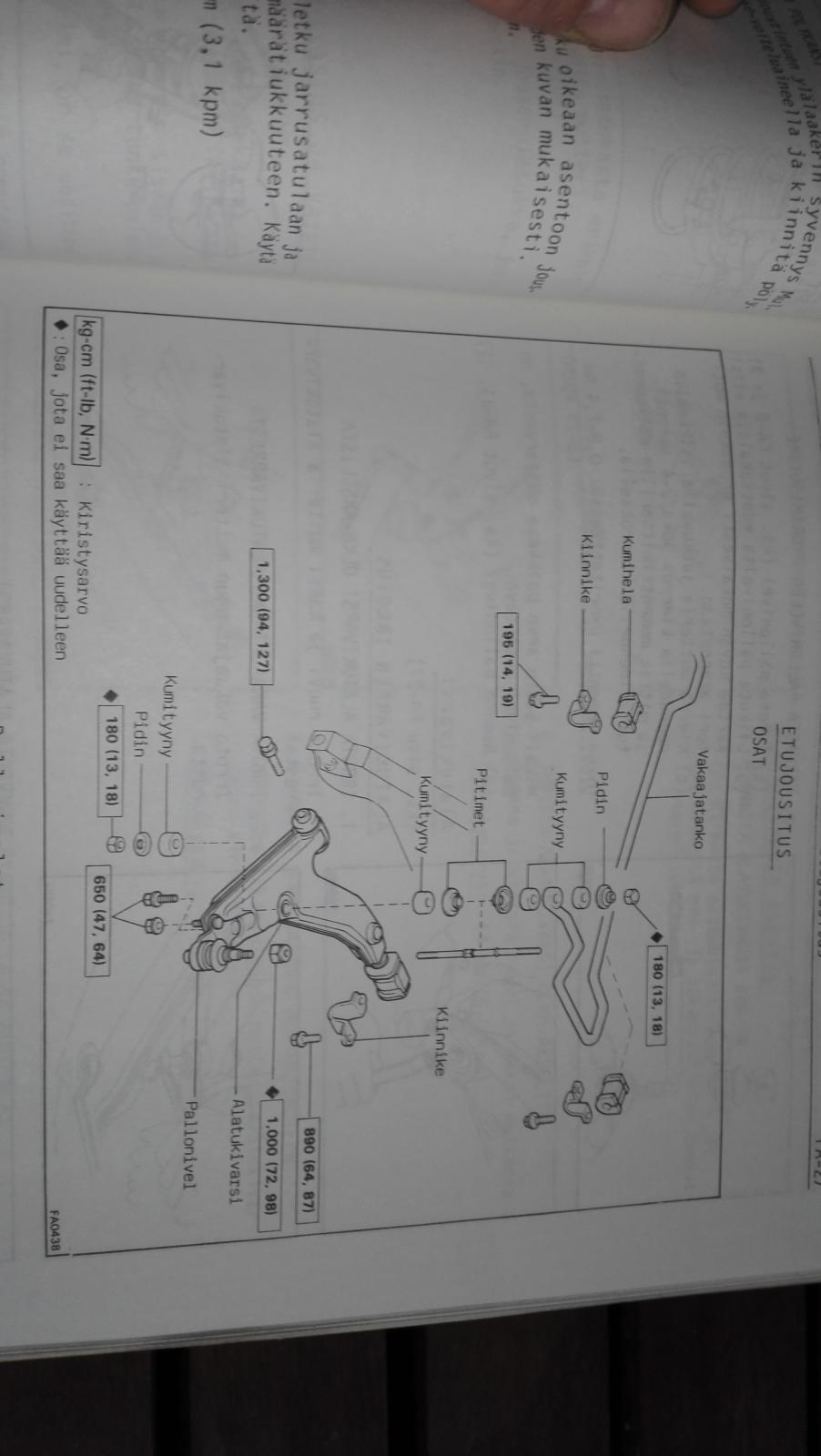

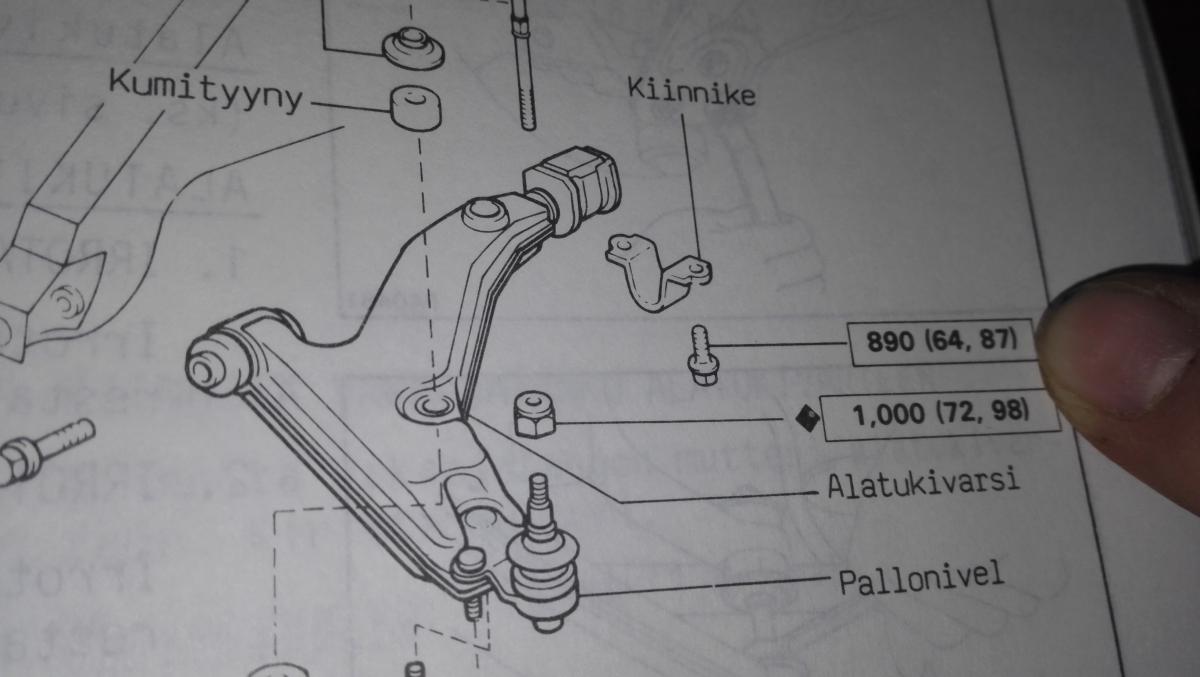

MR-2 Posted April 27, 2017 Posted April 27, 2017 I found my EP70 chassis manual 87Nm value for that bolt, should be almost same as newer model. Quote
StanMan Posted April 27, 2017 Author Posted April 27, 2017 I found my EP70 chassis manual 87Nm value for that bolt, should be almost same as newer model. Great, thanks for that. I did it to 80Nm in the end, so not far off. Quote
