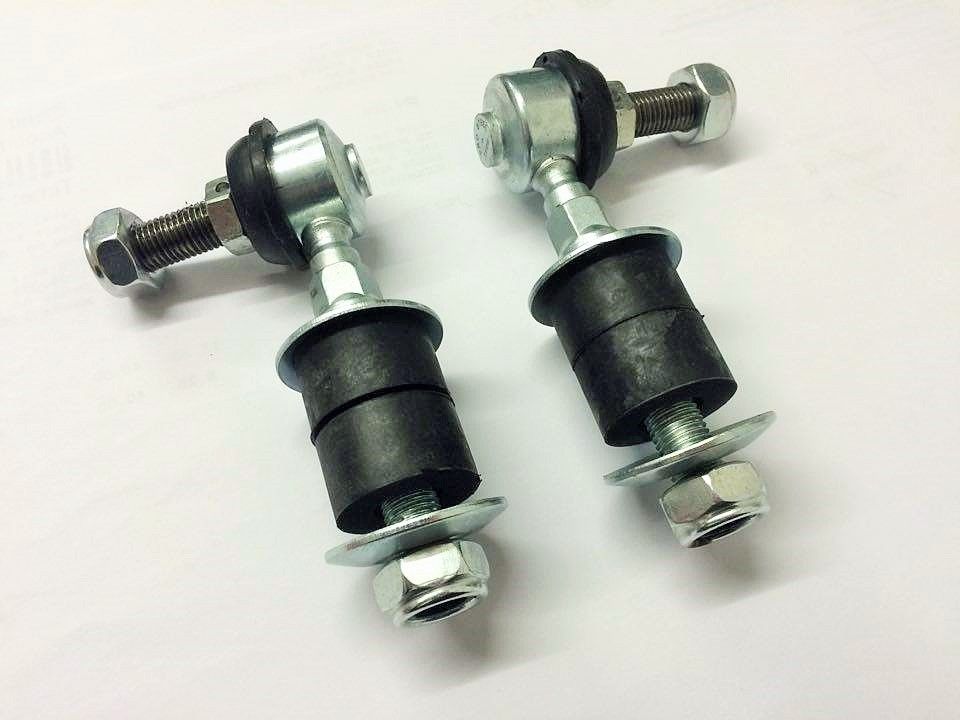

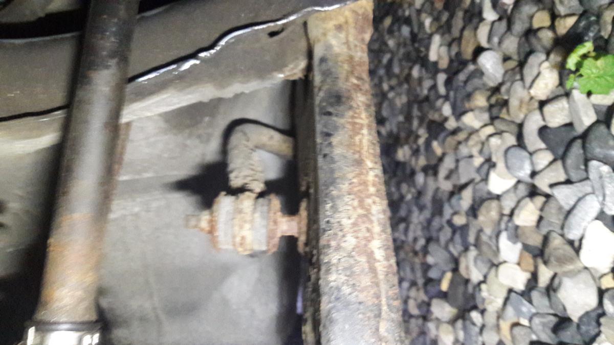

2) droplinks - at the moment i have the straight type drop link as shown below but when i was looking for replacements, i saw a right angled type drop link come up. Whats the difference and which will i need ? Using a glanza arb with the n/a wishbones
Mine currently:

Right angled ones (picture off internet):

3) pollybush drop links - of course i want the car to handle nicely and be flat around corners but will these shake the teeth out of my head ? Irish roads are far from smooth. I already have the 2 main arb pollybushes and a pollybush for the wishbones.

Pretty sure the na and turbo bars are different. I used slightlt modified saab 93 droplinks on mine as were dirt cheap. Polybushing the droplinks wont make much difference
