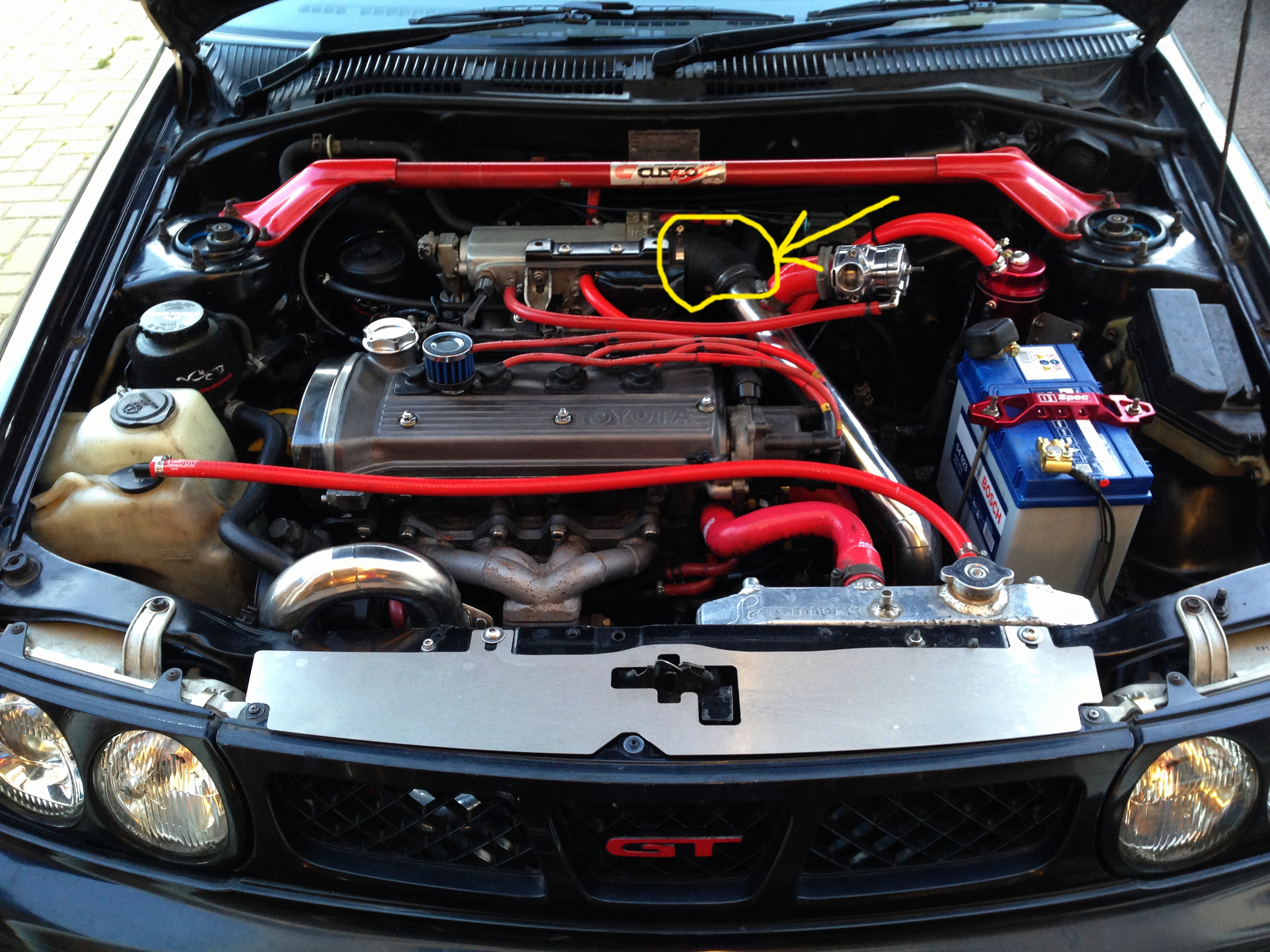

Can anyone tell me what the size is for the intake elbow from the intercooler pipe to the throttle body.
I've bought several but always get it wrong (spesh)
I think more importantly, does anyone know the angle that it's at. 45, 90 degrees?

the throttle plate is said to be 50mm, so i figure the TB outer diameter is around 52/55mm...whihc would indicate 2" at the TB end of the elbow and whatever size at the other end for the turbo piping  you use (2", 2.25", 2.5", etc)....you may need some kind of reducer sized silicone bend depending
http://www.tercelreference.com/tercel_info/component_library/engine_components.html#throttle%20bodies
the stock elbow looks like 60/45 degrees
may be better you take it off and measure up the TB and go use the elbow to match at the store
