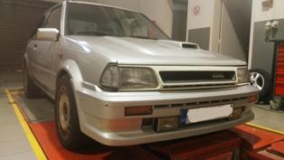

Ep71T Posted October 3, 2018 Posted October 3, 2018 Hello I am Eros from Athens Greece. Just bought a Ep71T . Its a little rough and needs some TLC. It came with the 2E-FTE . It looks like it has ep9# front steering knuckles . It has abs sensors ? And the stance is a lot wider in the front. Super excited with this project :) Quote

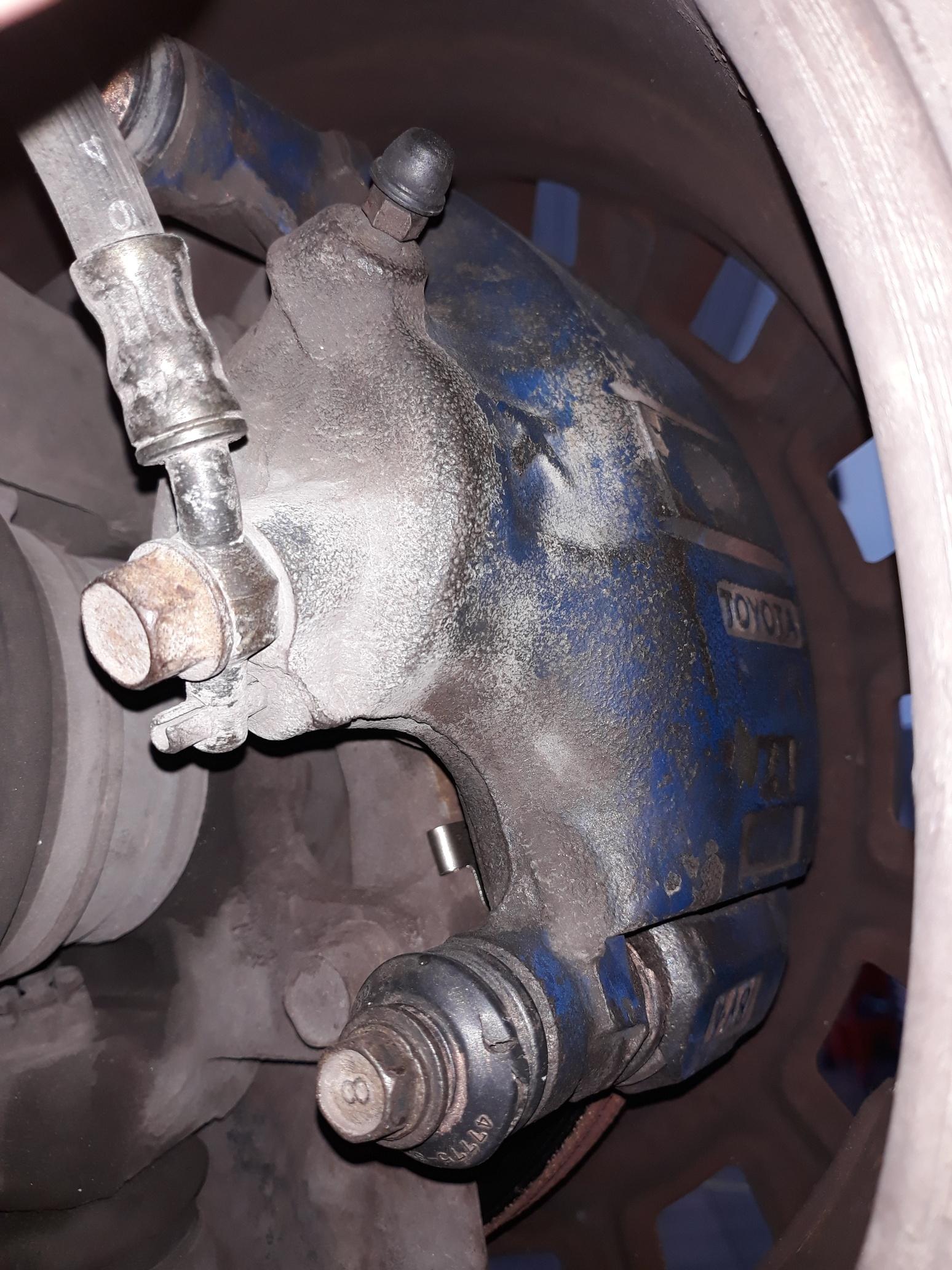

Ep71T Posted October 4, 2018 Author Posted October 4, 2018 Do you guys know what kind of brakes are those on the picture? Quote
mech5107 Posted October 16, 2018 Posted October 16, 2018 Hi... Also Greek, also ep71, also 2etelu. I live in UK though and my ep71 is in Greece. Take the wheel off and take a good photo of the caliper and the numbers cast on it. Could be ep82/91, ep71 turbo, gt/glanza Quote
Ep71T Posted November 10, 2018 Author Posted November 10, 2018 So the casting numbers from top are 18YA 51-18 Quote
mech5107 Posted November 10, 2018 Posted November 10, 2018 I think this is turbo brakes. If they measure 254-255mm and are around 18-17mm thick they are turbo brakes. Quote
