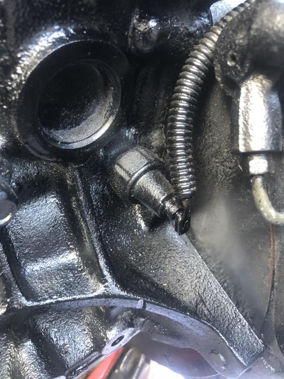

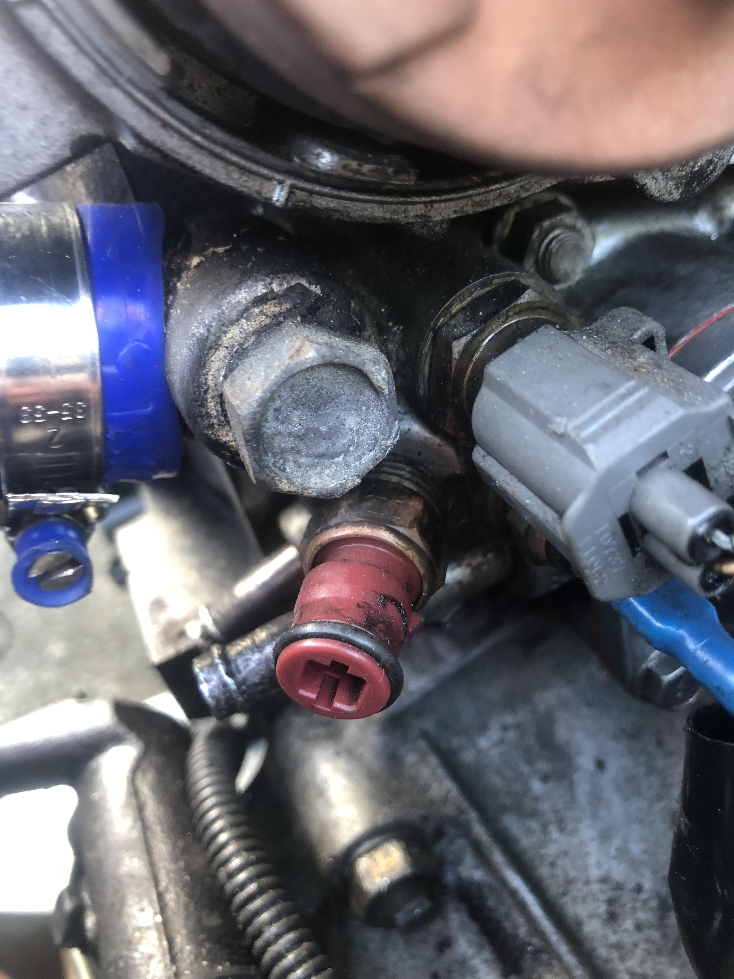

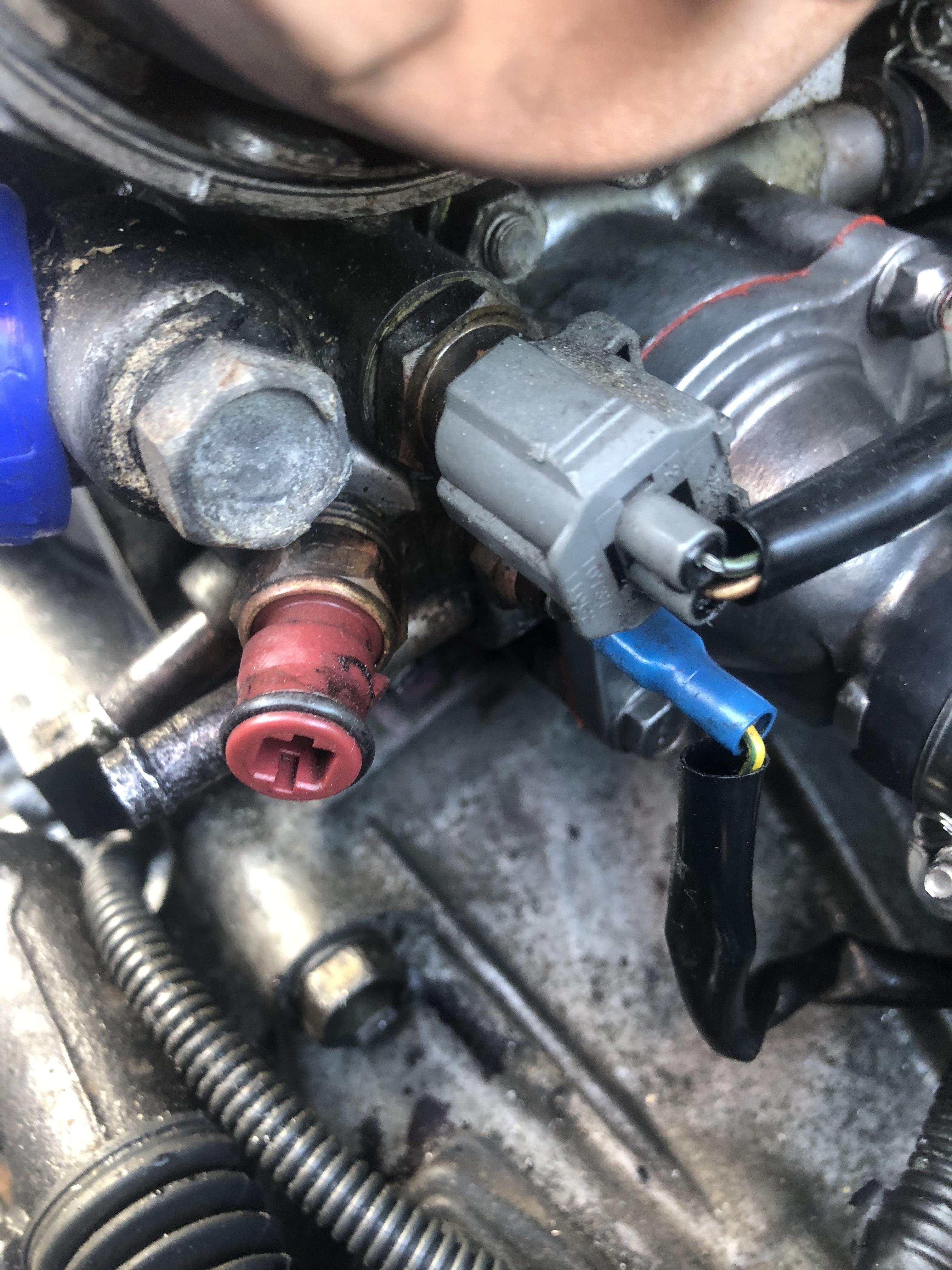

Tata2dpom Posted October 27, 2018 Posted October 27, 2018 Hey guys i have jap gt turbo with tdo4 set up but have been trying to identify these senders so i can run gauges im thinking water temp maybe fan and air con ? The red one with the oring is puzzling me Cheers for any help scott Quote
T-dog Posted October 27, 2018 Posted October 27, 2018 Top photo is oil pressure . The second photo grey plug water temp sensor to ecu and the spade underneath is for the water temp gauge and the red one looks like some aftermarket sender fitting for a water temp gauge . Hope this helps Quote
