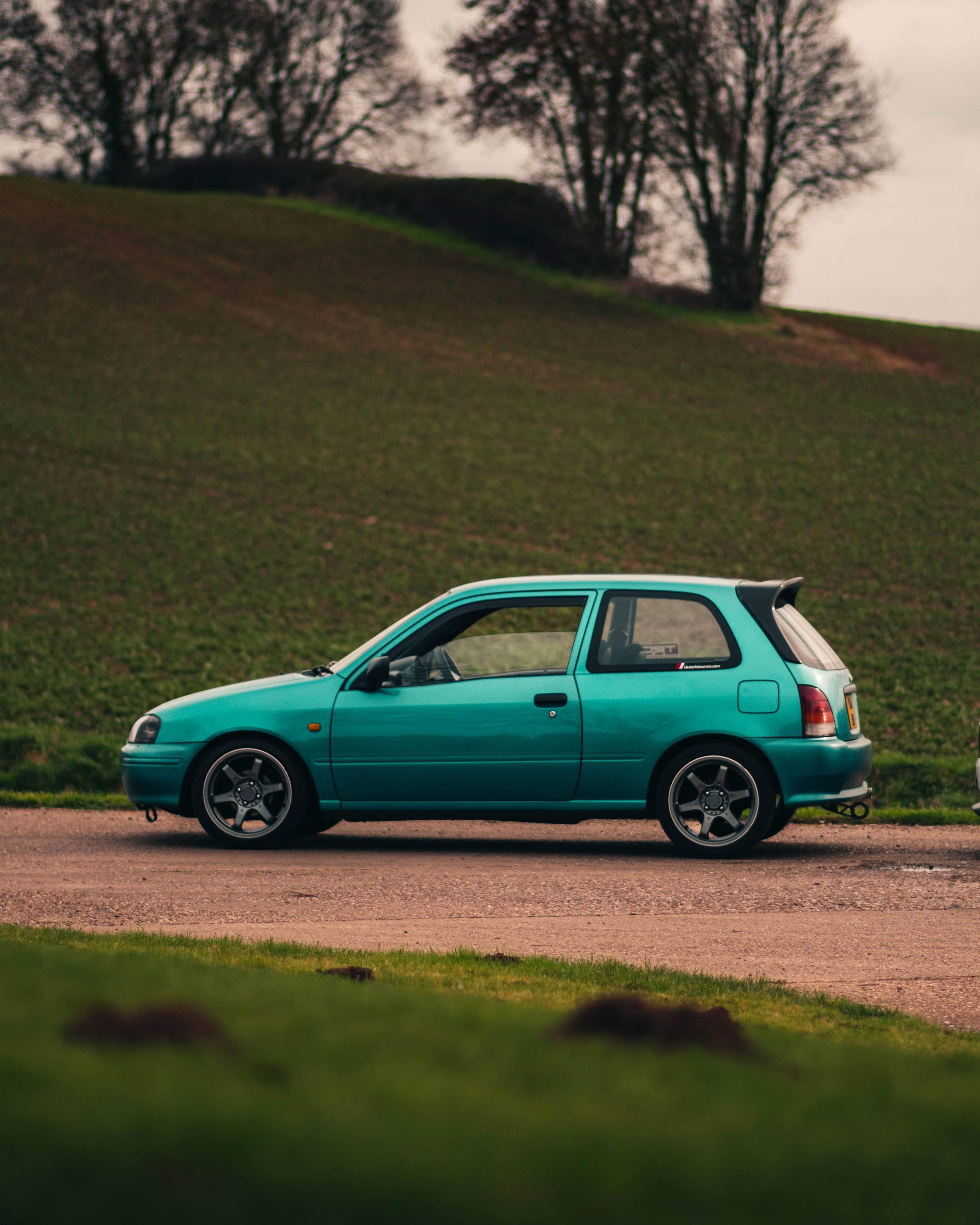

On my Rep I fitted a corolla manifold and throttle body, air filter and 2" straight through exhaust with a small scorpion back box, on the Dyno it made 86.6HP compared to 74 standard :) 30/40 £ should get you the manifold and throttle body

Lovely car Andy v nice colour. When I put the corolla inlet on it made a noticeable difference which I wasn’t expecting. Basically with what skiny said- you could put management on but it’s a lot of money and would probably only see you nudge towards the 100 barrier. They’re pretty limited unfortunately.
Did you have the exhaust manifold done?

Yea I was happy with it lol, standard exhaust manifold bud, folk kept telling me to use the starlet throttle body but it's a bit smaller and not the correct one for the corrolla Mani lol. There was a few heated debates about it but I never listen and the results speak for themselves :)
