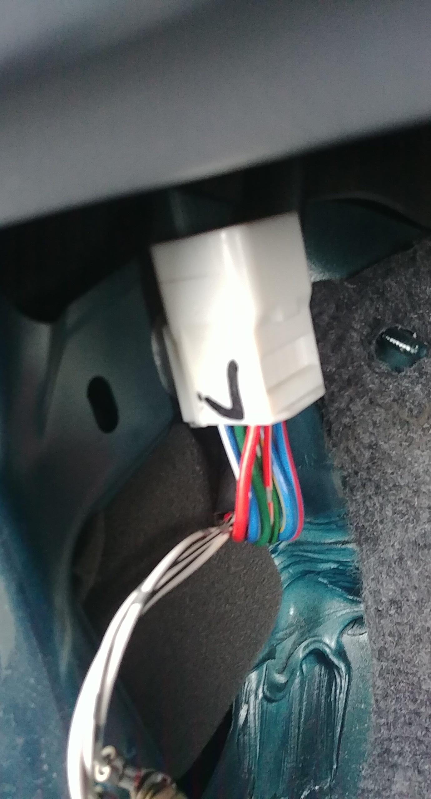

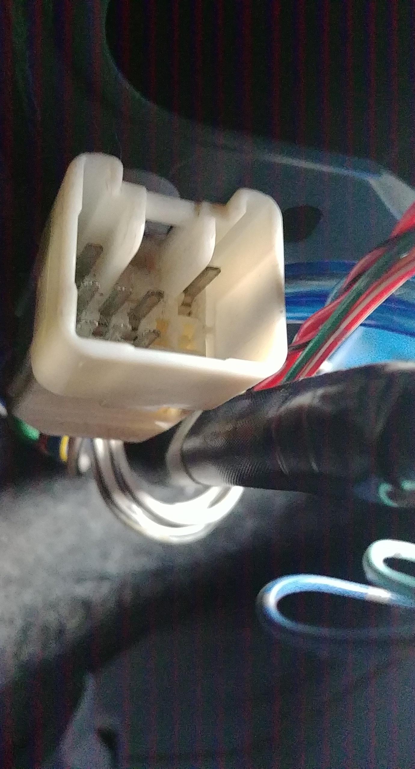

Fleminglad Posted May 18, 2019 Author Posted May 18, 2019 (edited) Did what you said and came across these Are just the connections? As i was looking i couldnt see a spot where the loom could get in to the car and im not fond of drilling holes any suggestions Edited May 18, 2019 by Fleminglad Quote
morgey Posted May 18, 2019 Posted May 18, 2019 They look like them, there might be a control box and a relay need too, that go under the dash but im not sure where, someone breaking a car might be able to advise. as for the hole is there not a rubber bung behind the door shuts? Quote
