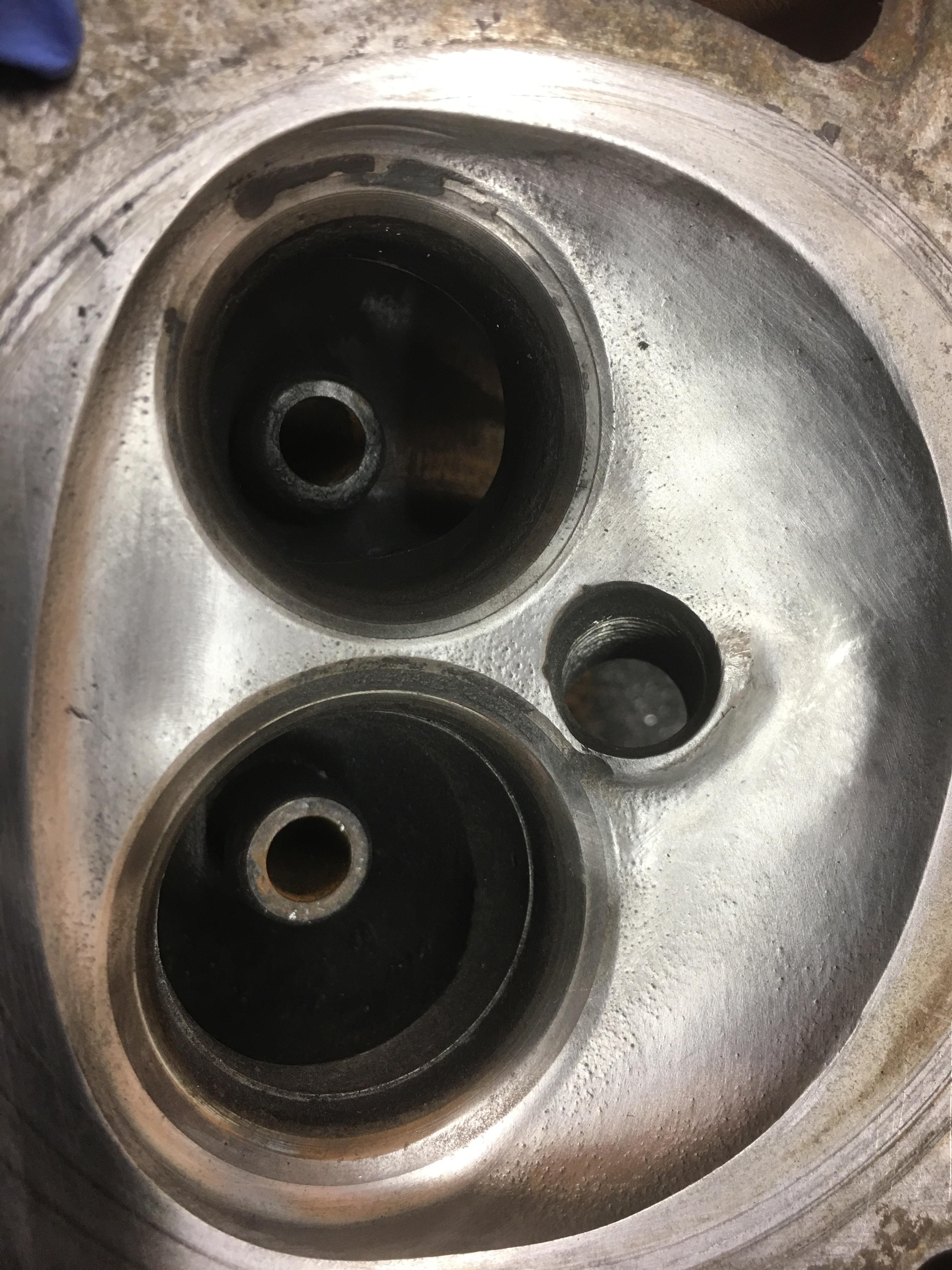

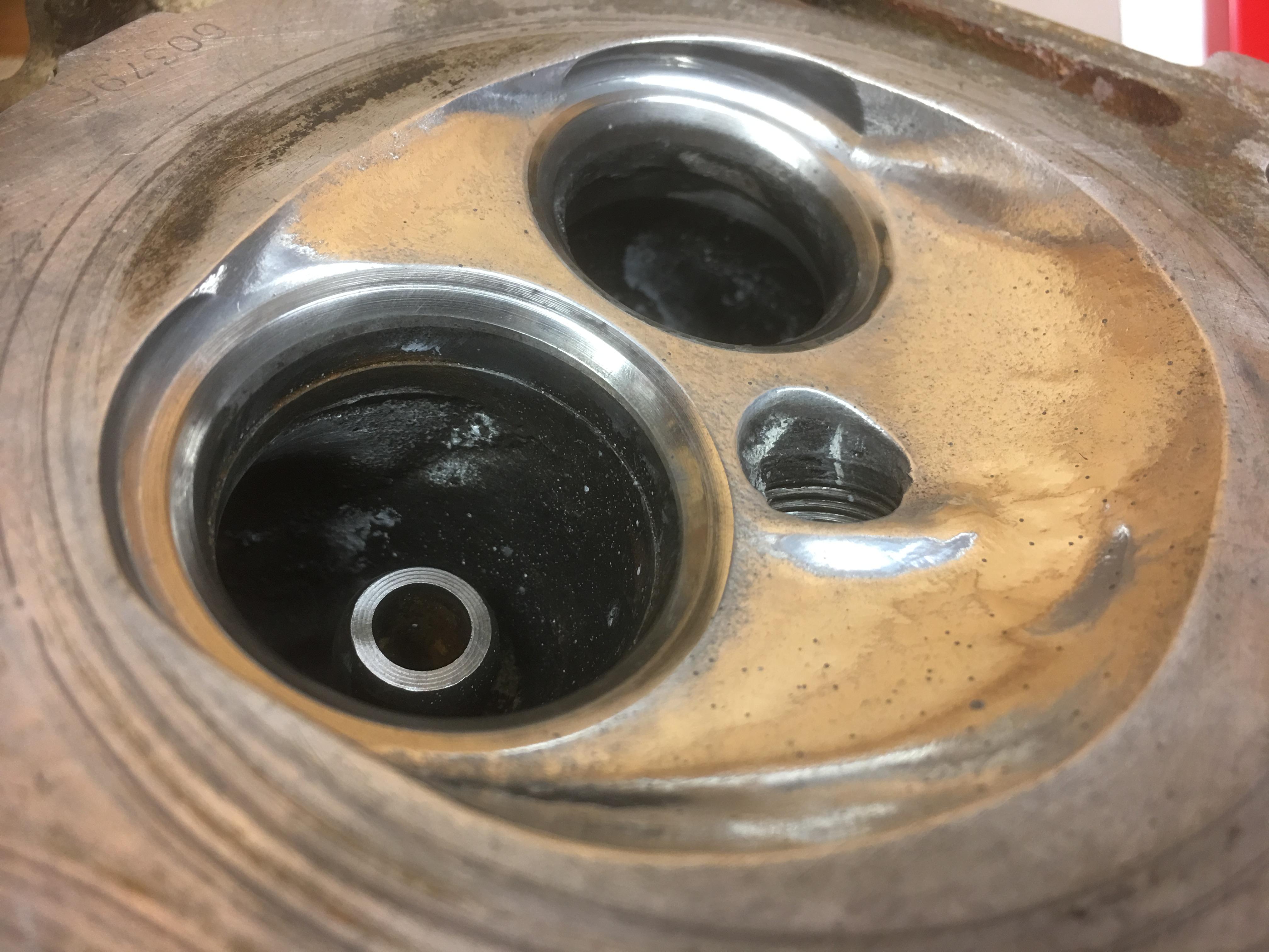

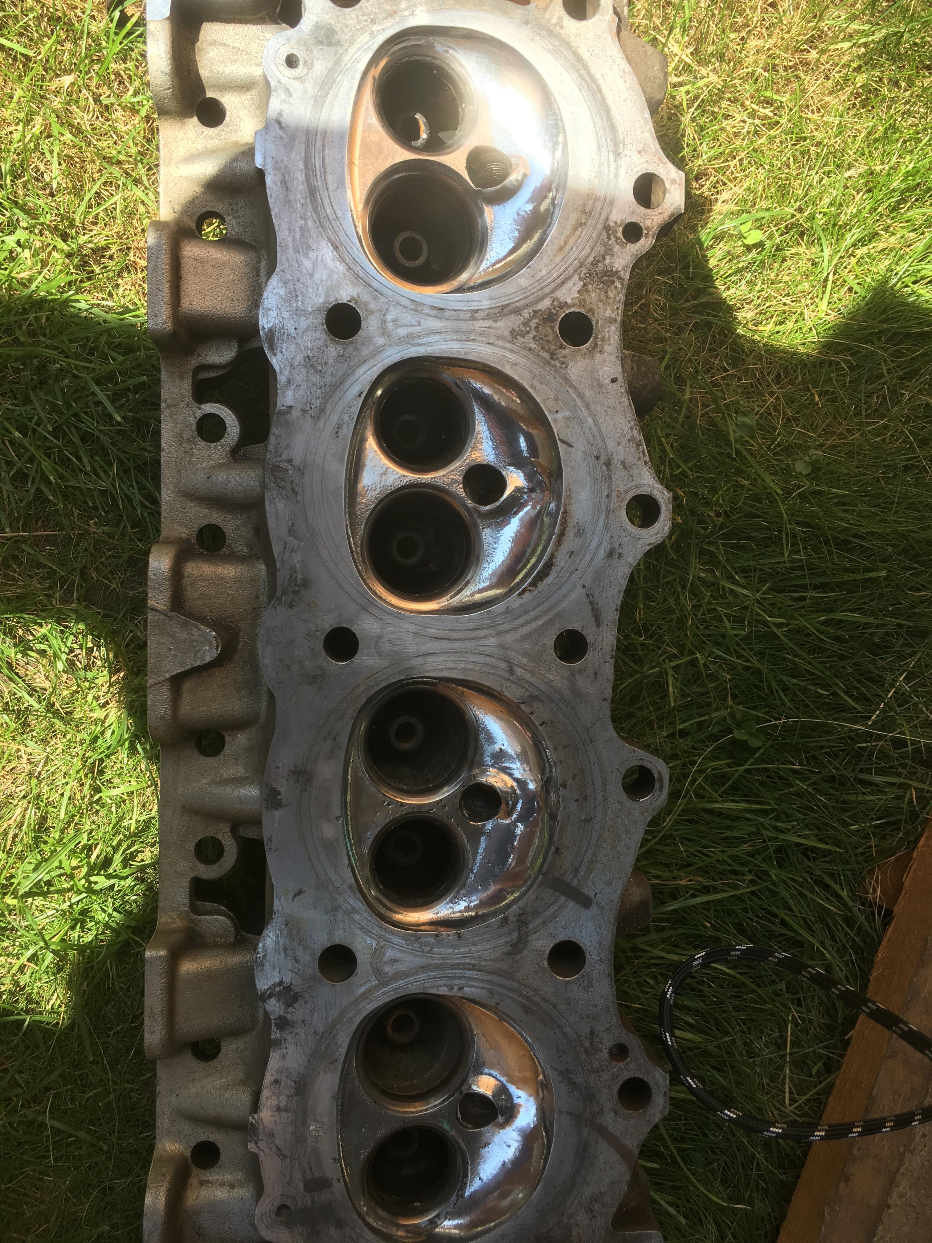

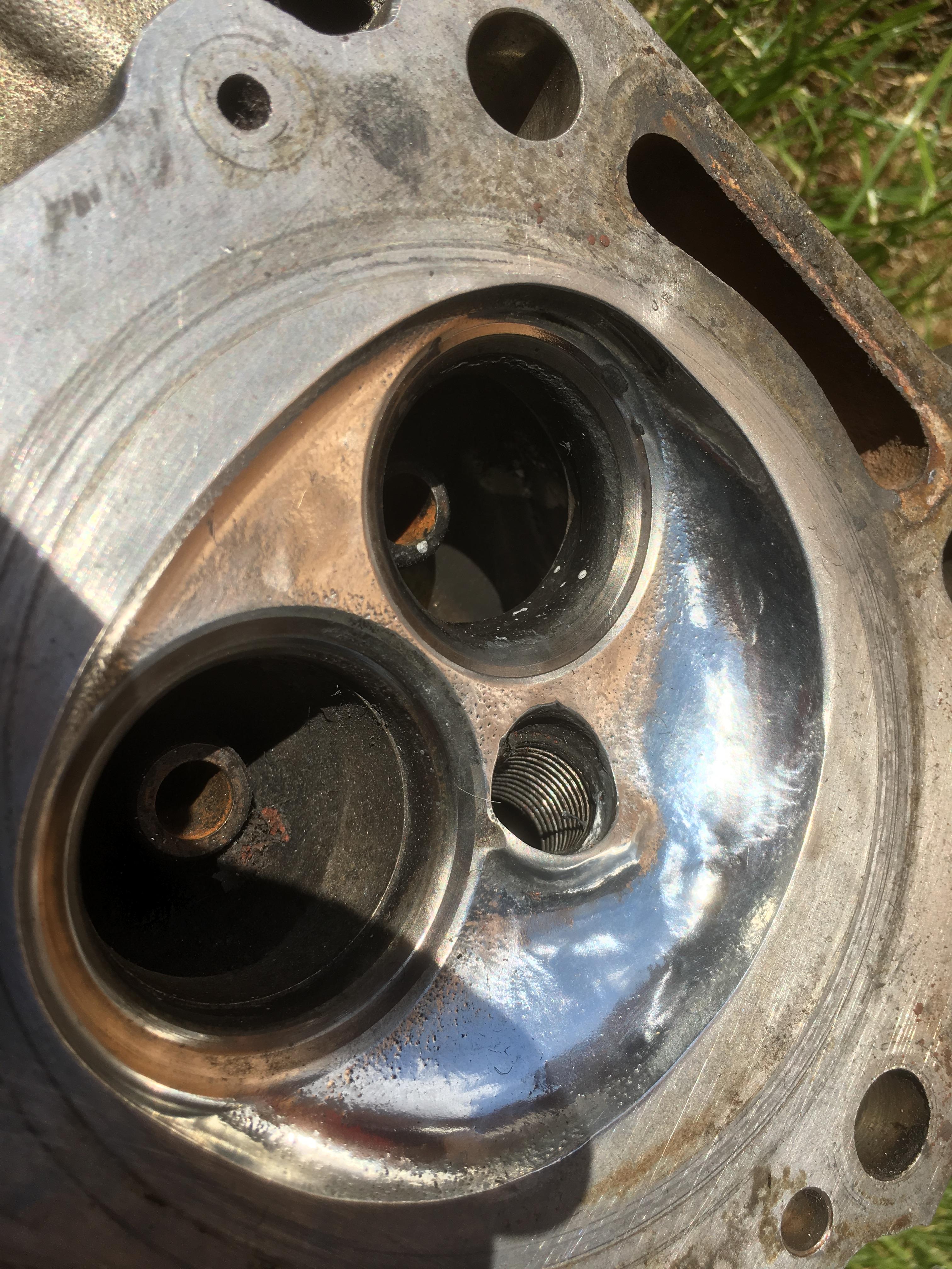

federalman Posted July 3, 2019 Author Posted July 3, 2019 Both heads now have the tops of the combustion chambers smoothed and mirror polished. Next job on the list is to gasket match the water ways and intake ports and then buff these to around 240 grit. Quote

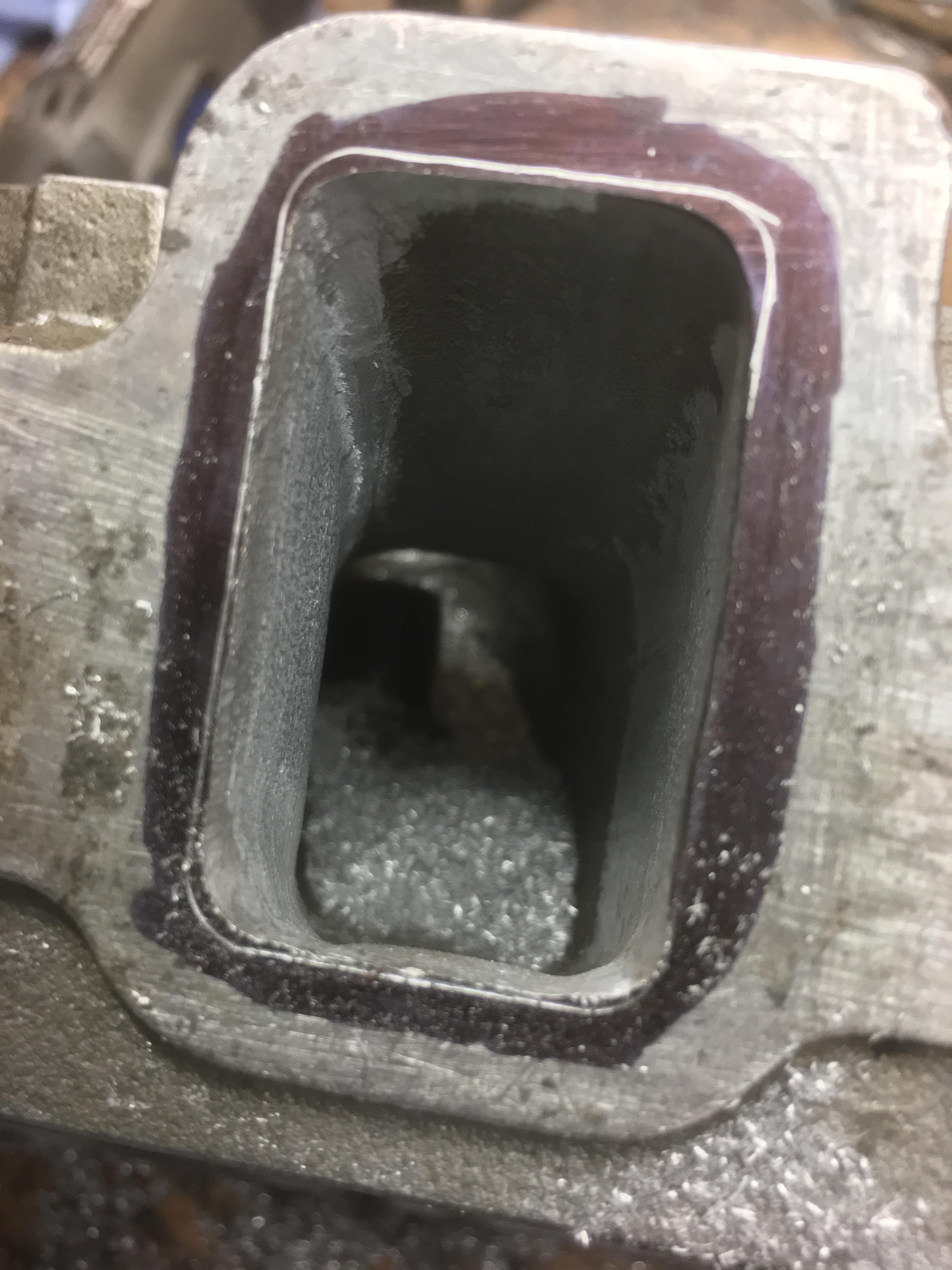

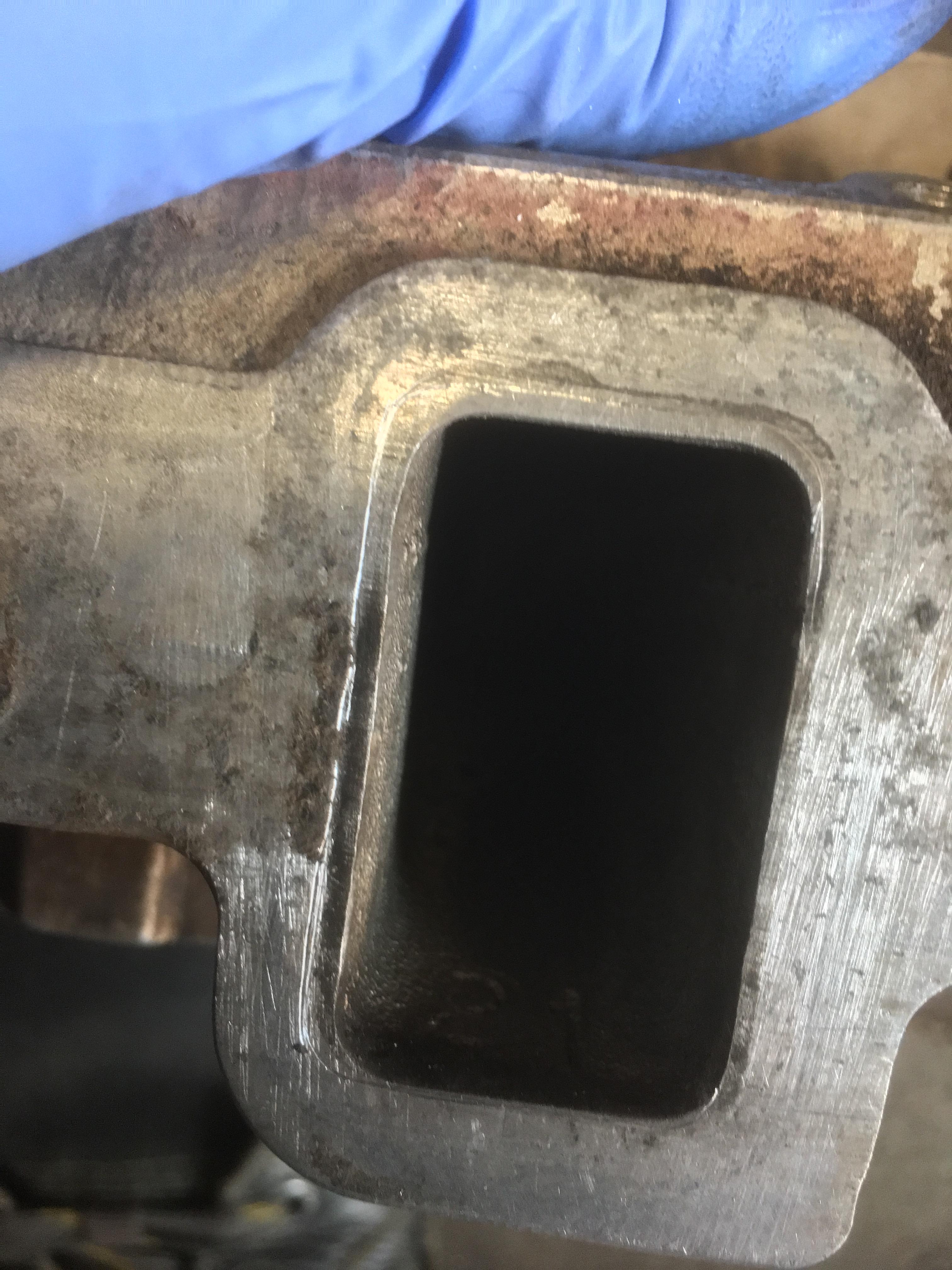

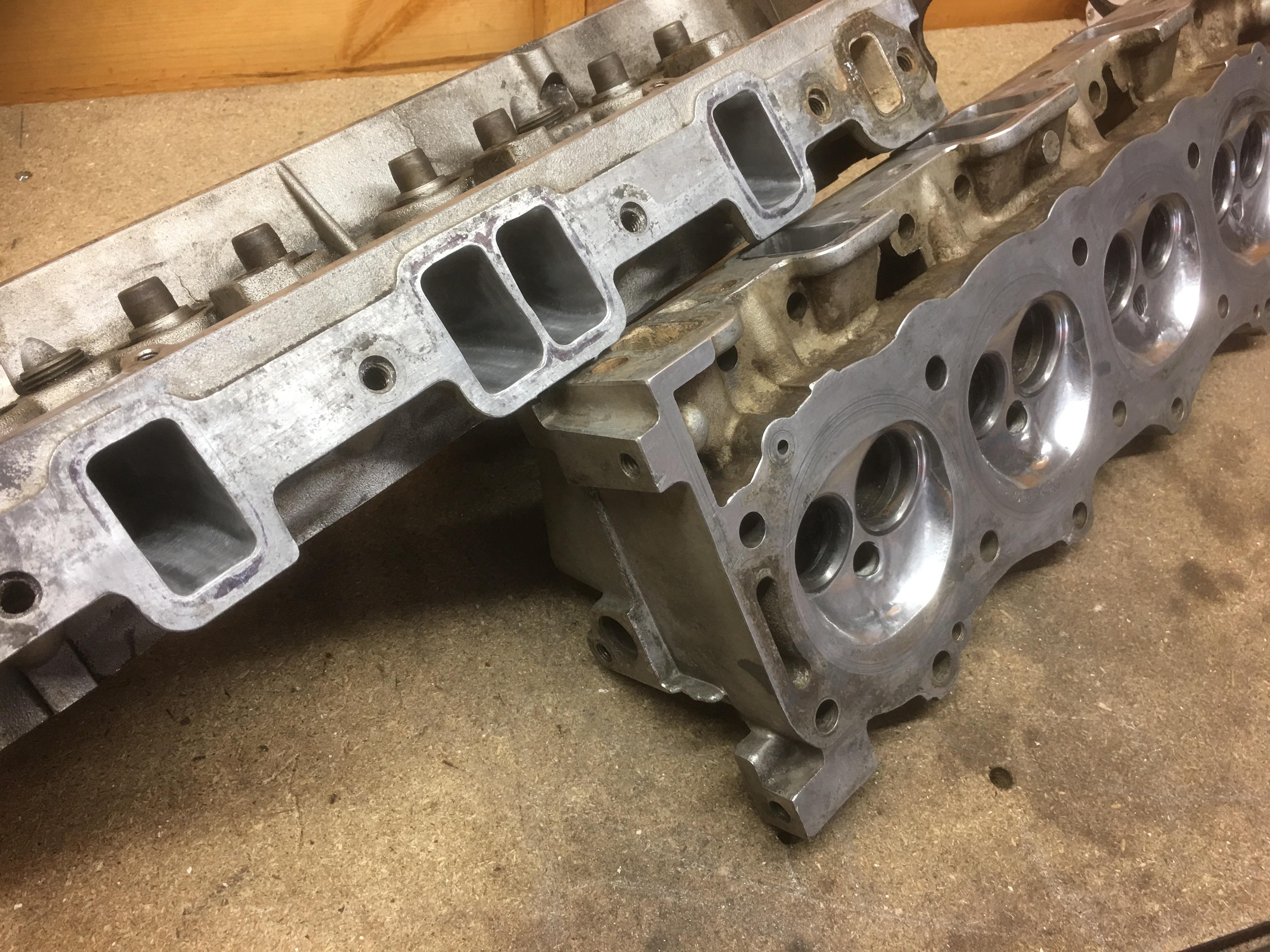

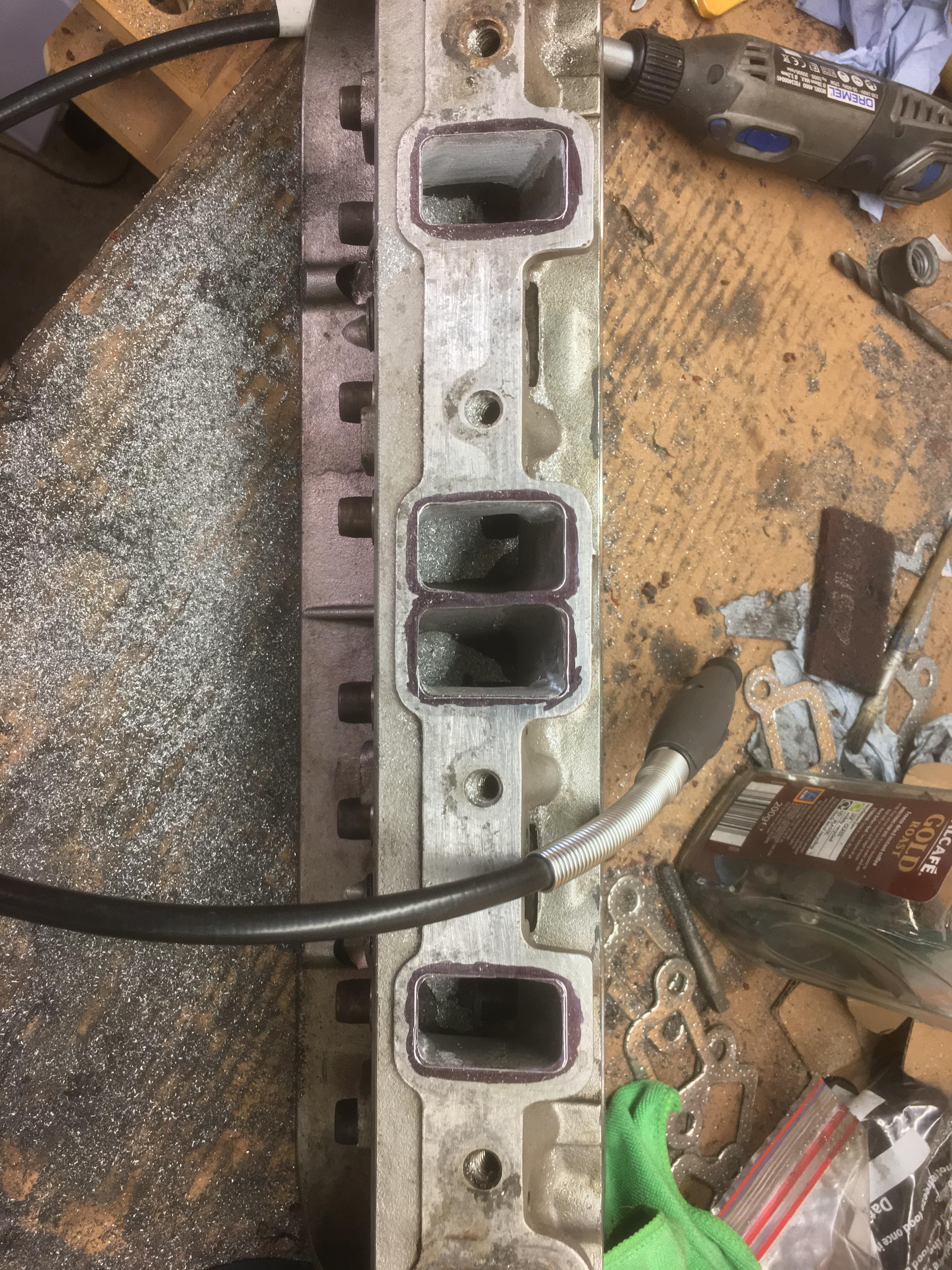

federalman Posted July 20, 2019 Author Posted July 20, 2019 Started on the intake side today. These were quite a way off. So far they’ve been roughly gasket matched and ported Quote

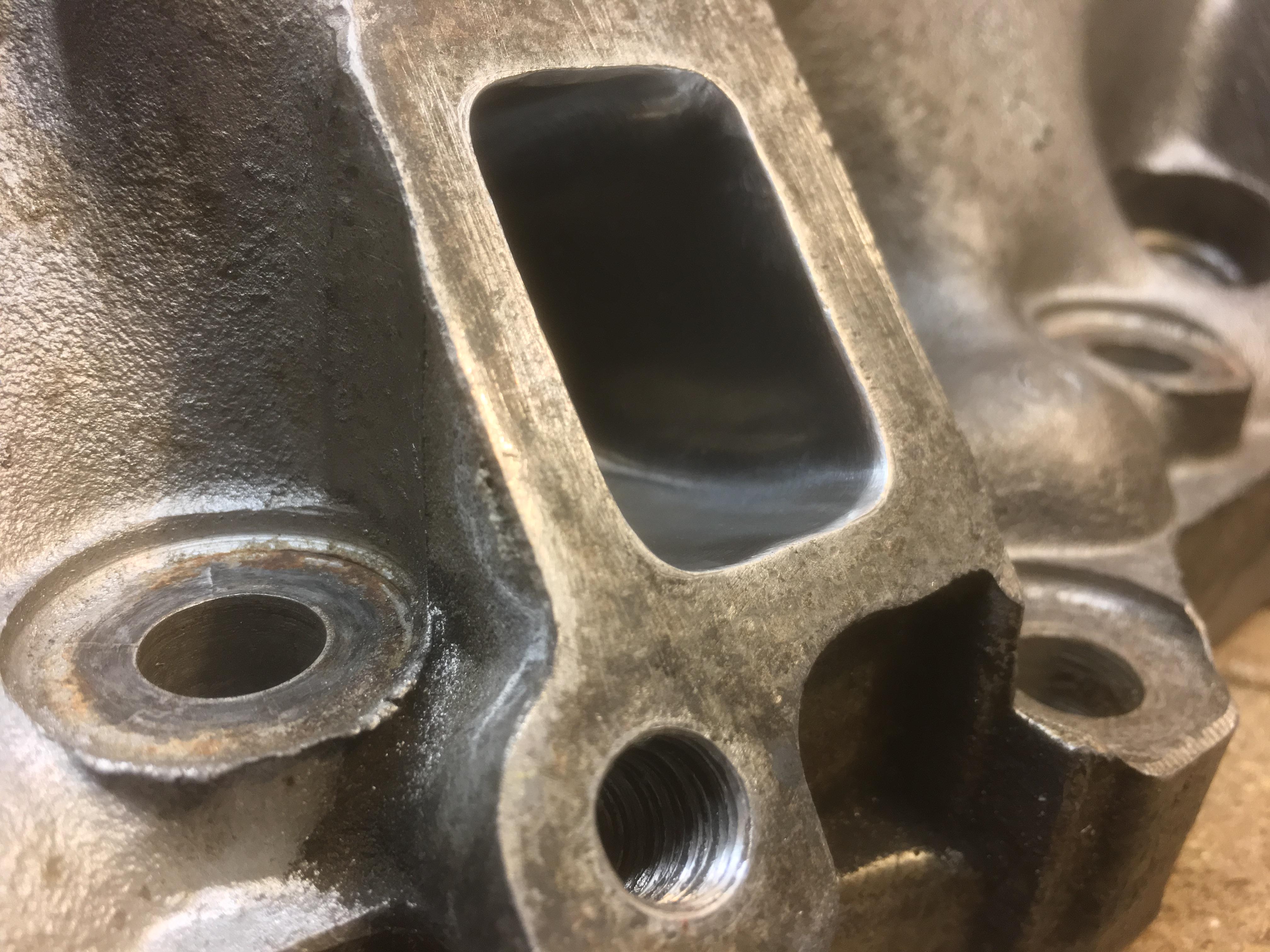

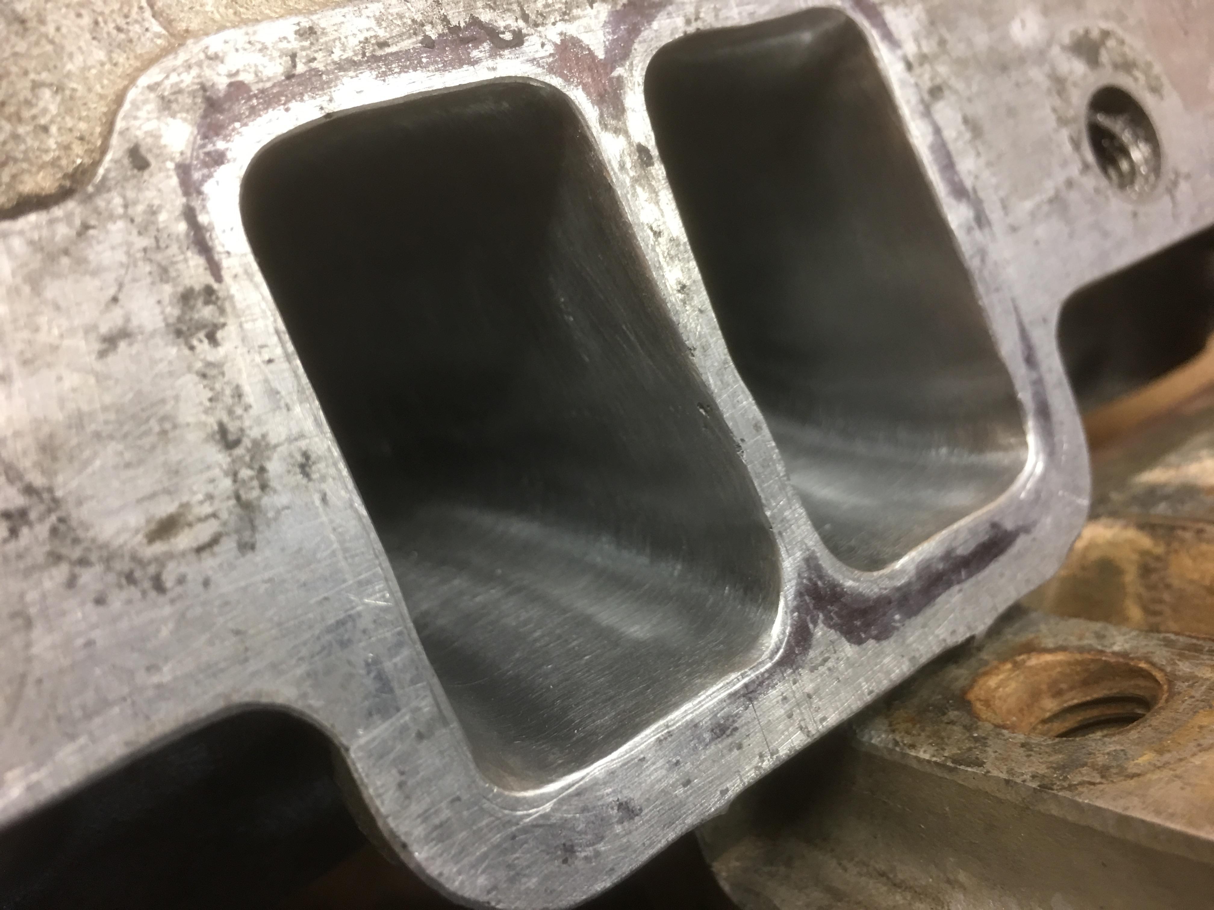

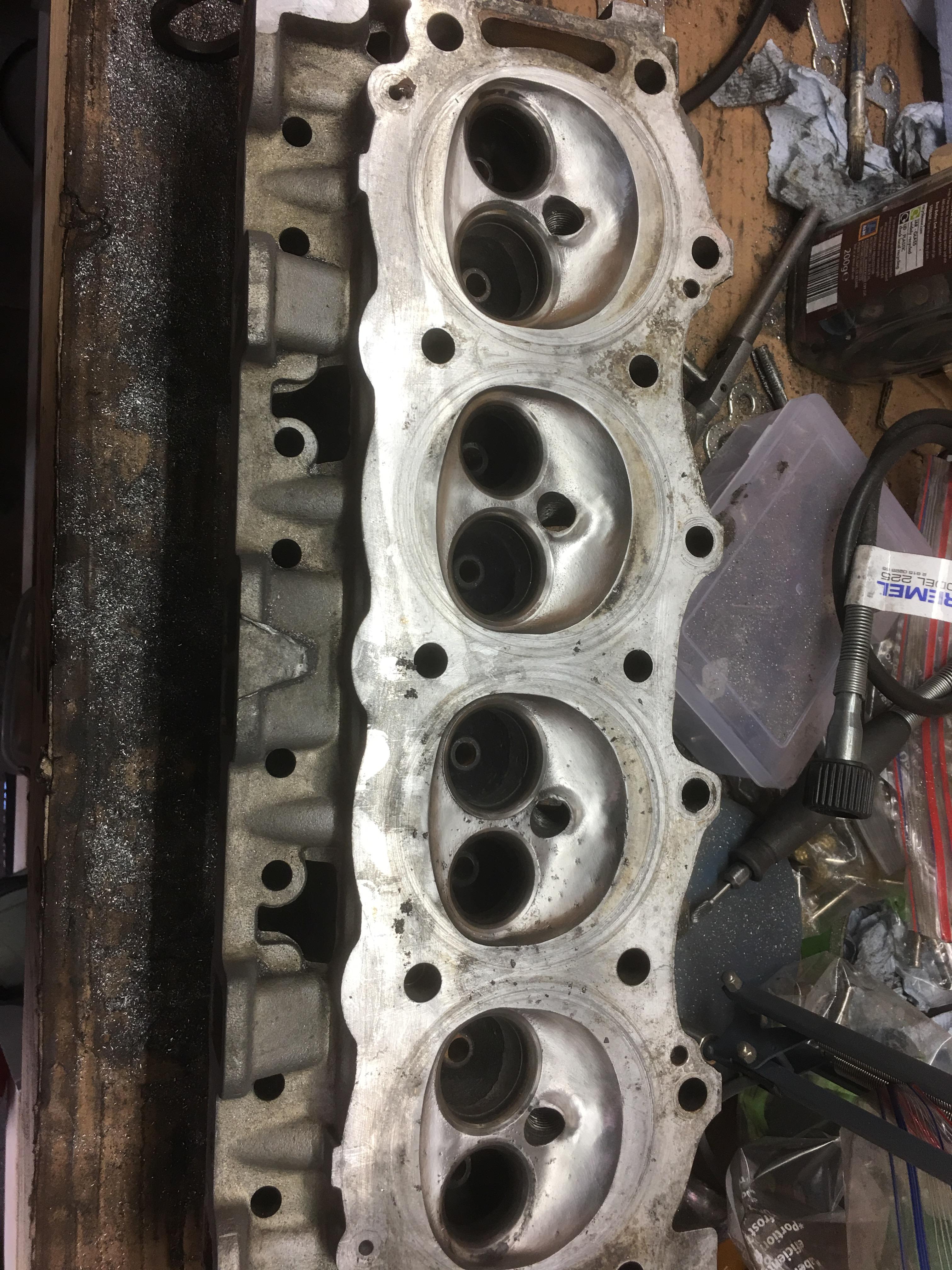

federalman Posted July 20, 2019 Author Posted July 20, 2019 Just need to sand the intakes smooth and sand the back of the valve seats and the heads are ready to be dipped and engine rebuilt. Quote
federalman Posted August 17, 2019 Author Posted August 17, 2019 I forgot to update this thread but the heads have been completed. They ended up with around 50 hours worth of work in them in the end Quote
