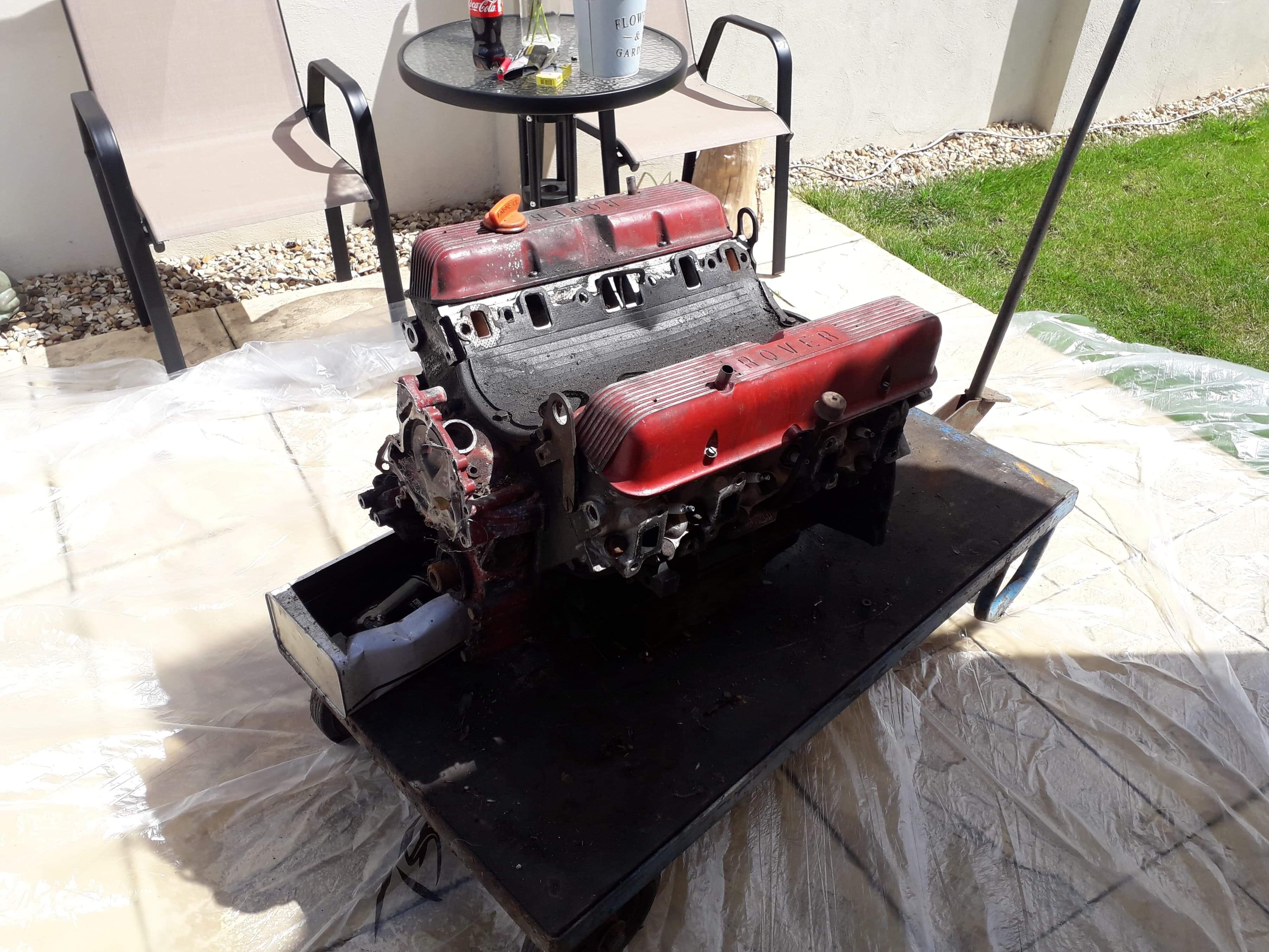

So on to the history of this engine and it’s past as well as it’s present day ownership.
It’s an ex works rally engine from 1978 Triumph TR7 V8. There were 3 cars entered that year, each having a spare engine the idea being the engines could be swapped between all cars. During this season the TR dominated the circuit with nothing to catch it. The car it now sits in is one of twenty rhd TR8s and it is believe to be one of the last produced. Of the six only five have actually been found, so the last one could well be out there with an owner who has no idea why their TR is quicker than others.

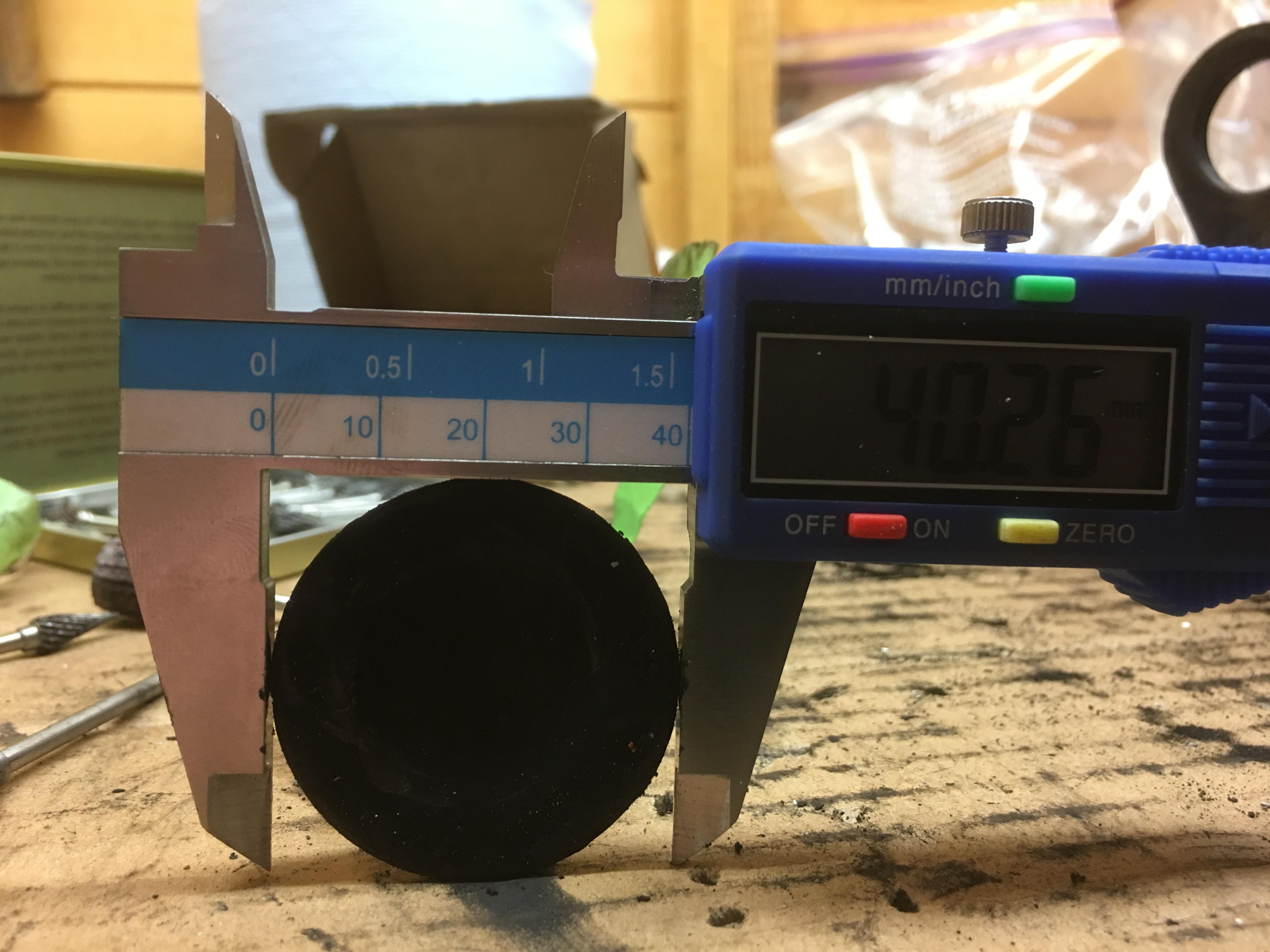

The valves in this engine are quite a combination. The 34mm exhaust valves are in fact the standard inlet valves for this head. The 40mm inlet valves are from an unknown engine. You can see how close the inlets were machined to the cylinder by the Triumph engineers when this engine was originally built. The piston rings in this are not standard as they are thinner and are now extremely hard to come by. The timing chain is an American imported item.

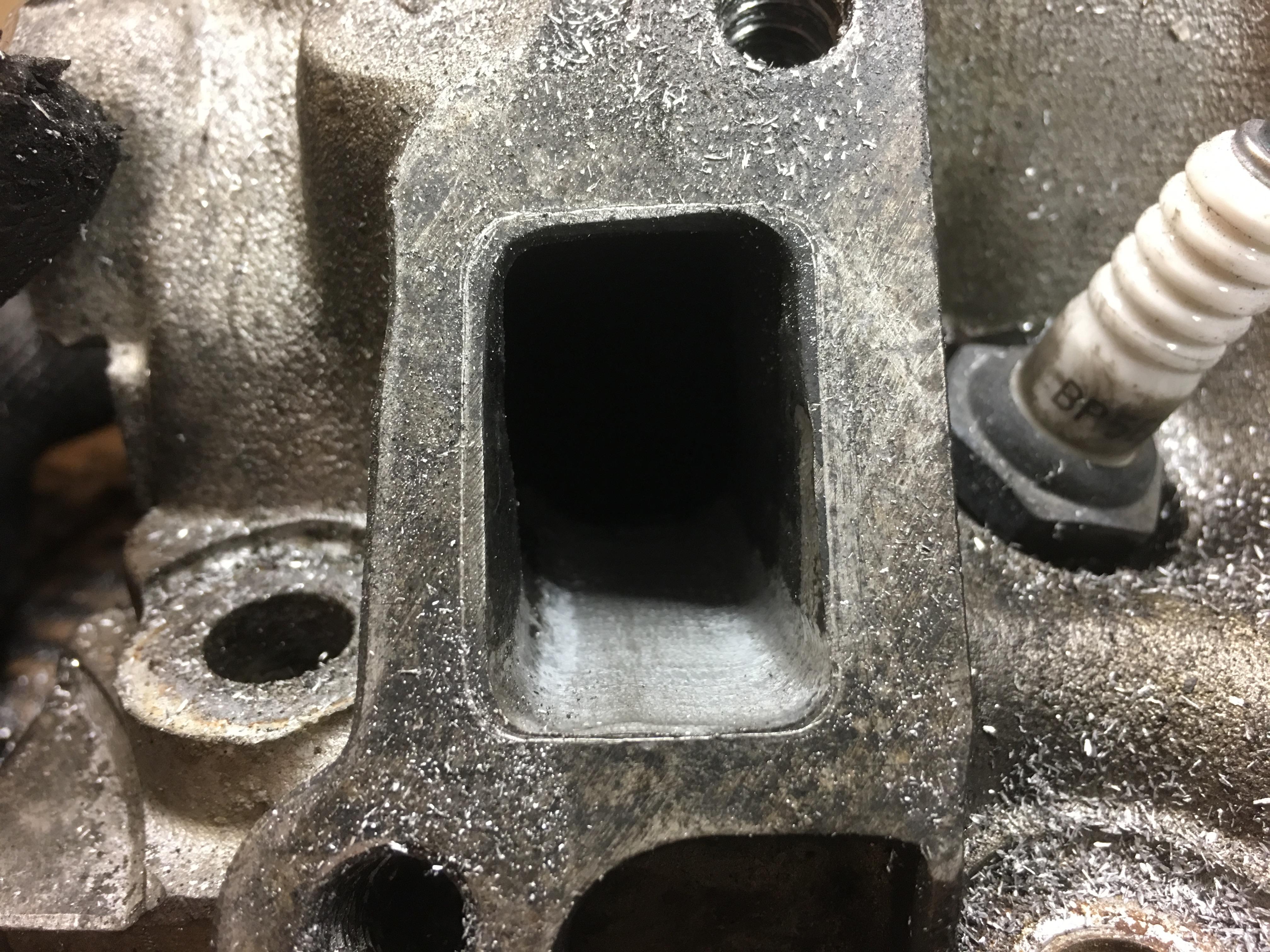

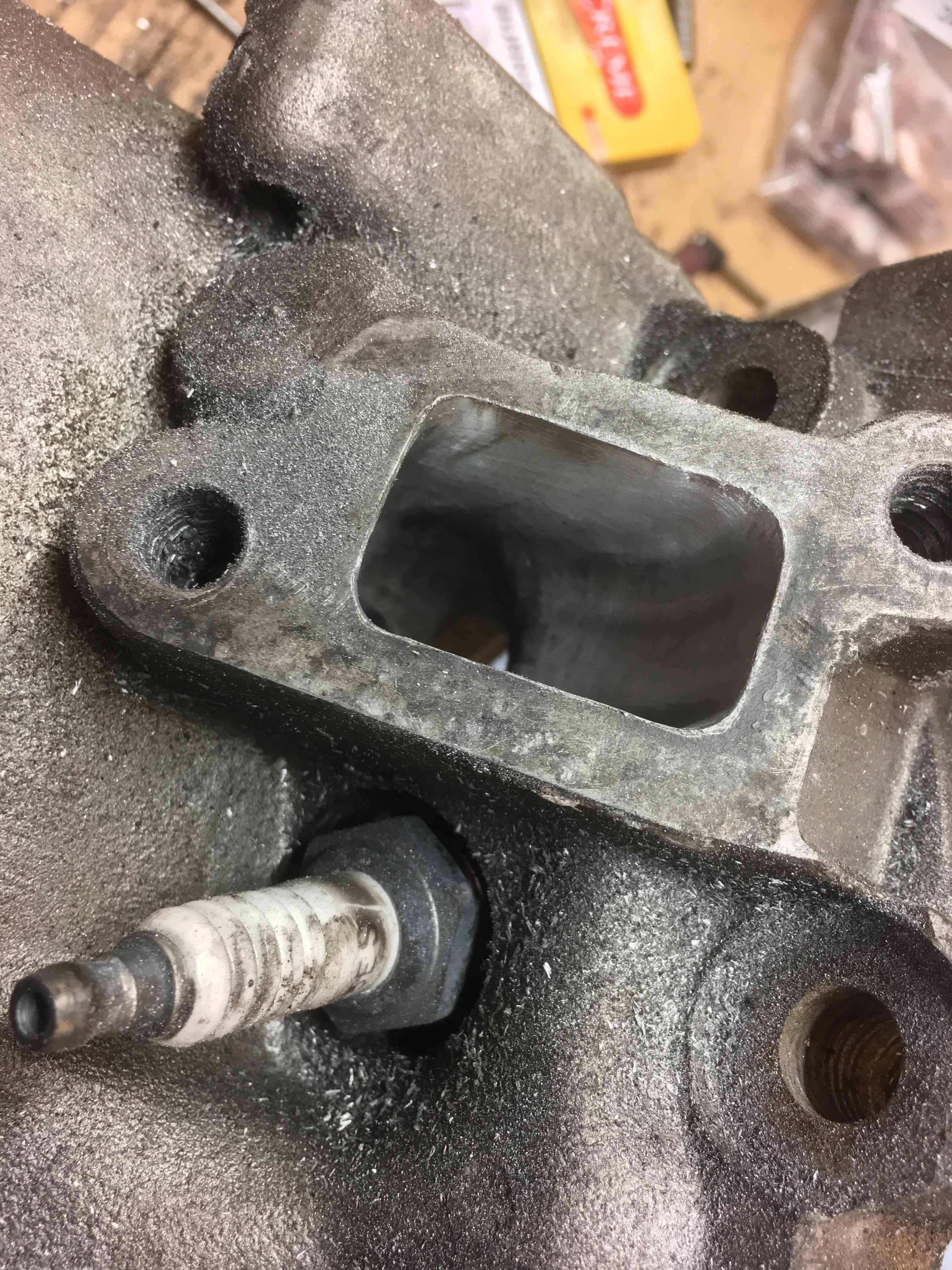

The size difference between the original port and what they can be taken out to is quite surprising.

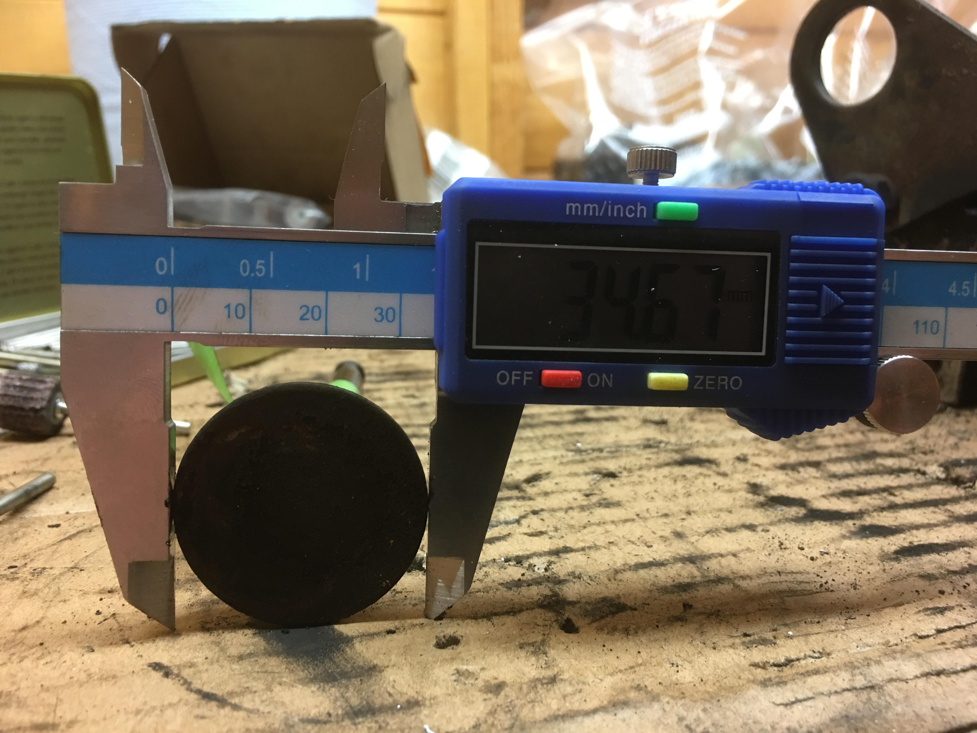

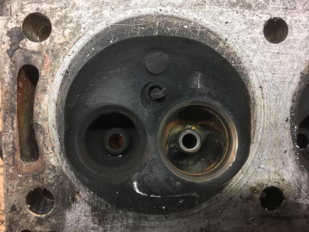

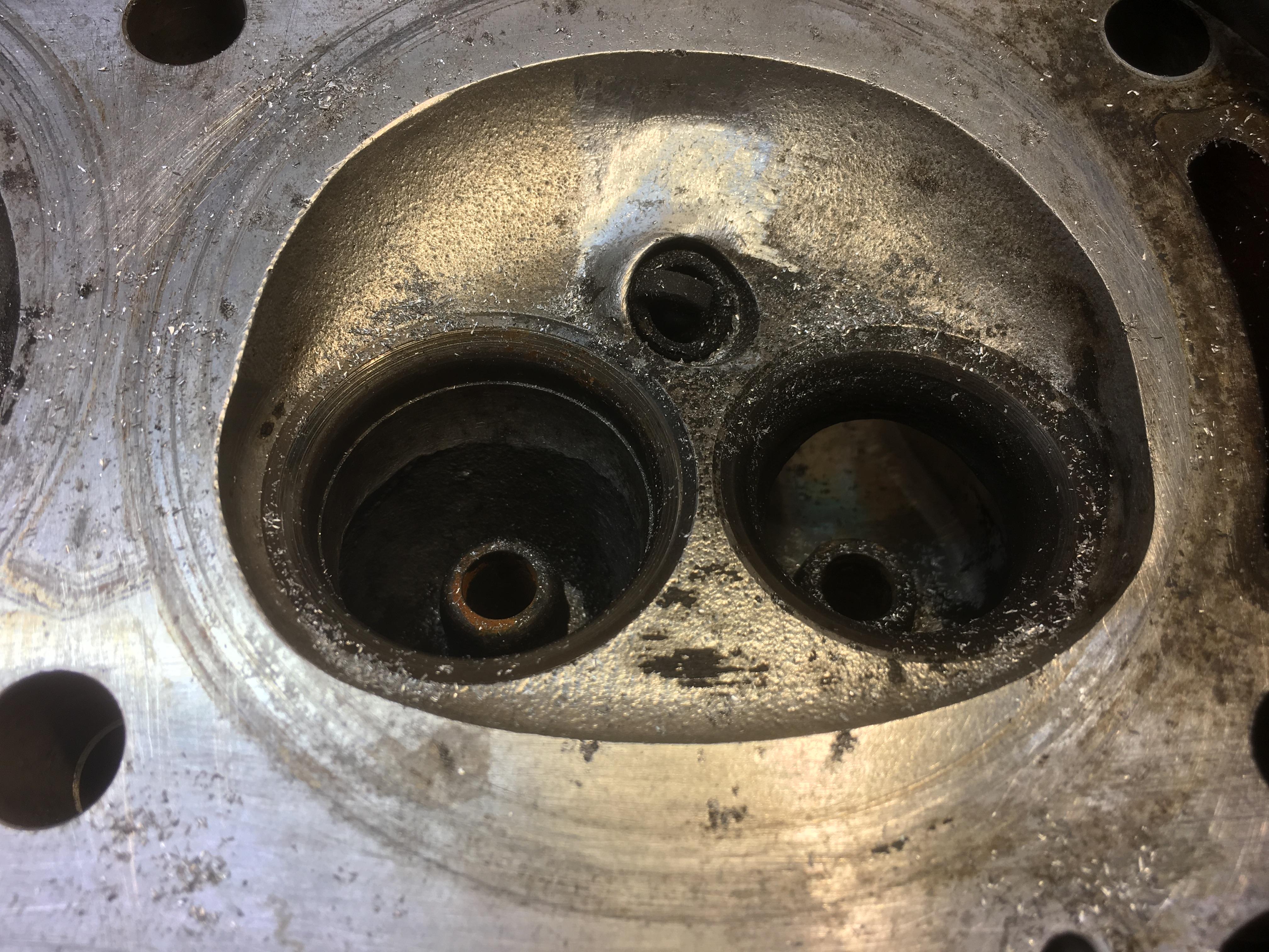

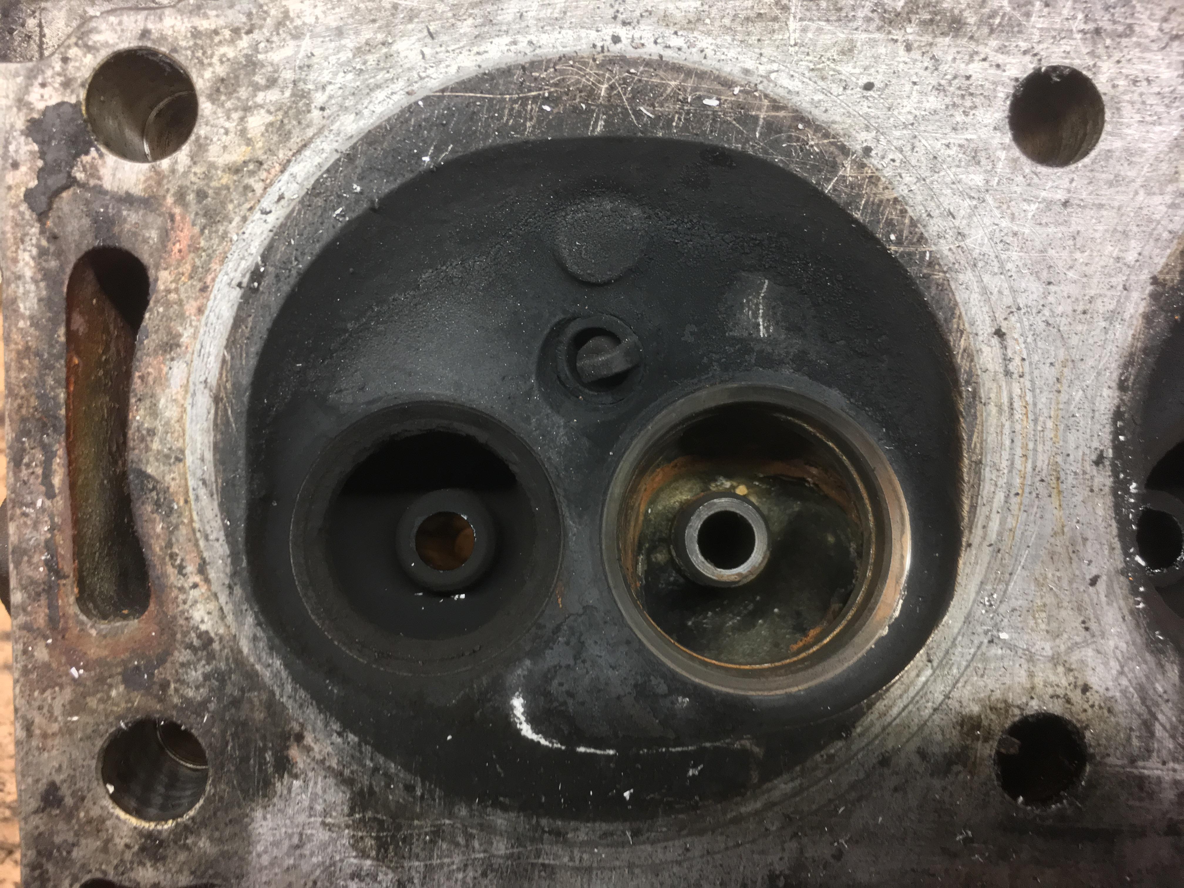

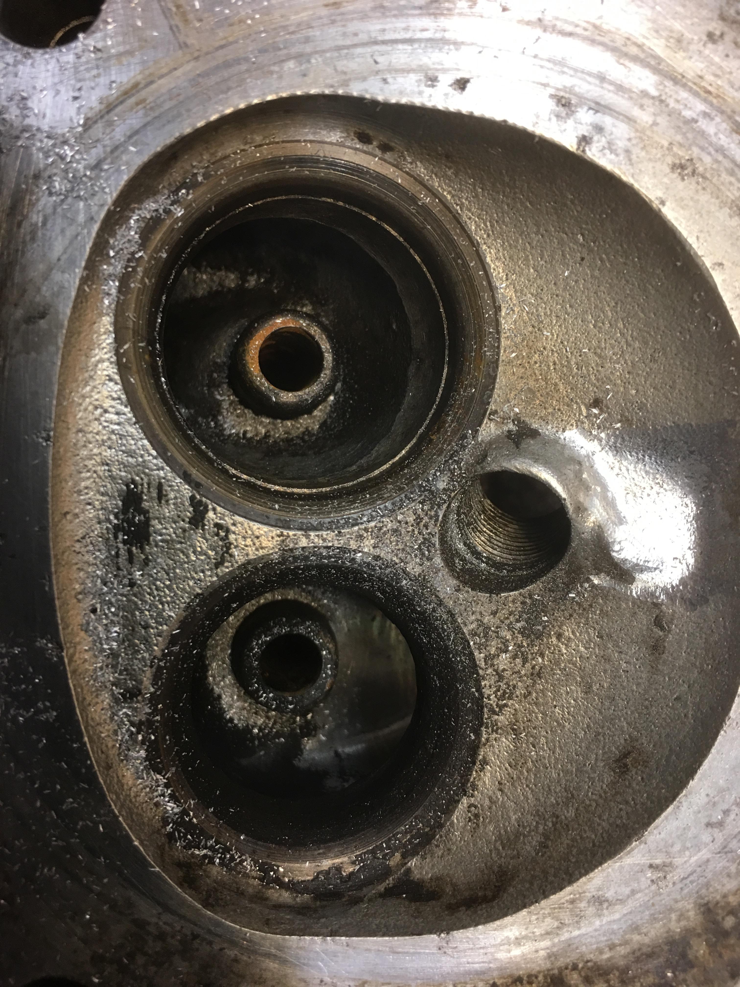

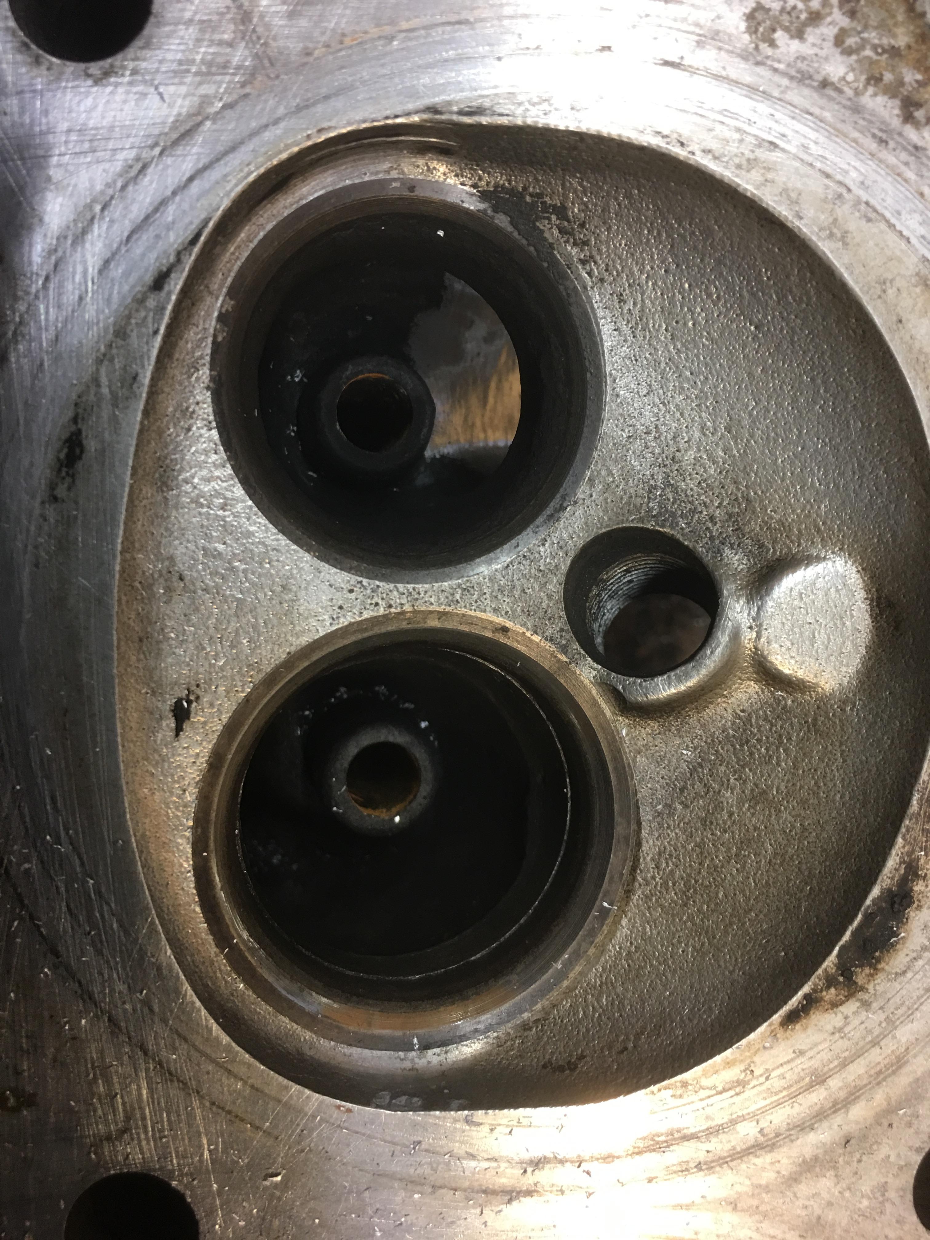

The head uses 34mm exhaust valves. These were originally the intake valves. The 40mm intake valves are from an unknown engine. As you can see the valve seats have been cut in by Triumph engine builders very close to the sides of the cylinder wall. The aluminium sticking out above the spark plug will be ground off with a carbide burr before completely polishing the top of the cylinder. The back of the valve seats have a very sharp angle to it so this will be reduced and smoother into the rest of the port before polishing.

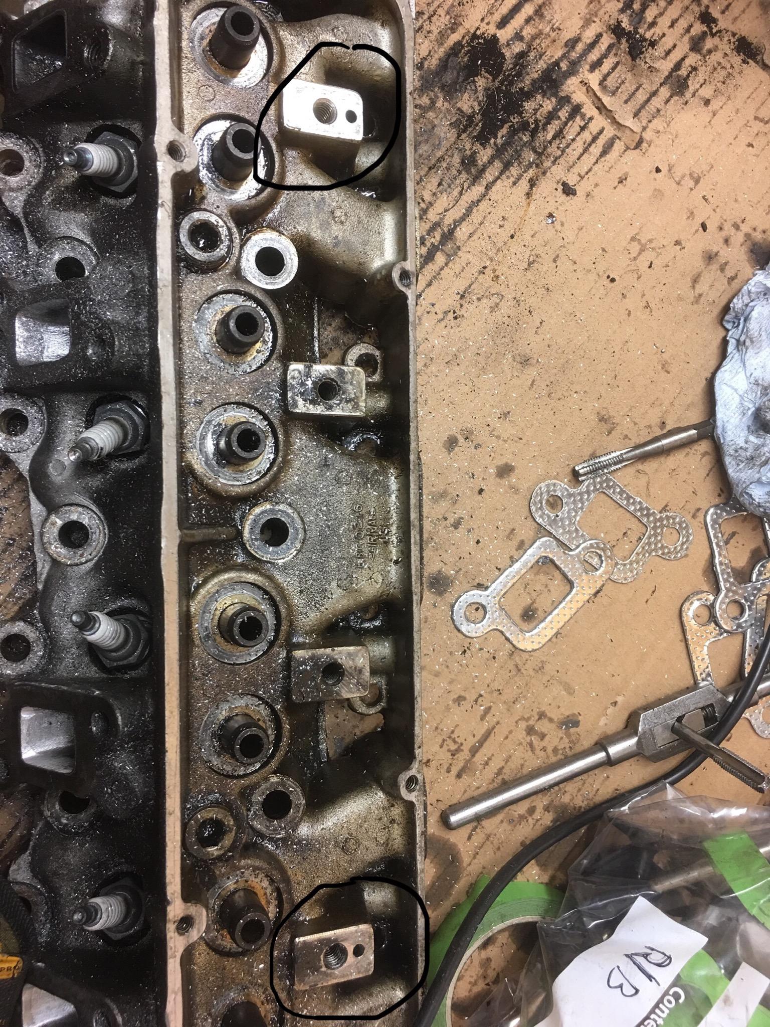

Extra oil galleries have been drilled into the heads from the factory (circled) as well as extra head studs. The push rod guides have also been enlarged to accommodate thicker push rods and the angle that these will move at due to the 285 cam.

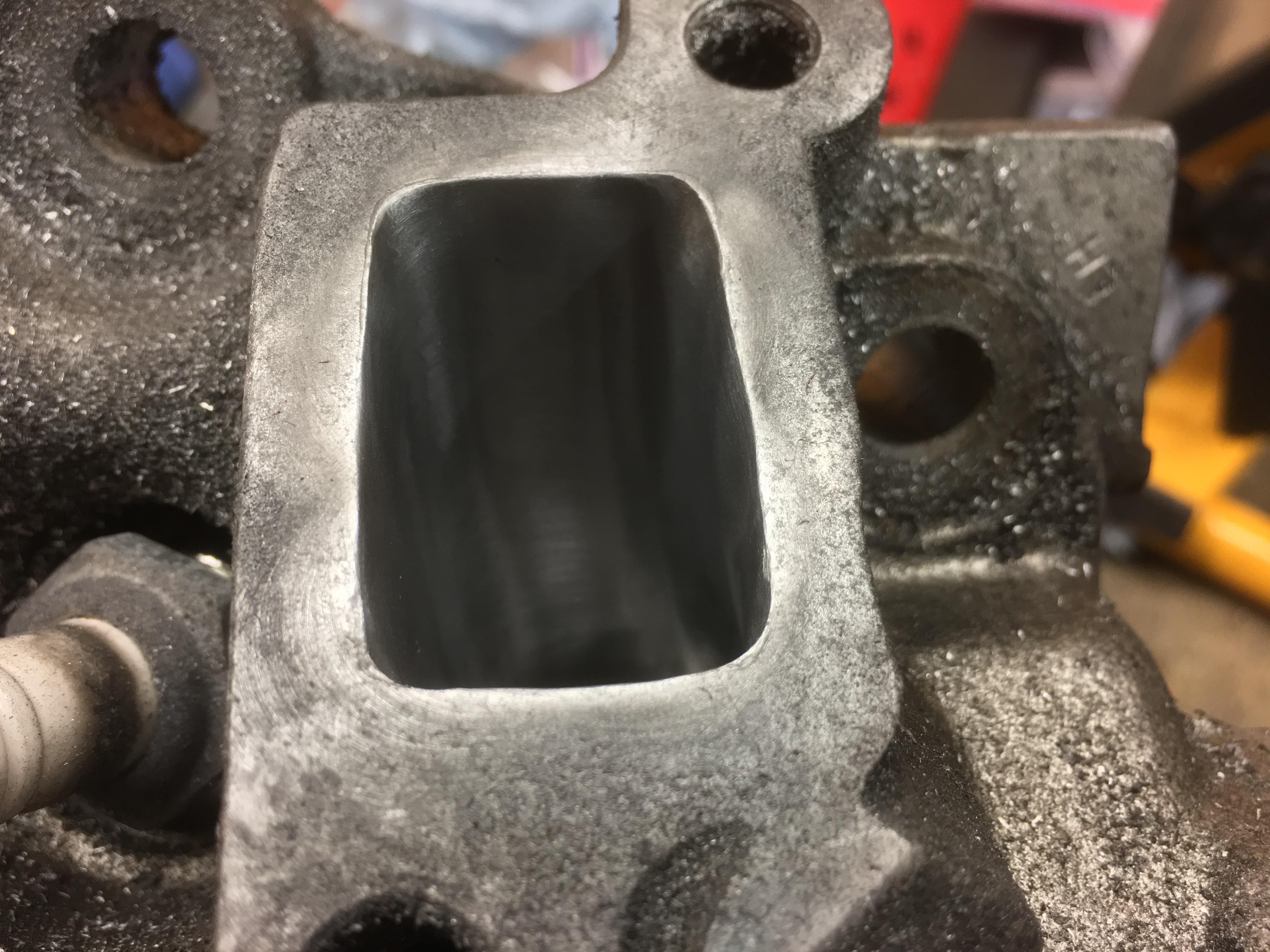

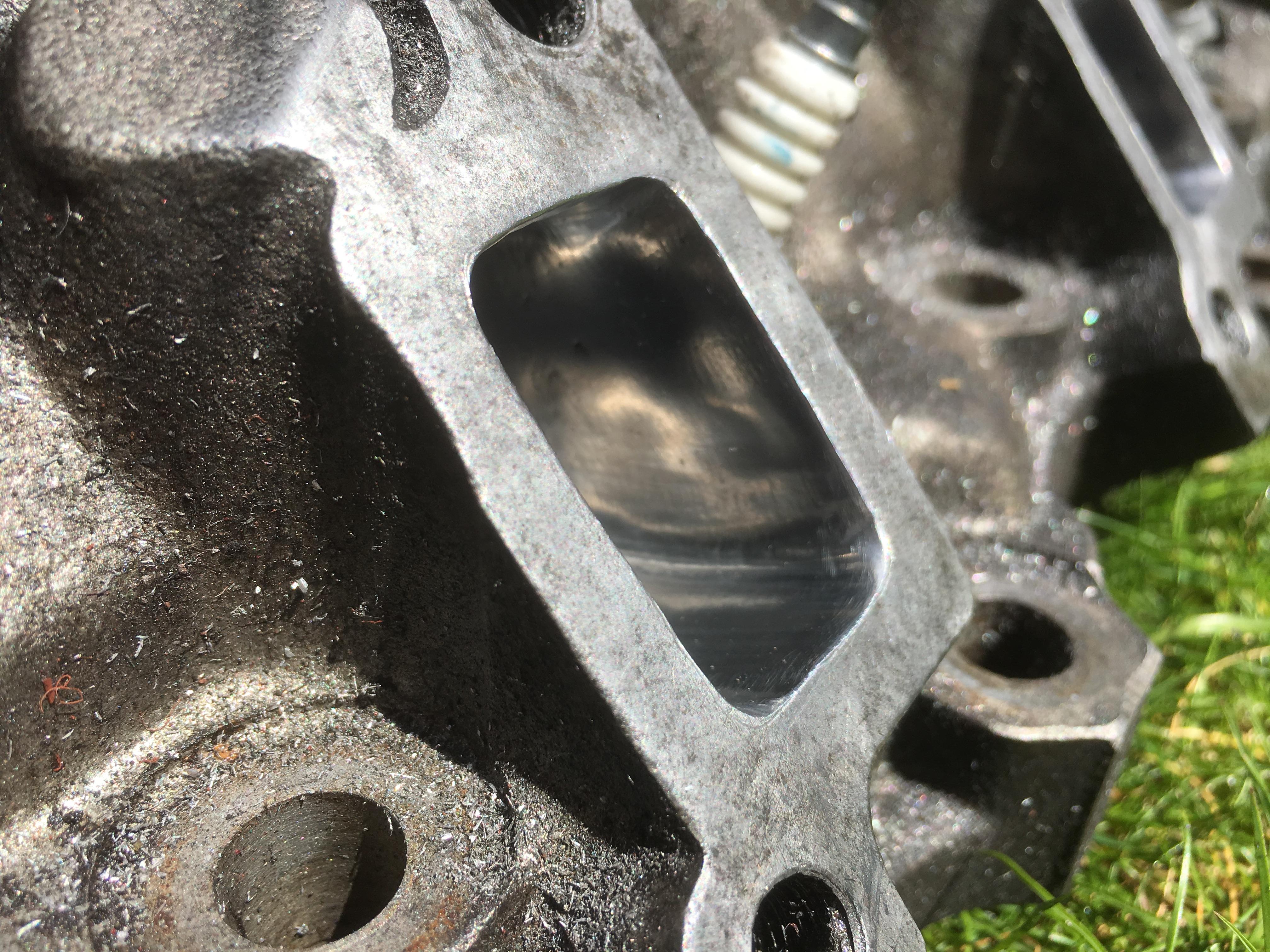

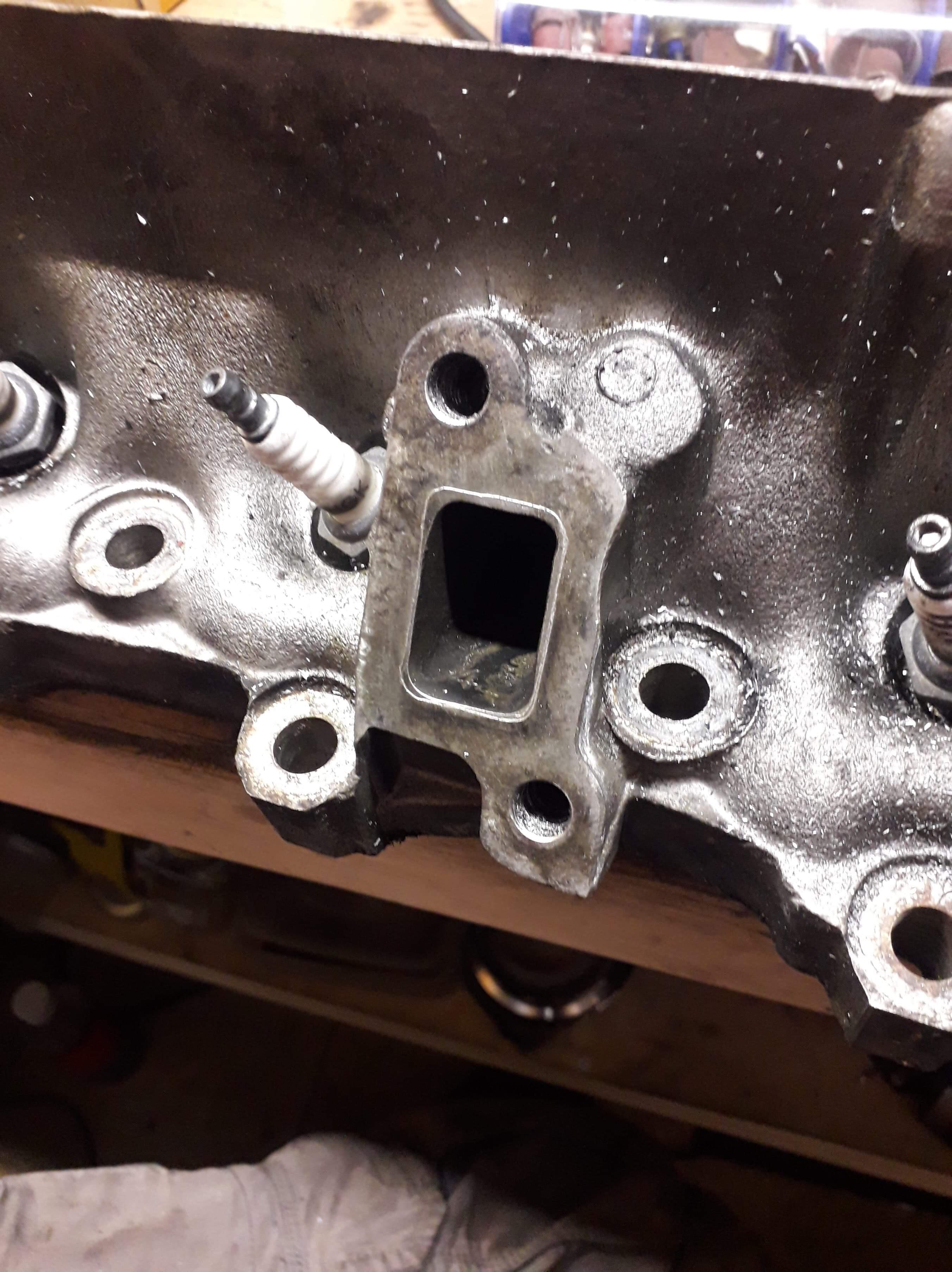

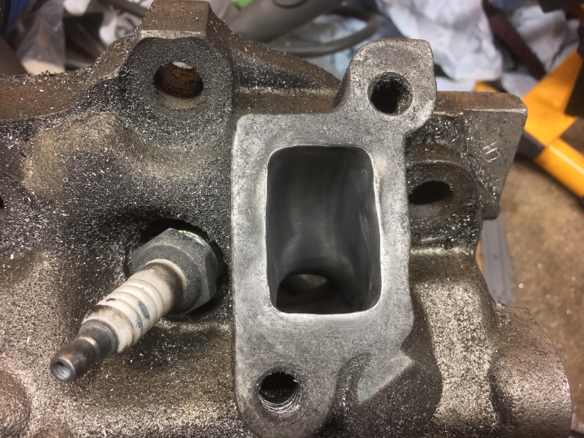

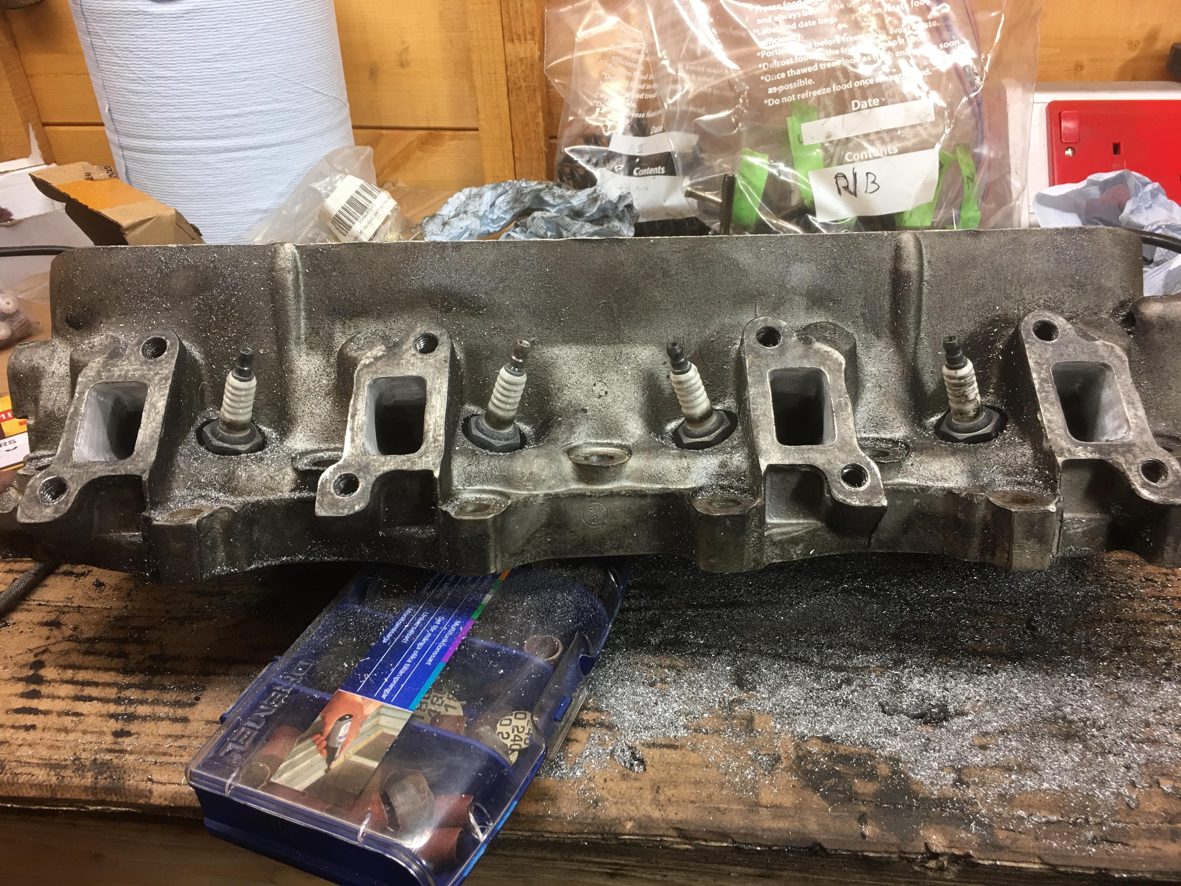

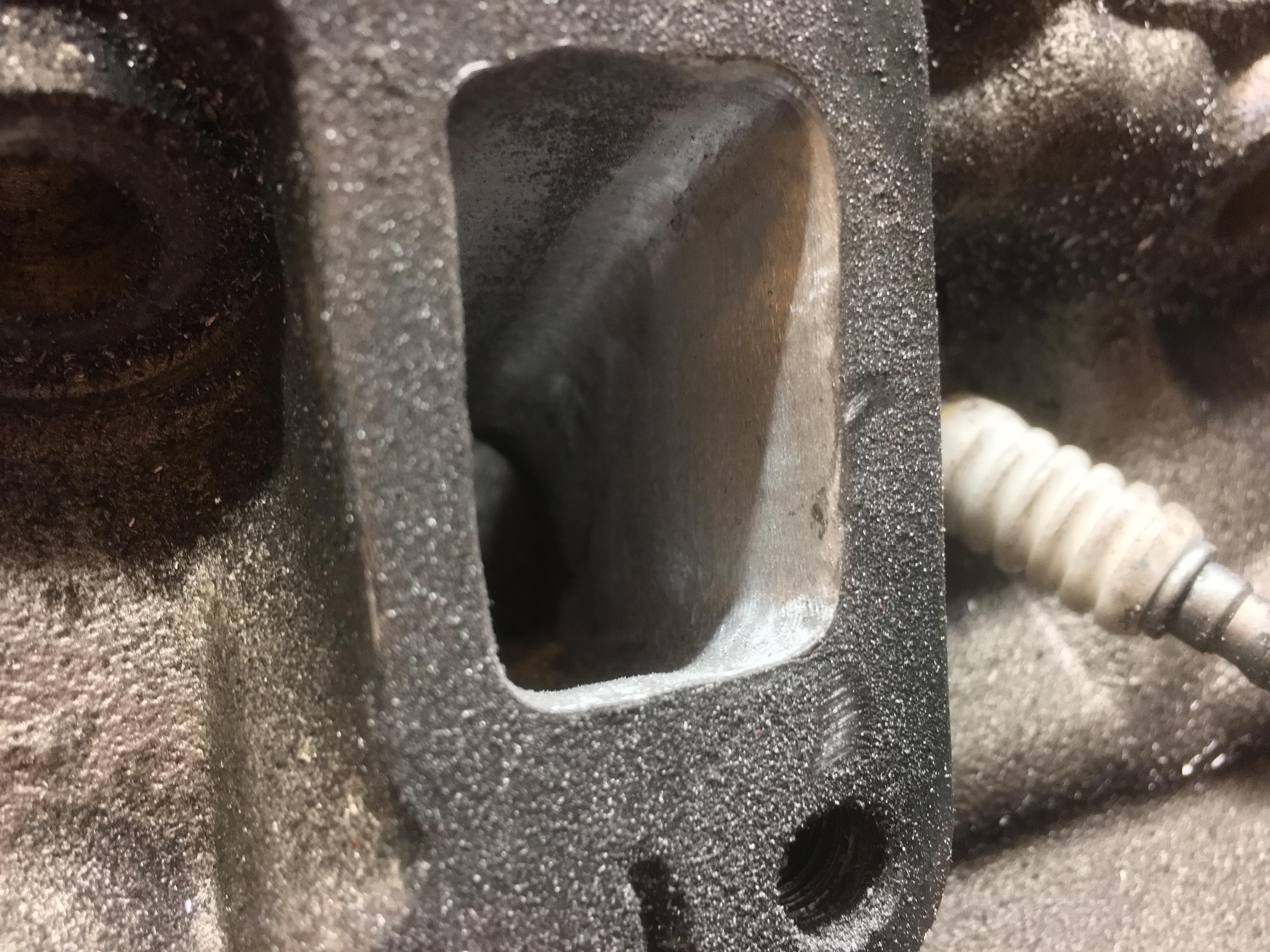

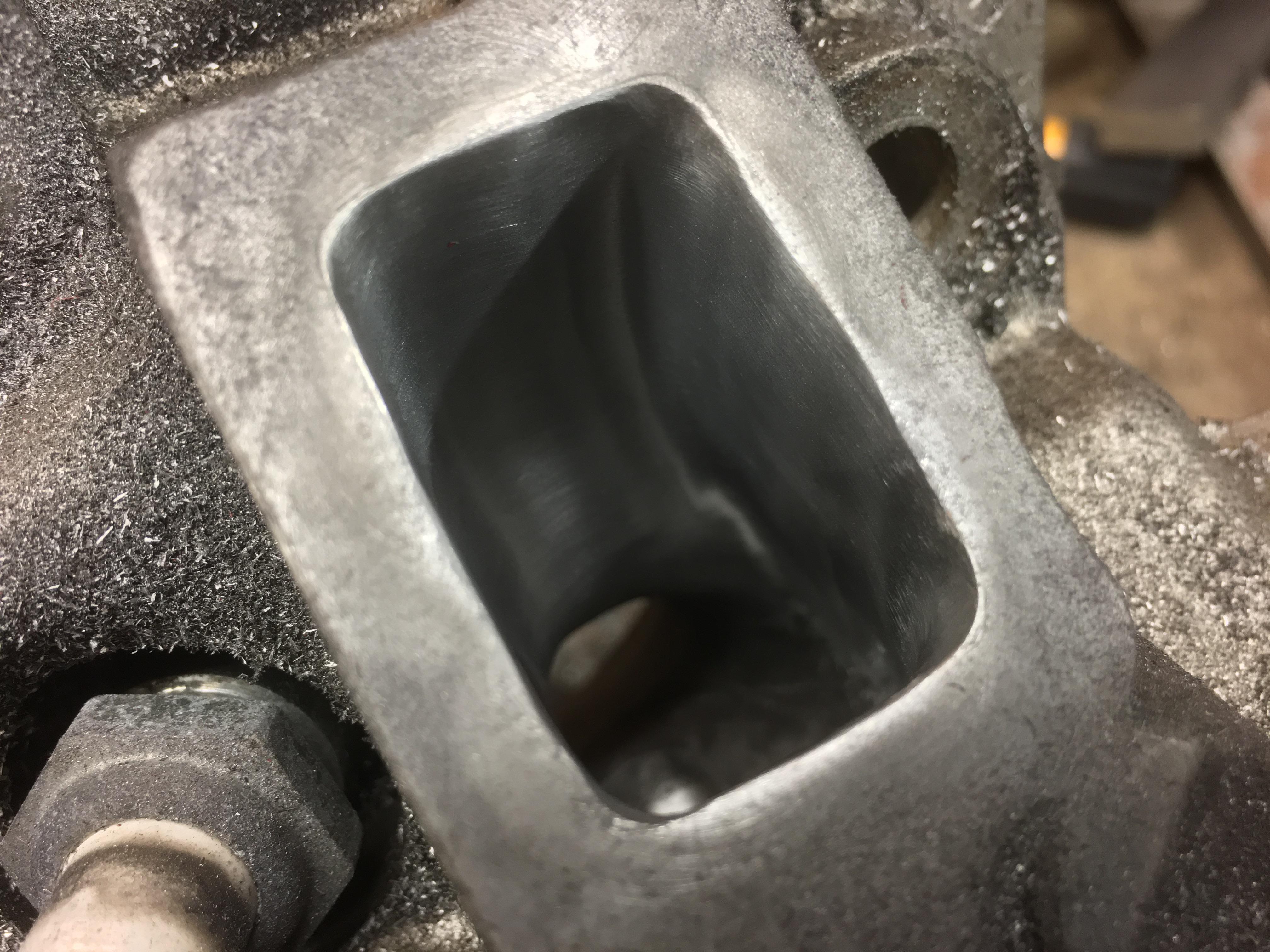

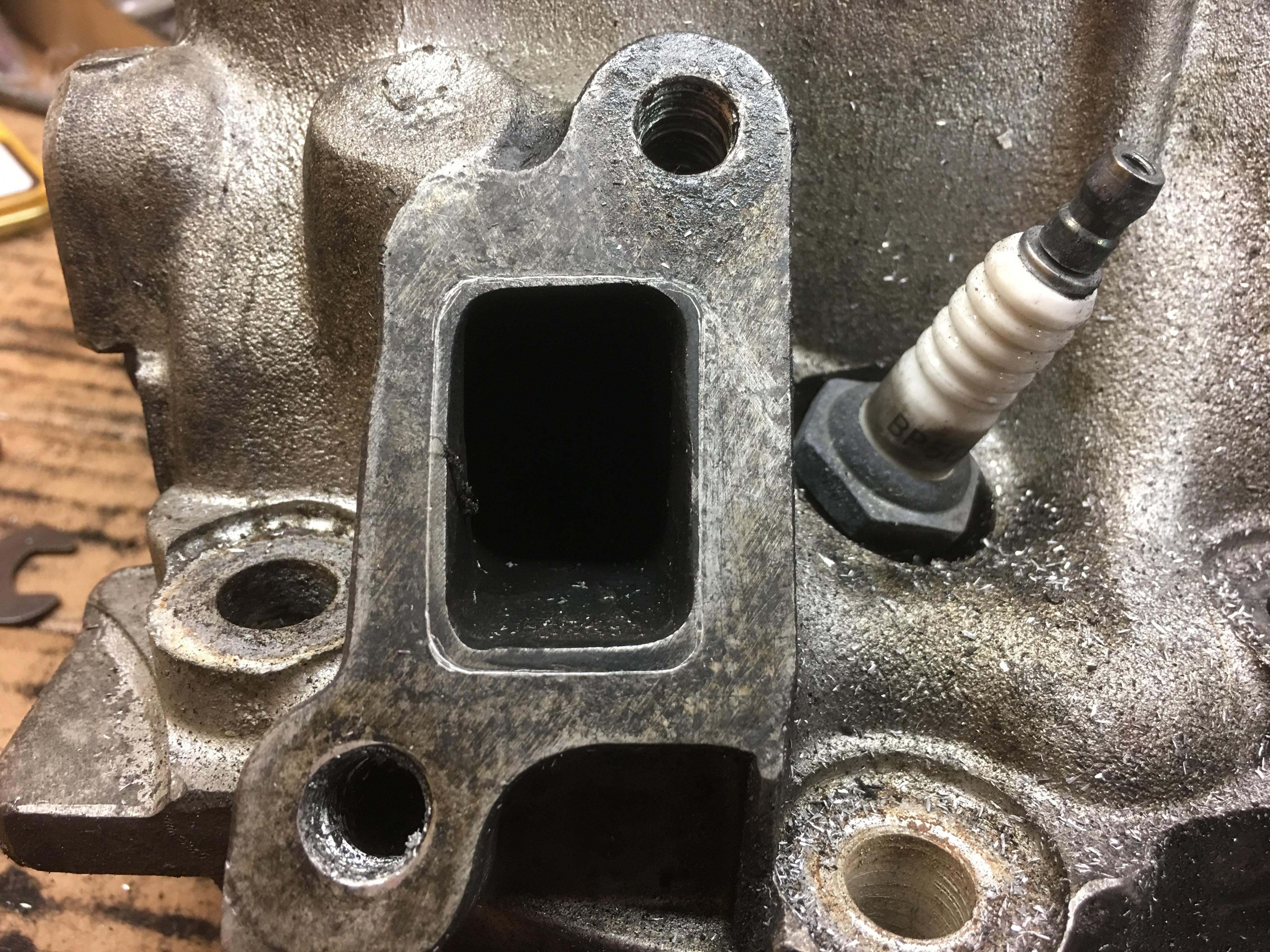

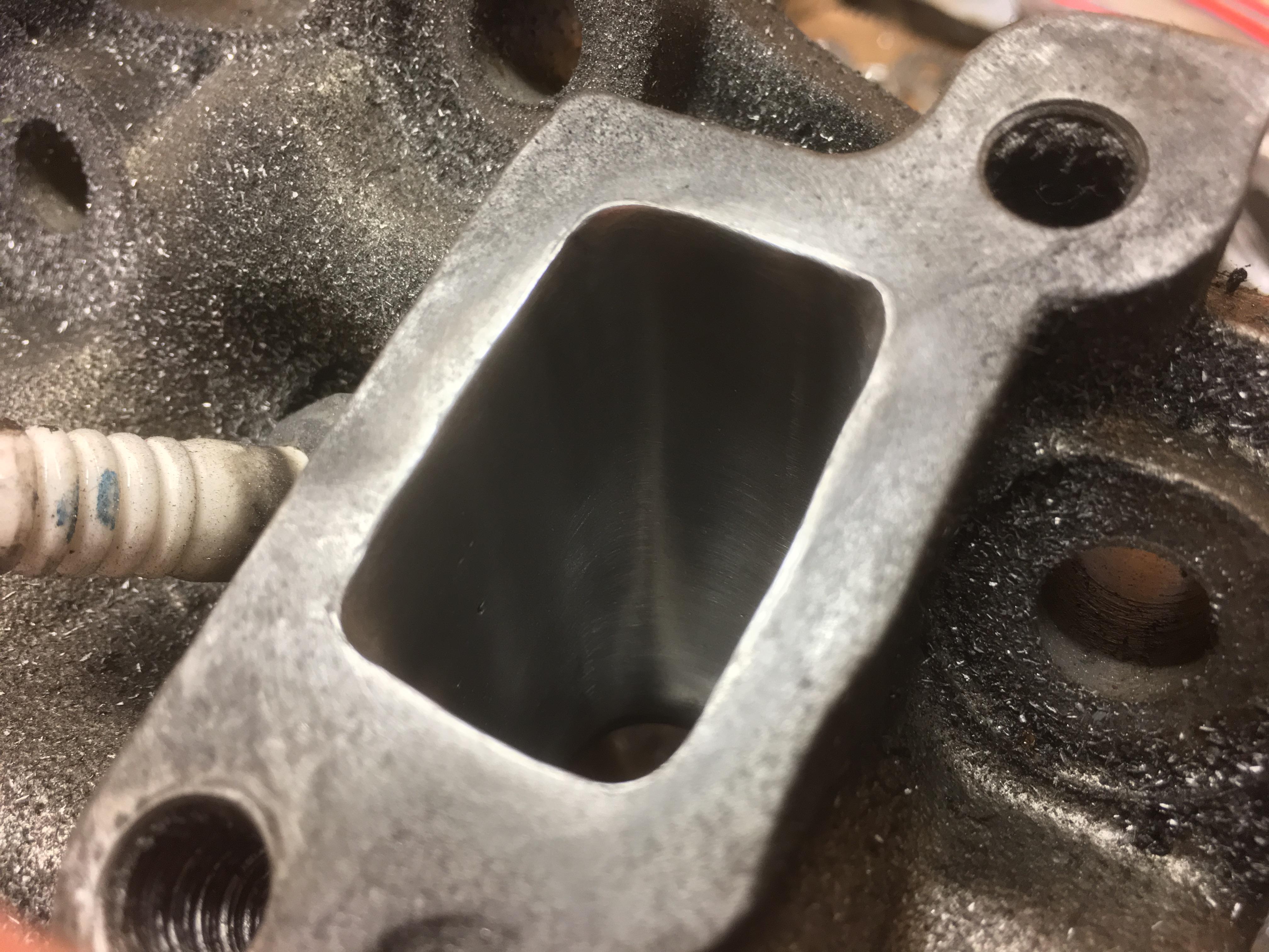

As you can see with the standard casting the ports aren’t even straight and are miles too small compared to the gasket. These have now been opened right out and gasket matched. The fact this engine produces 200 hp above standard with the heads as they are is quite surprising.
This is the start of the porting process.

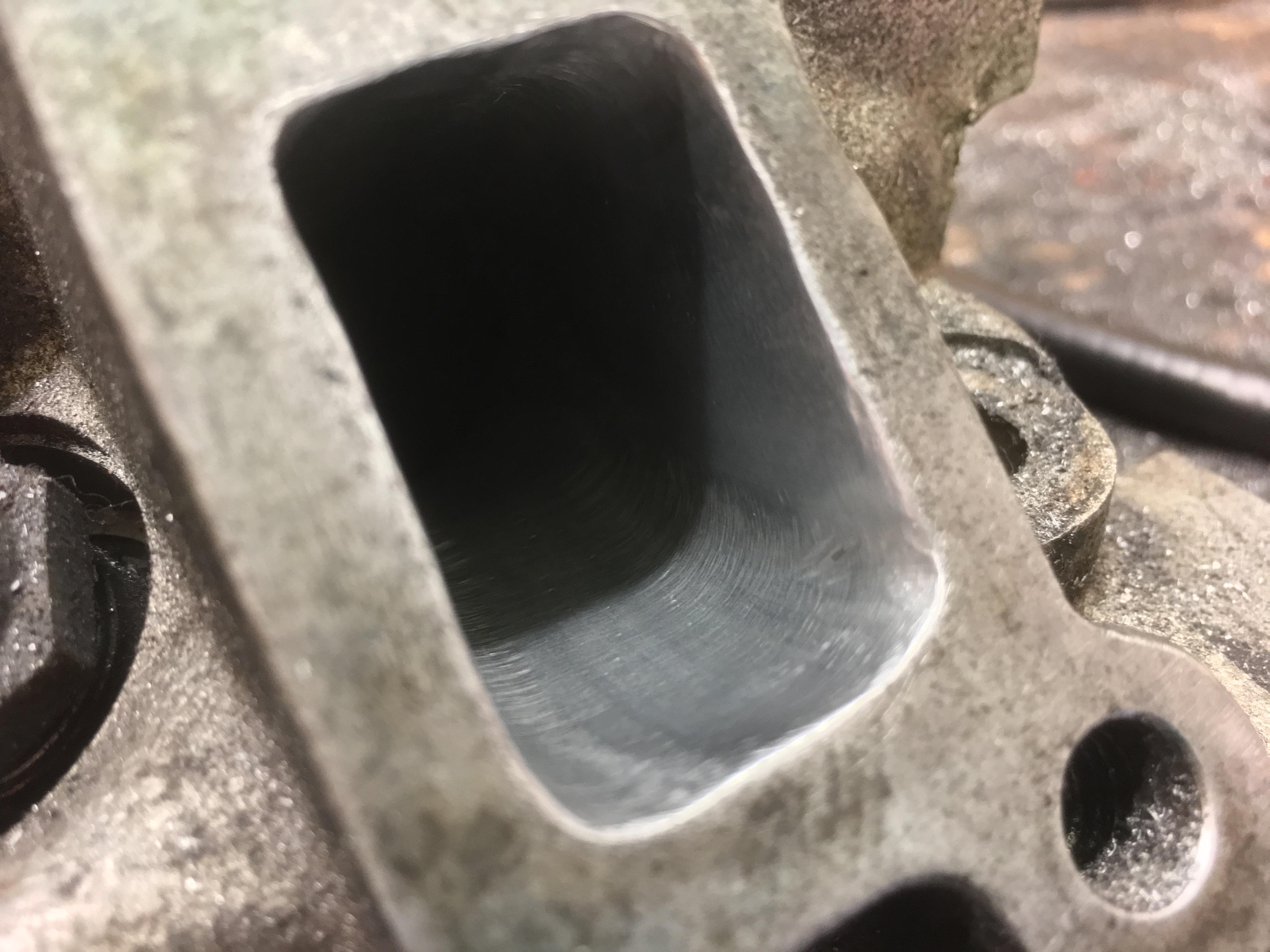

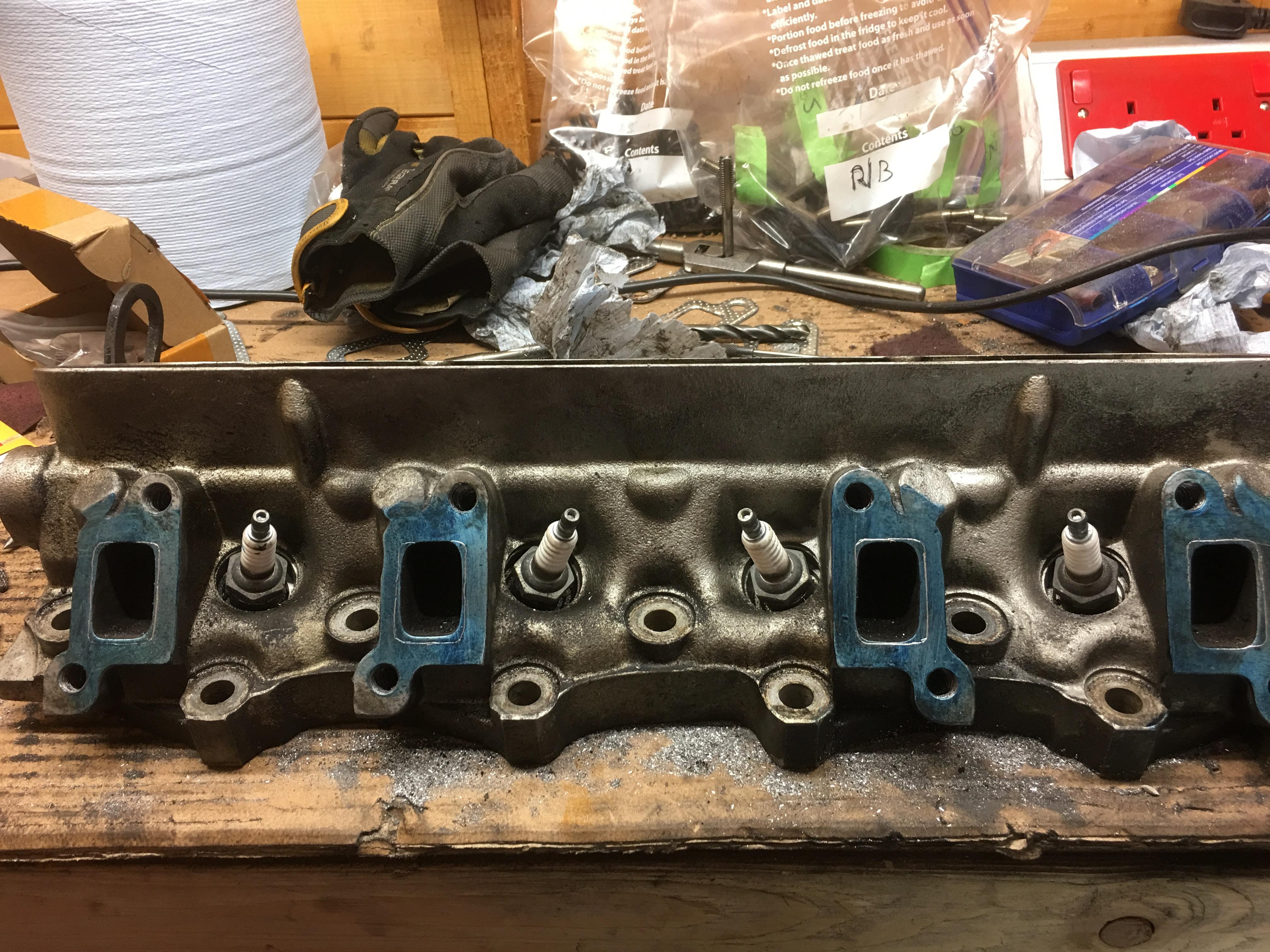

The first picture is a 120 grit sand and the second is an 80 grit buff. I’m around 10 hours in and I have both heads at this stage. I will get all 8 exhaust ports to 150 grit before fully decoking the head and starting work on the combustion chamber. By which time I should have the inlet manifold gasket and that can be ported. After that it’s a case of buff everything and highly polish the exhaust ports and combustion chambers. Still a long way to go.

Cheers plenty more to do. I’m currently over 15 hours in and I’ve still got to buff the exhaust ports to 400 grit then polish them. Clean the carbon out of the ports and buff inside then buff and polish the cylinders and port the intake. Reckon there will be well over 70 hours in this when it’s done

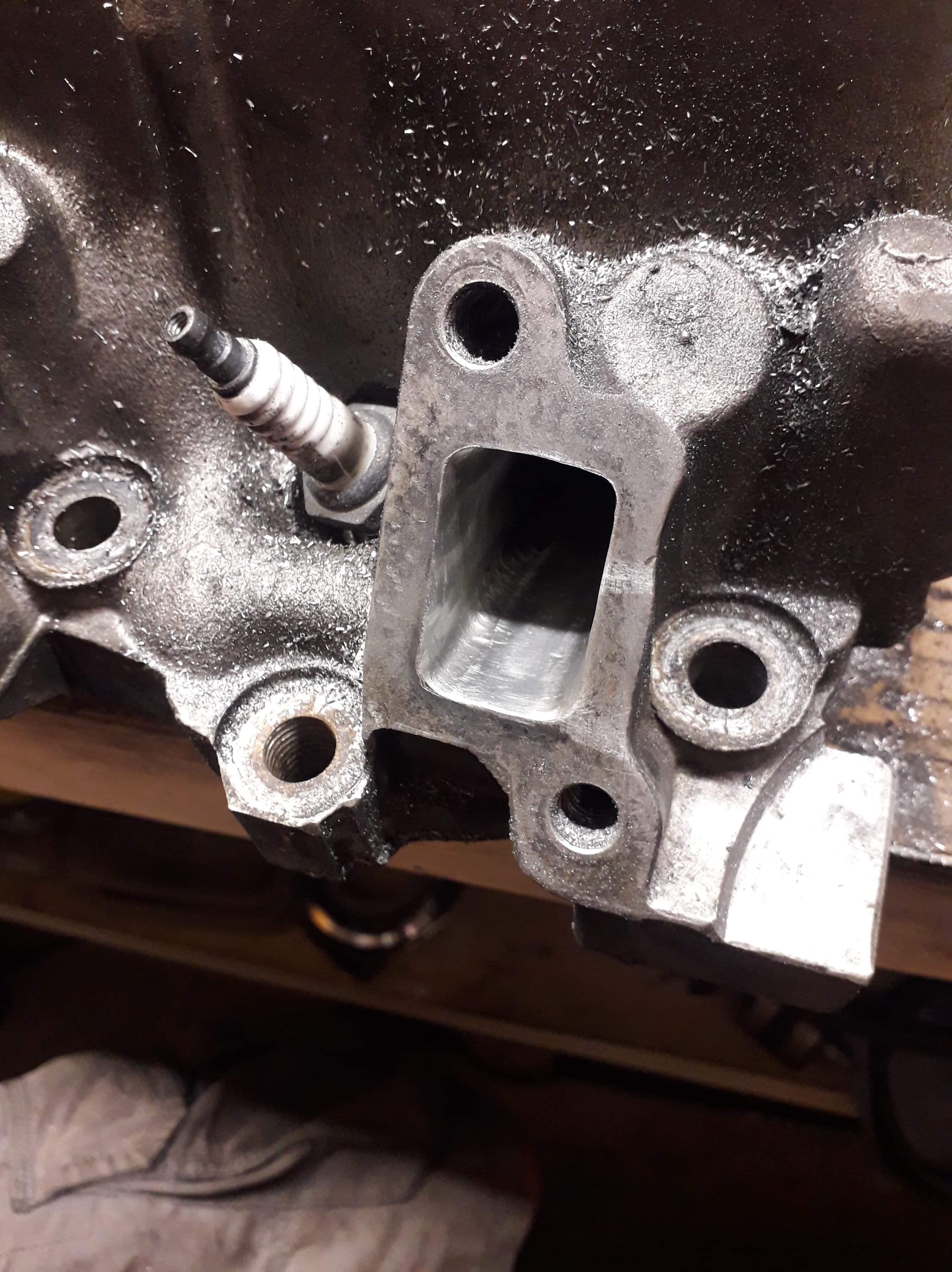

More progress made today. Got some photos of the first head with completed exhaust ports. Polishing four exhaust ports has so far taken two hours today, I it’ll be about the same on the second head.
Photos as follows:
1st: 400 grit buff
2nd: final polish
3rd: first polish
Now to start on the second head.

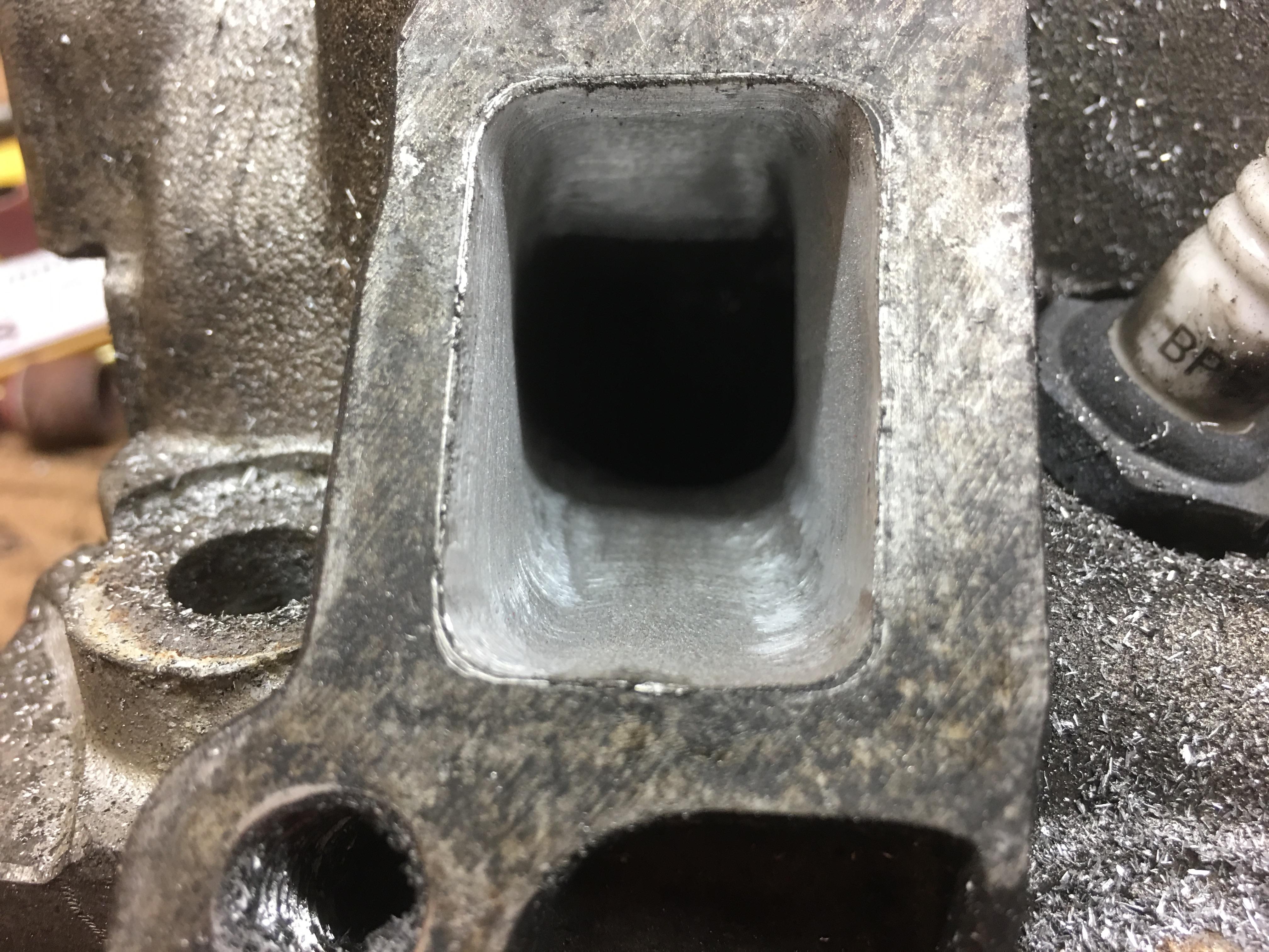

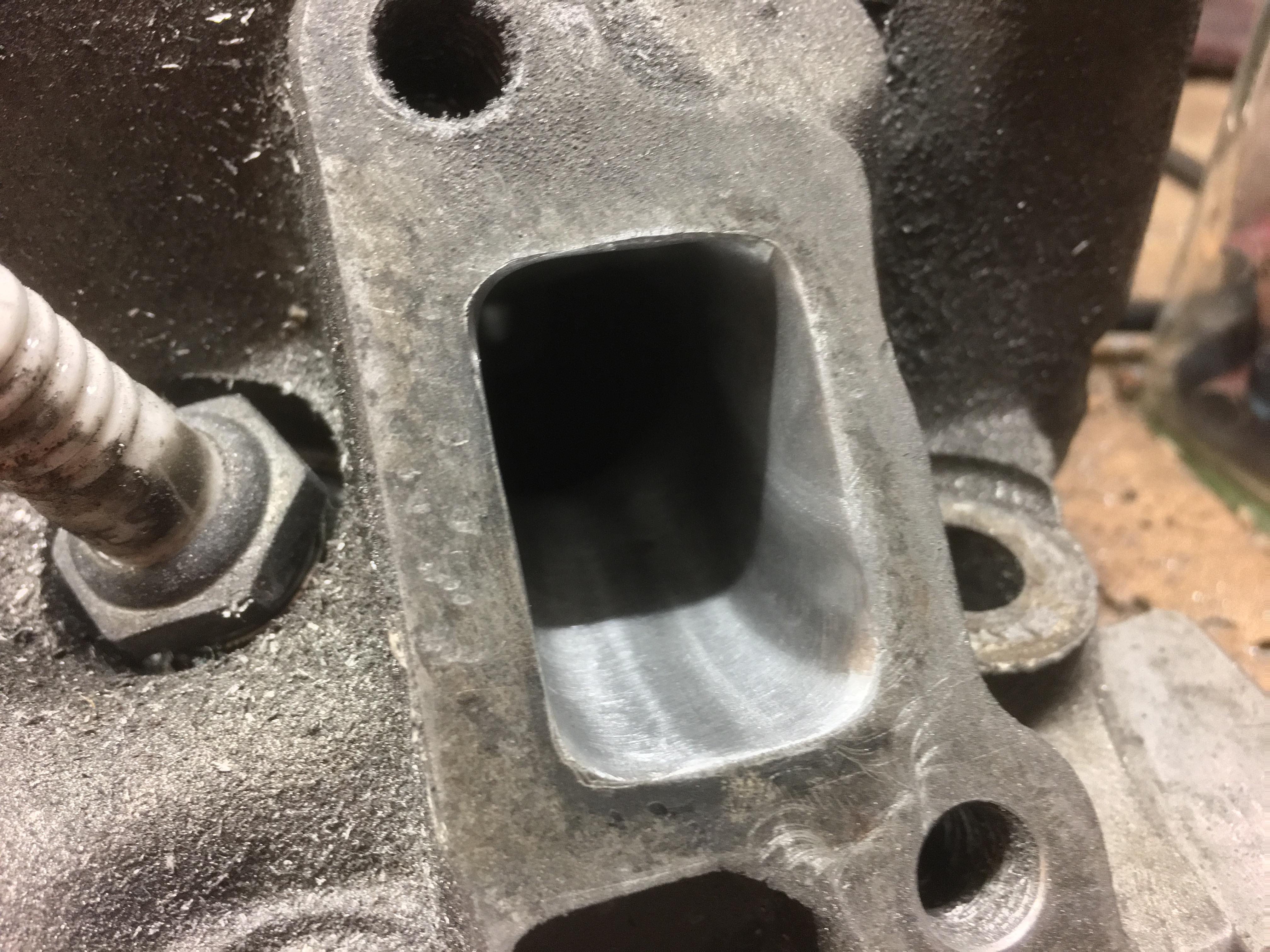

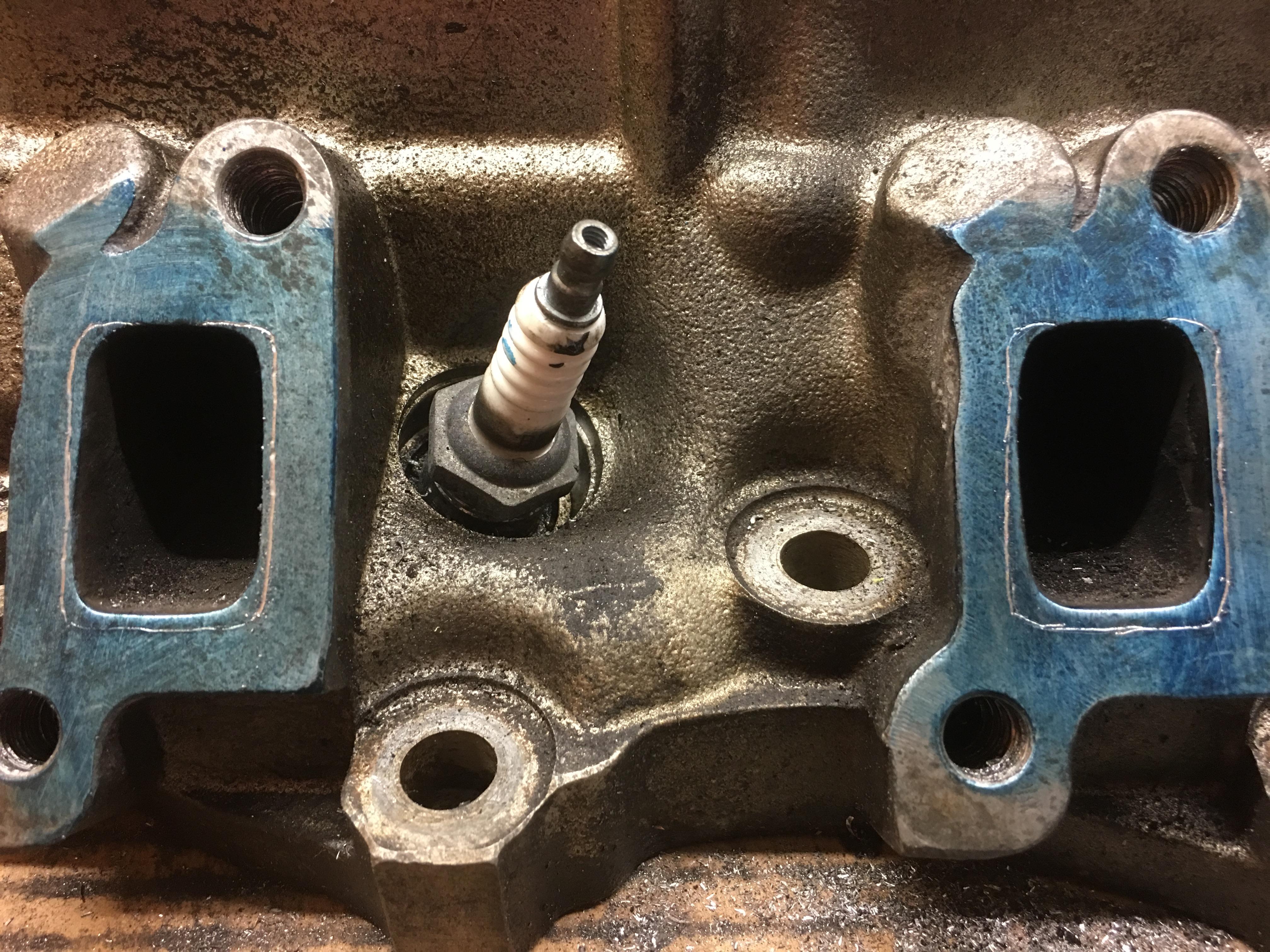

Cleaned one head over the weekend and I have removed the odd bump round the spark plug. Once both are done the tops of the cylinders will be sanded, buffed and finally mirror polished. Currently waiting for the inlet manifold gasket so I can port the intakes before buffing them to a smooth 240 grit finish.
Before.
During.
After.
