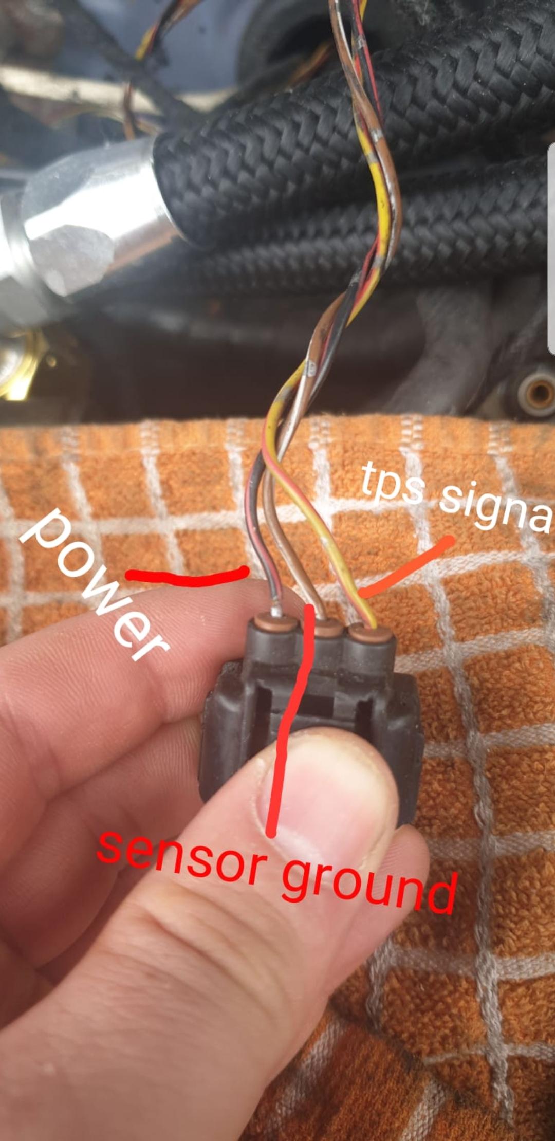

There seems to be lots of info on using the skyline variable TPS except the main thing of what wire goes to what.
Any help on this would be greatly appreciated i have plugs for both the wired piece on the main plug with brand new pins.
Thanks in advance

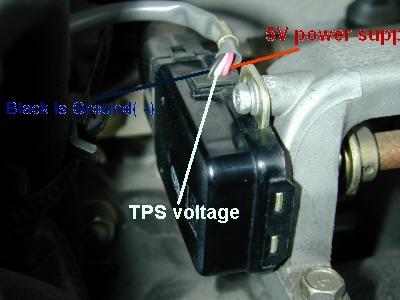

For anyone wanting to do this i believe you use the  wired plug coming from the top of the GTR TPS as shown in the picture. if you are using a glanza loom it should be
Glanza wiring:                                                 SKYLINE R34 GTR TPS
BLACK/RED = POWER              TO                  RED = 5V POWER
BROWN/WHITE = GROUND     TO                 BLACK = SENSOR GROUND
YELLOW/RED = TPS SIGNAL  TO                  WHITE = TPS SIGNAL
I will hopefully confirm this is 100% correct soon
