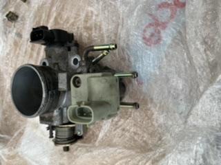

it sounds like you have a split pipe, check the pipes directly under the throttle body they go to your power steering rack. there should be 2x pipes. one goes to a pipe that's port is pre throttle flap this 1 should not affect idle the other connects to a pipe that's port is after/post throttle flap this is the culprit and will cause this issue you are explaining.
there are 2x other pipes on the under side also these are coolant pipes to heat up the throttle to lean out the intake air density to achieve better mpg. you can remove these pipes from the throttle body and join them together using a joining pipe this does give performance gains. the throttle body operates at thermostatic temp 89deg you can imagine the affect on the incoming air charge. after a run pop the bonnet and try to place your hand on the throttle body WARNING!!! its hot.

Which hoses are the one’s to change? For a vac leak?
the 2x pipes directly under the throttle position sensor, off center of the throttle body (on the left hand side 1x right angled pipe and 1x pipe at a 45deg angle off the throttle body)
after you have refit the throttle body, do a blink code read out and see what fault codes if any are stored. you reset this by removing the efi fuse in the engine bay fuse board.

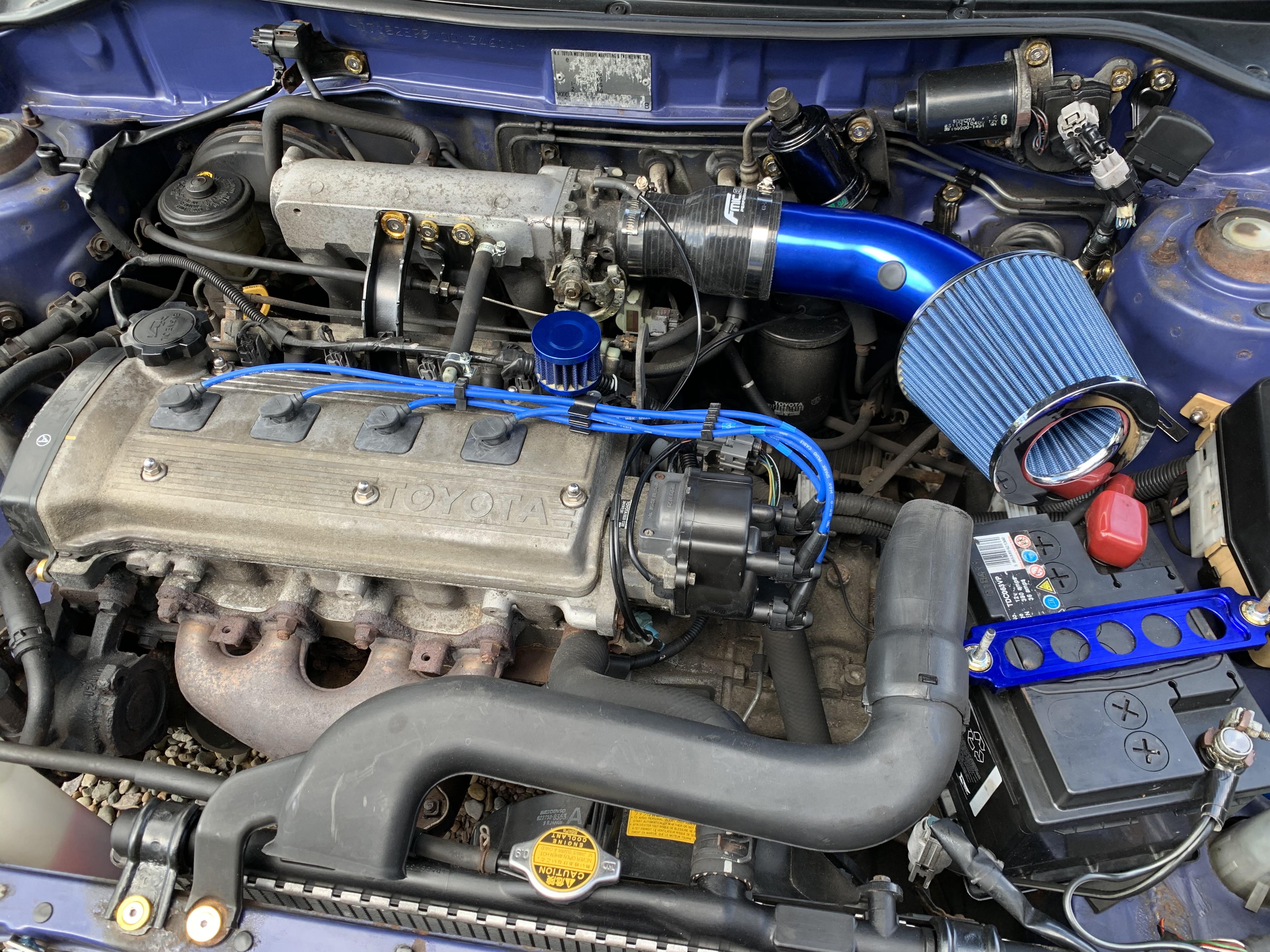

thanks for all the good advice I’m learning heaps Rik
looking smart. very neat work

on the pipes on the throttle body there is only 2 to replace the air lines. these are on the far side of the underside of the throttle body that go to the steering rack. ill put up a picture.
