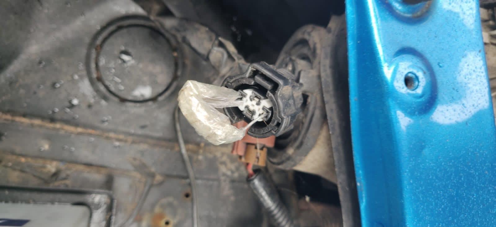

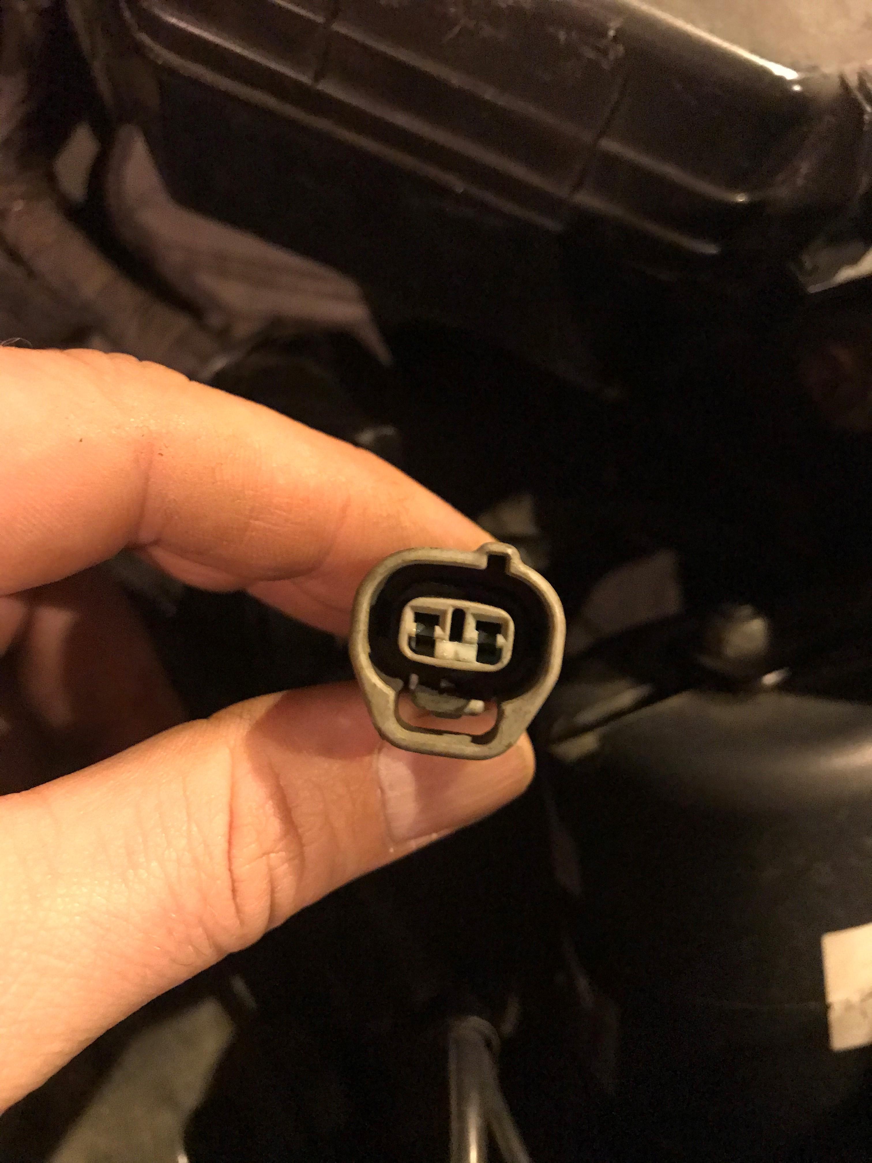

Pikey009 Posted November 4, 2020 Posted November 4, 2020 Hi all. The car is an ep82 GT turbo. Can anyone show me a pic of the AC connector that needs to be bridged in order for the fan not to run constantly. Also, the car has a toad alarm. It's been working fine but today it just wouldn't start. Car battery is brand new, as are the fob batteries in both fobs. the fobs don't seem to talk to the car anymore as pressing the buttons has no effect. I've checked the alarm fuses which are both fine. I am unable to go through the pin system to reset the alarm. Anyone had this issue before? Quote
Pikey009 Posted November 12, 2020 Author Posted November 12, 2020 for anyone's info, 93 GT connector to bridge: Quote
glanzadude Posted January 2, 2021 Posted January 2, 2021 Cut that plug off and just connect the two cables together. That's what I did Quote
Pikey009 Posted January 3, 2021 Author Posted January 3, 2021 Yeah I’ve got myself a decent soldering iron and heat shrink set so once everything’s running how I want, I’ll be tidying all the wiring up 👍 Quote
