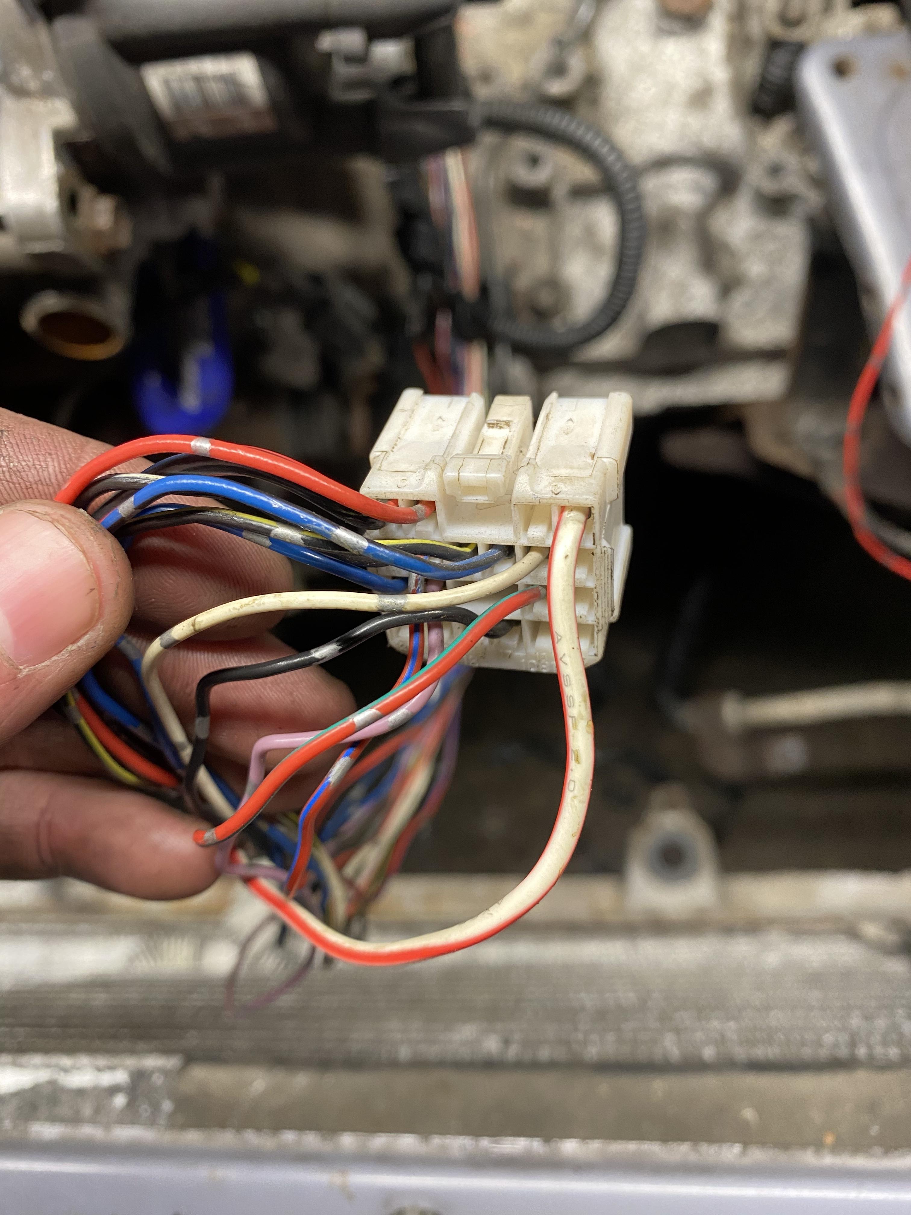

Glanza1991 Posted January 3 Share Posted January 3 Hey lads have a very clean EP95 that I am in the middle of converting to 4efte and need some help from you i have the engine loom in place from the 91 but now have extra plugs that do not line up from the EP91 loom to the EP95 i would like to keep the EP95 dash if possible as it is MINT condition could anyone tell me what way the best way to manage the wiring and will I be running the 2 ECU’s or just the 4efte? will get build thread up soon once I have it up and running 👍 Quote Link to post Share on other sites

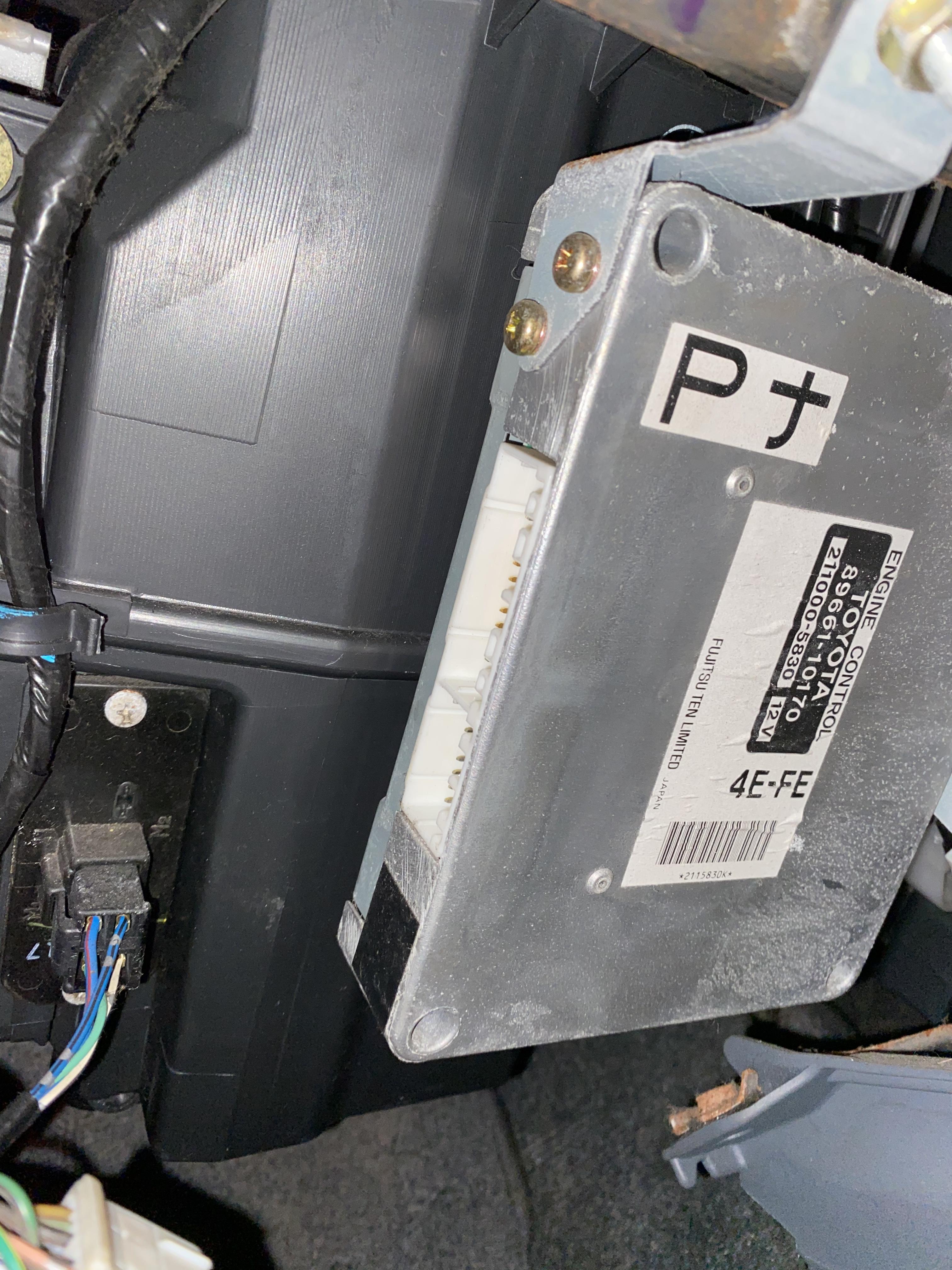

Glanza1991 Posted January 17 Author Share Posted January 17 6 hours ago, daniel_g said: Everything should plug into the turbo ECU. No that can’t work either as my EP95 Ecu has 2 plugs where as the EP91 has 3 🙄 Quote Link to post Share on other sites

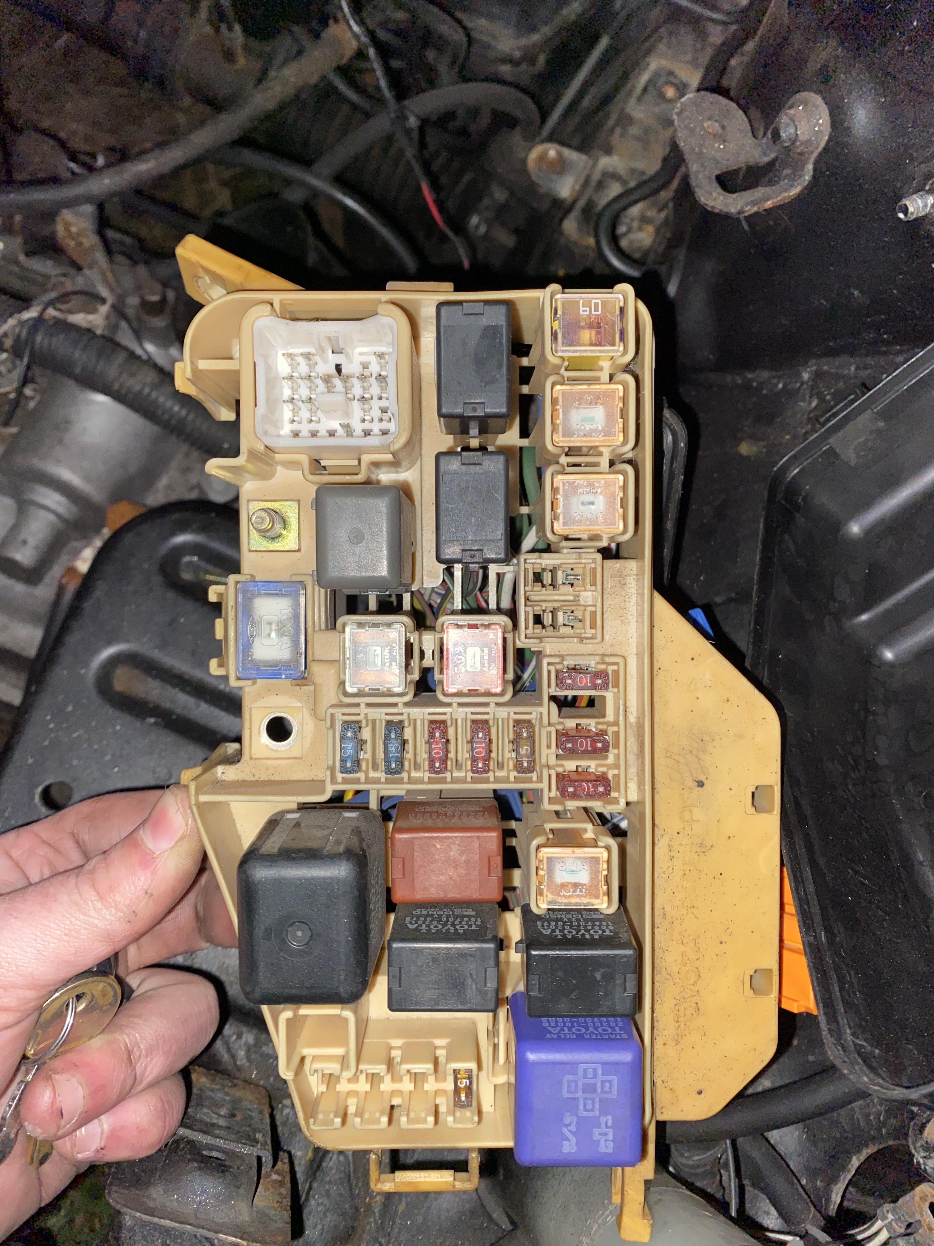

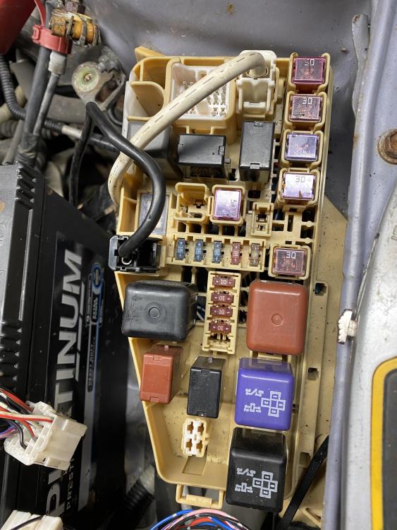

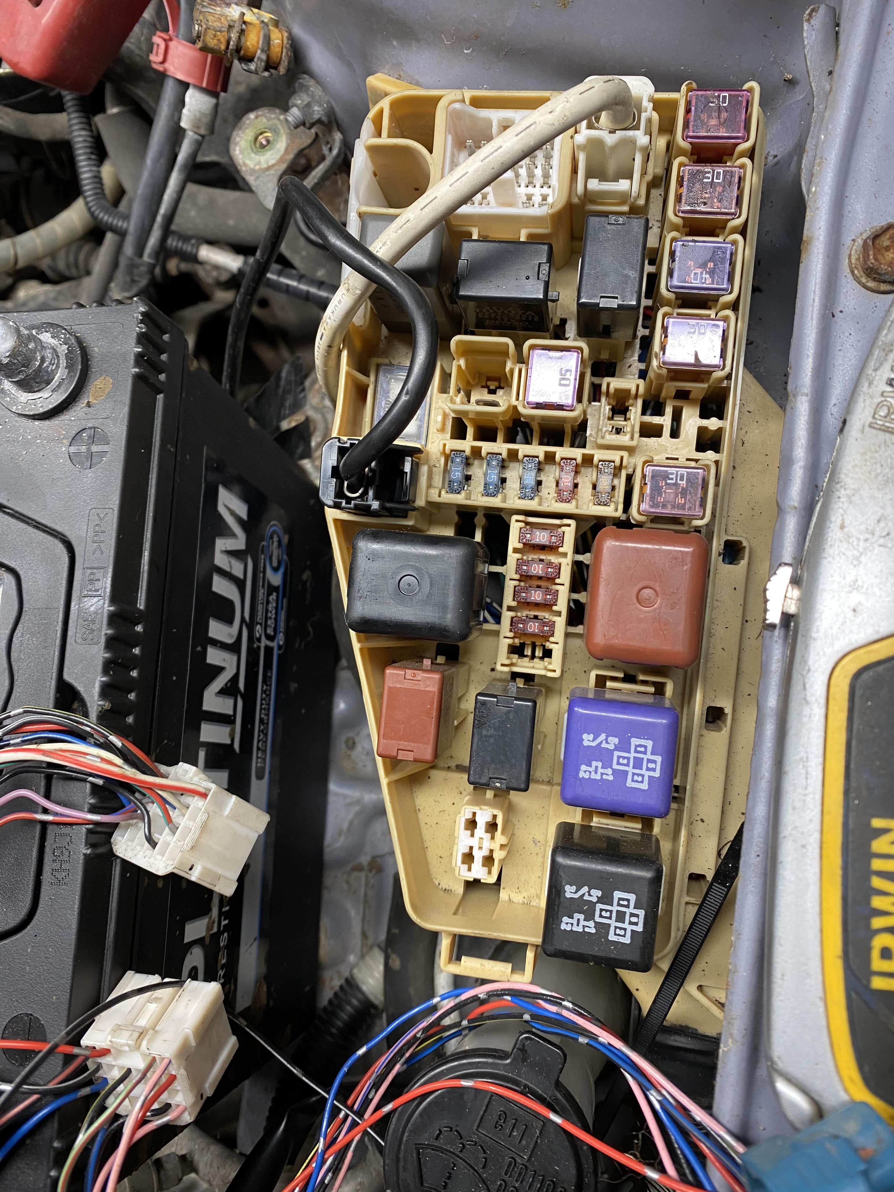

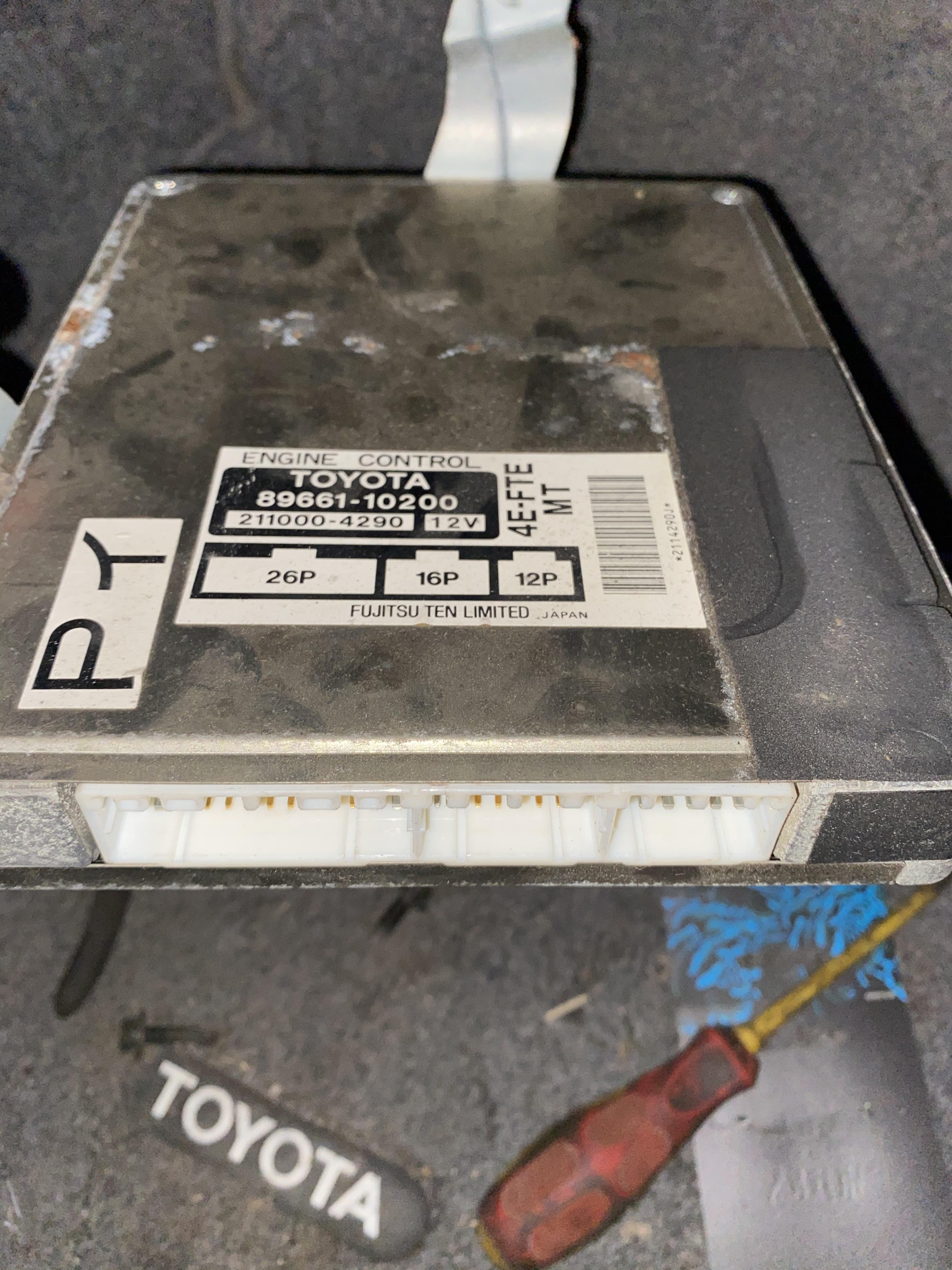

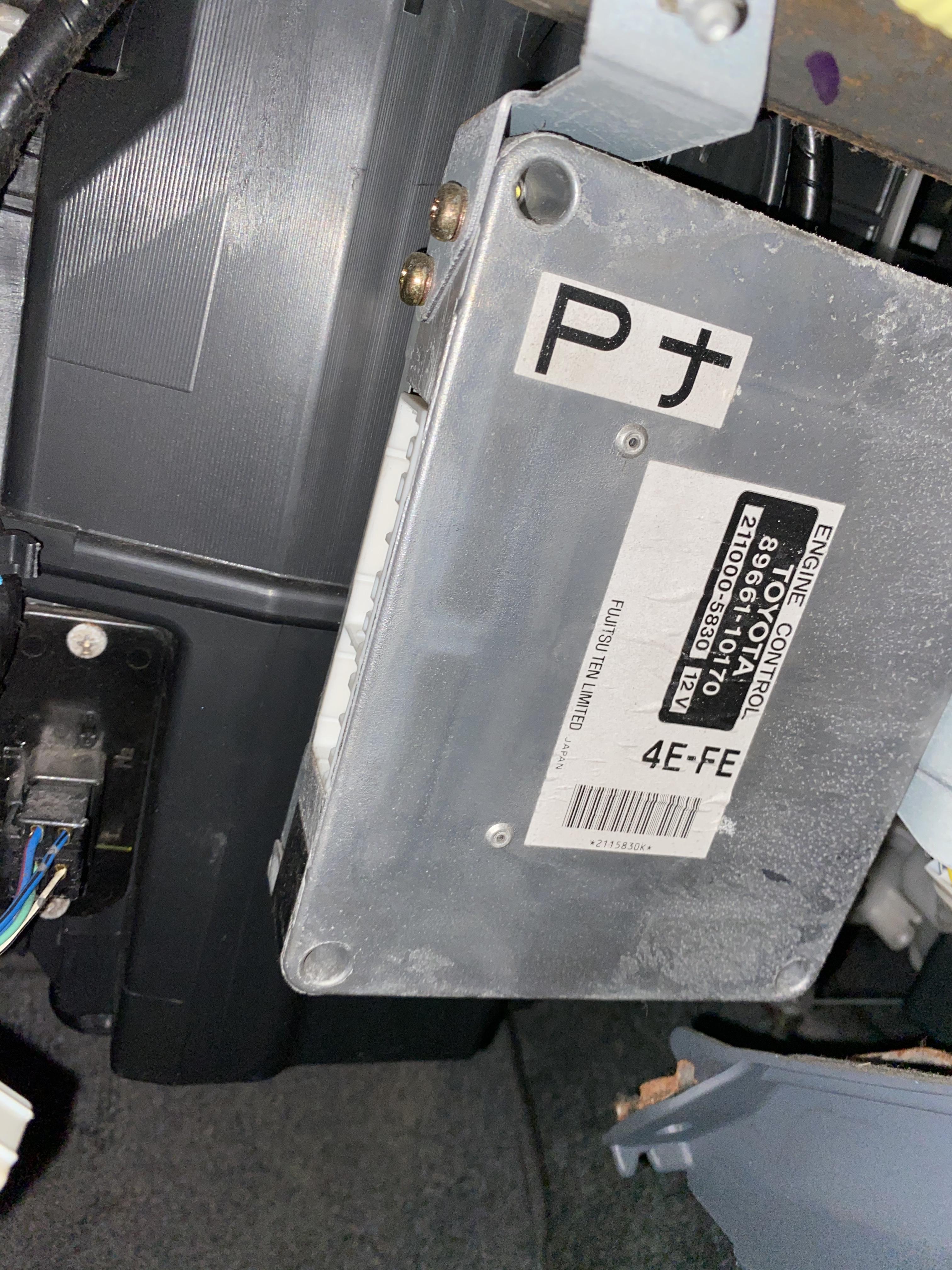

daniel_g Posted January 17 Share Posted January 17 I have only done this on a 82/85. You might need to use the Glanza dash loom and clocks in when doing a 91/95 to keep it all plug and play. Add in some pictures. Quote Link to post Share on other sites

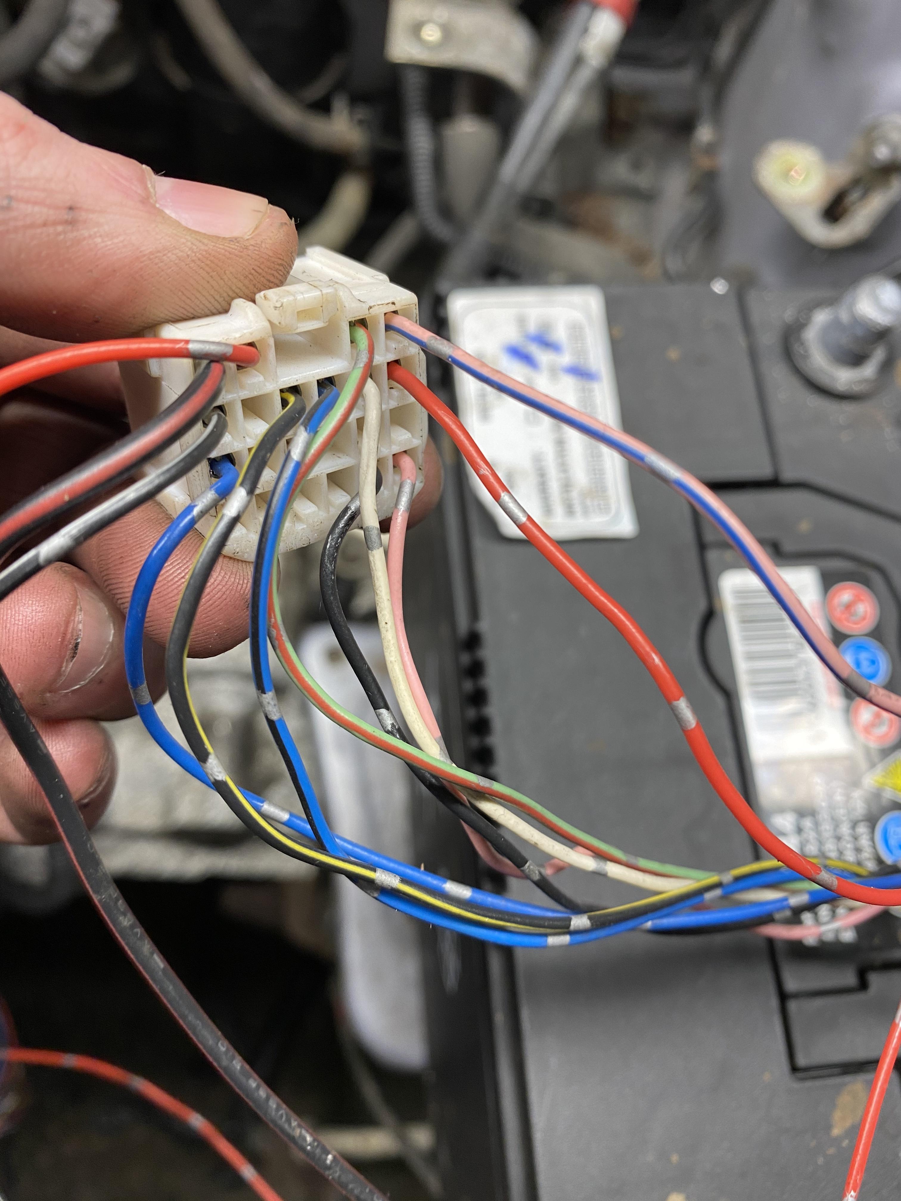

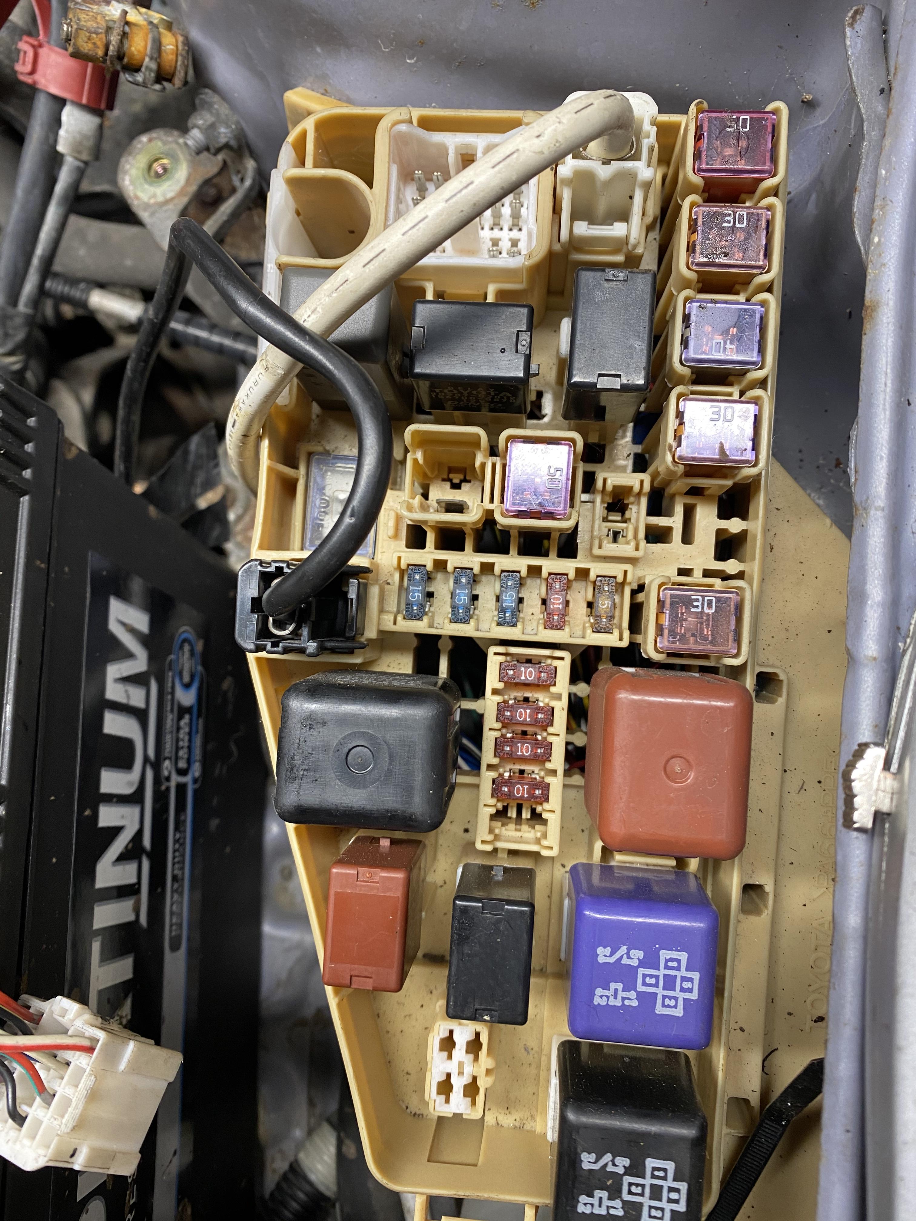

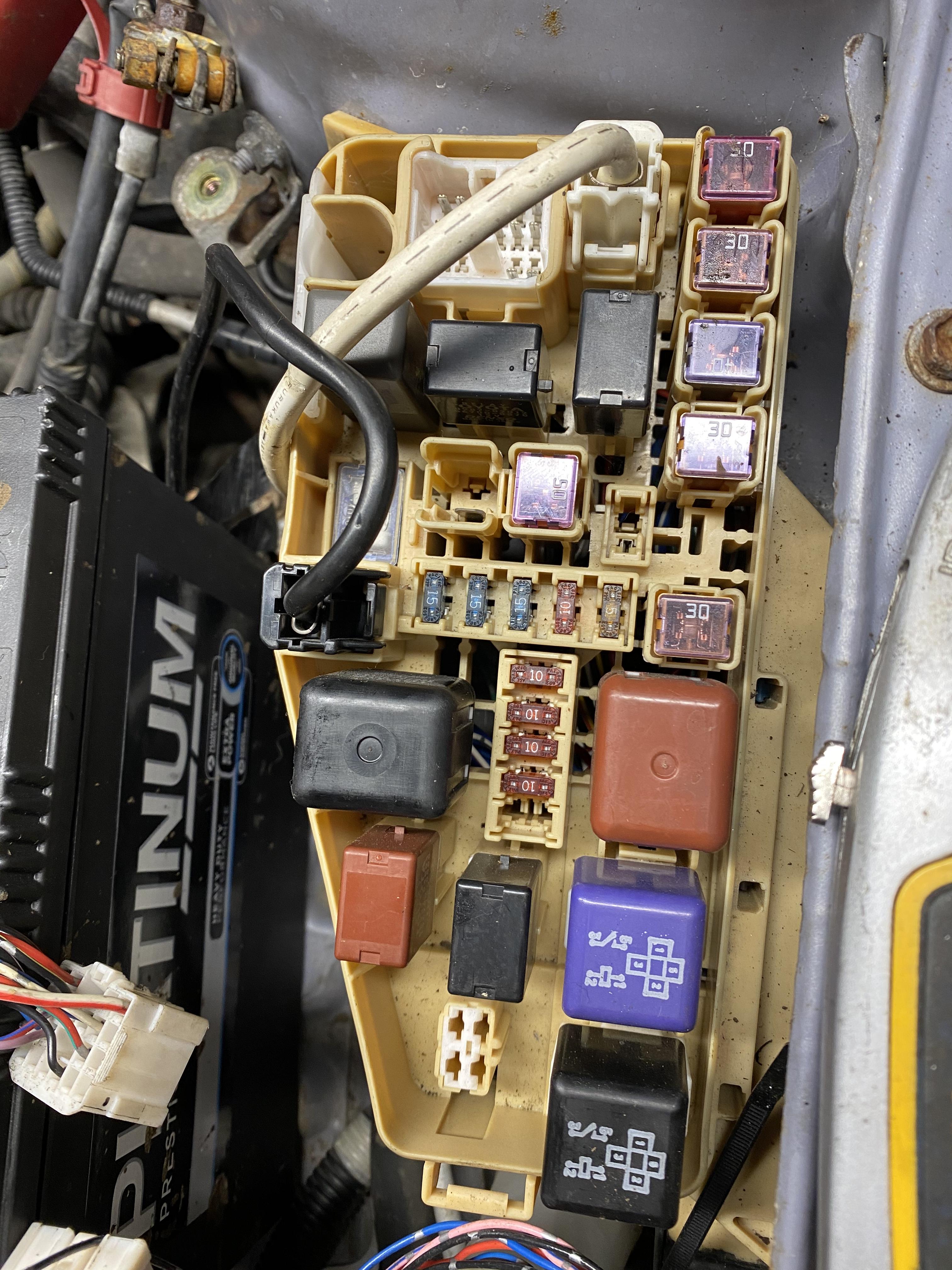

Glanza1991 Posted January 17 Author Share Posted January 17 EP95 pics EP95 Fuse box still in car Quote Link to post Share on other sites

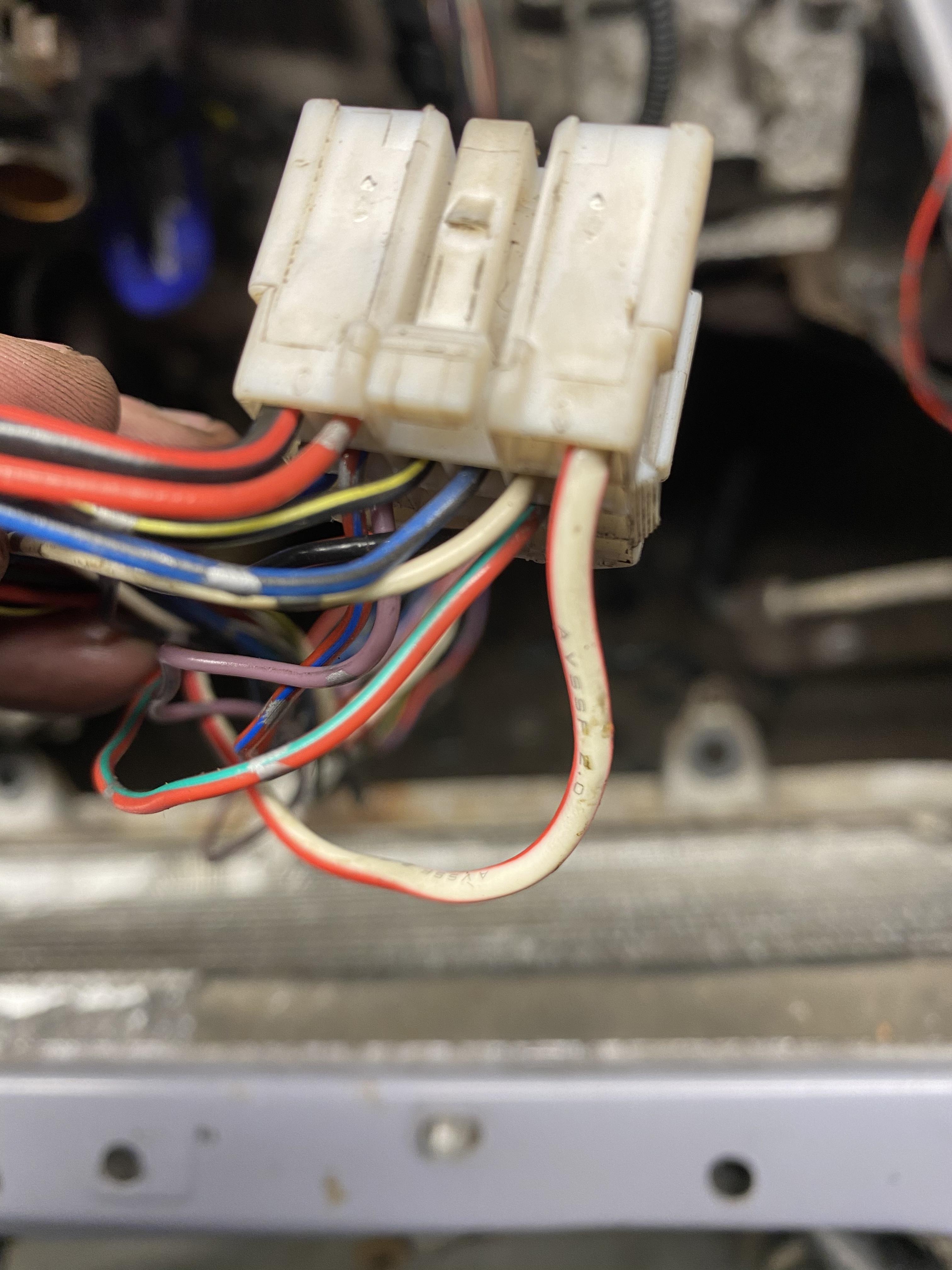

Glanza1991 Posted January 17 Author Share Posted January 17 EP91 Quote Link to post Share on other sites

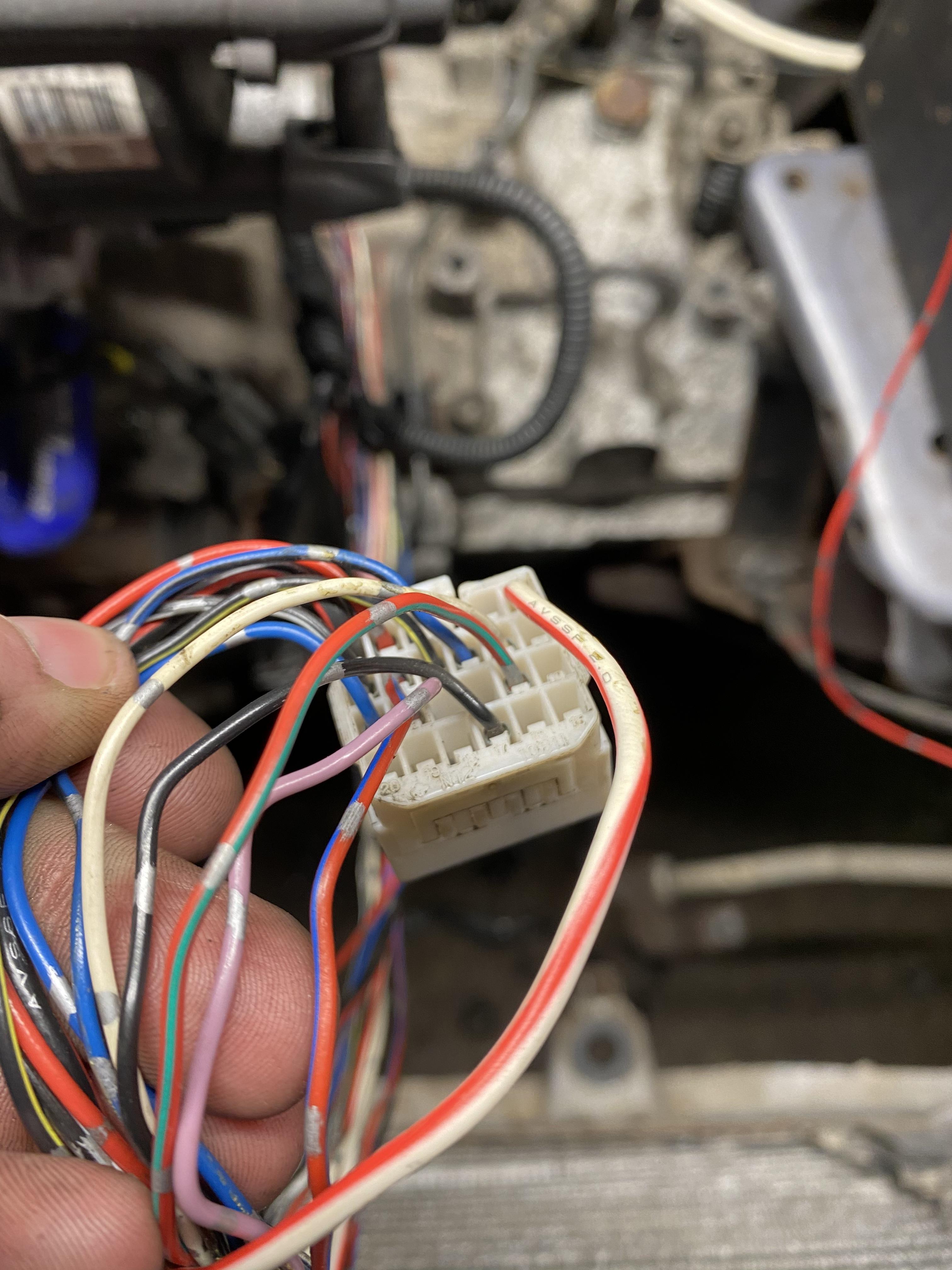

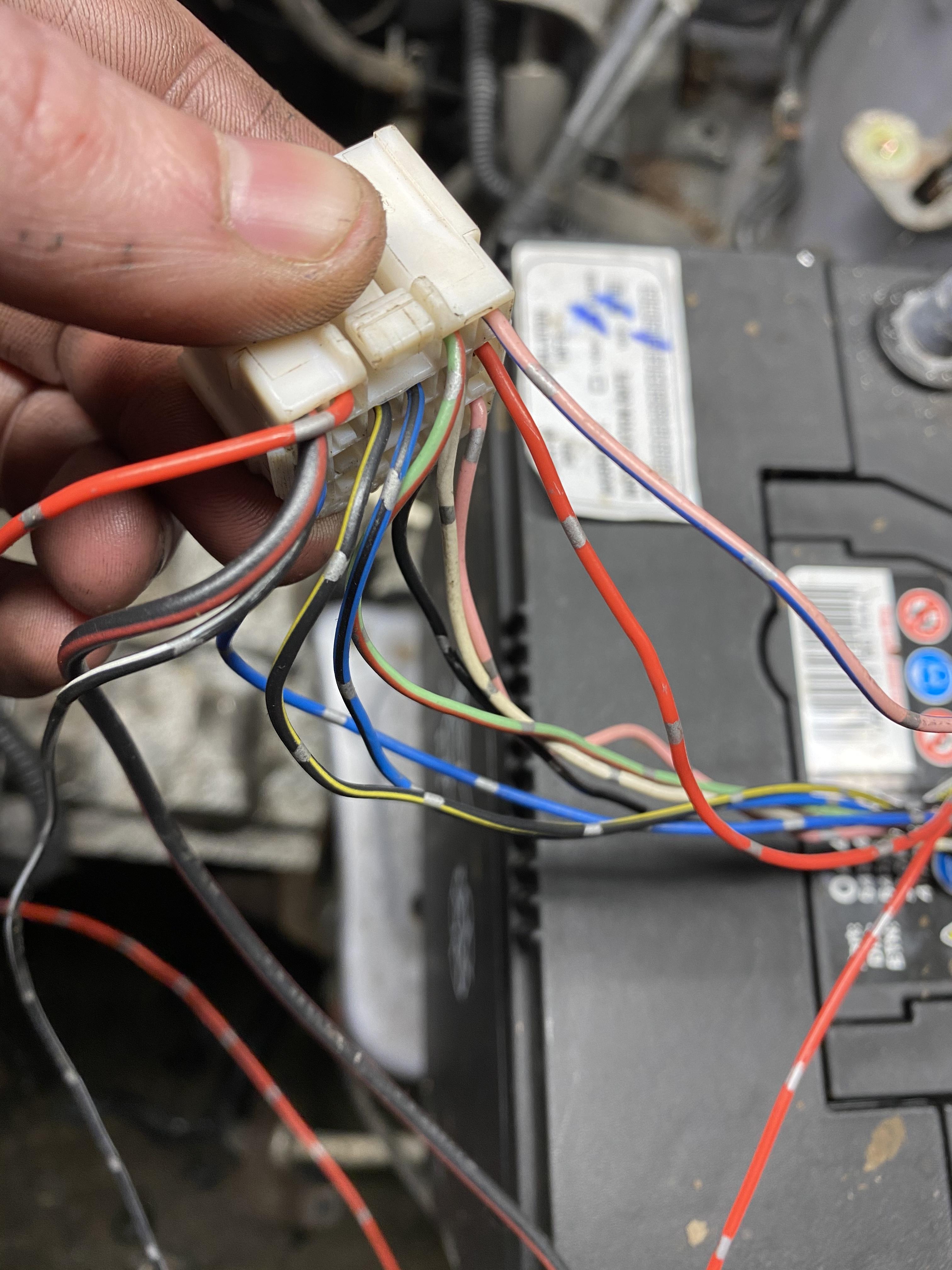

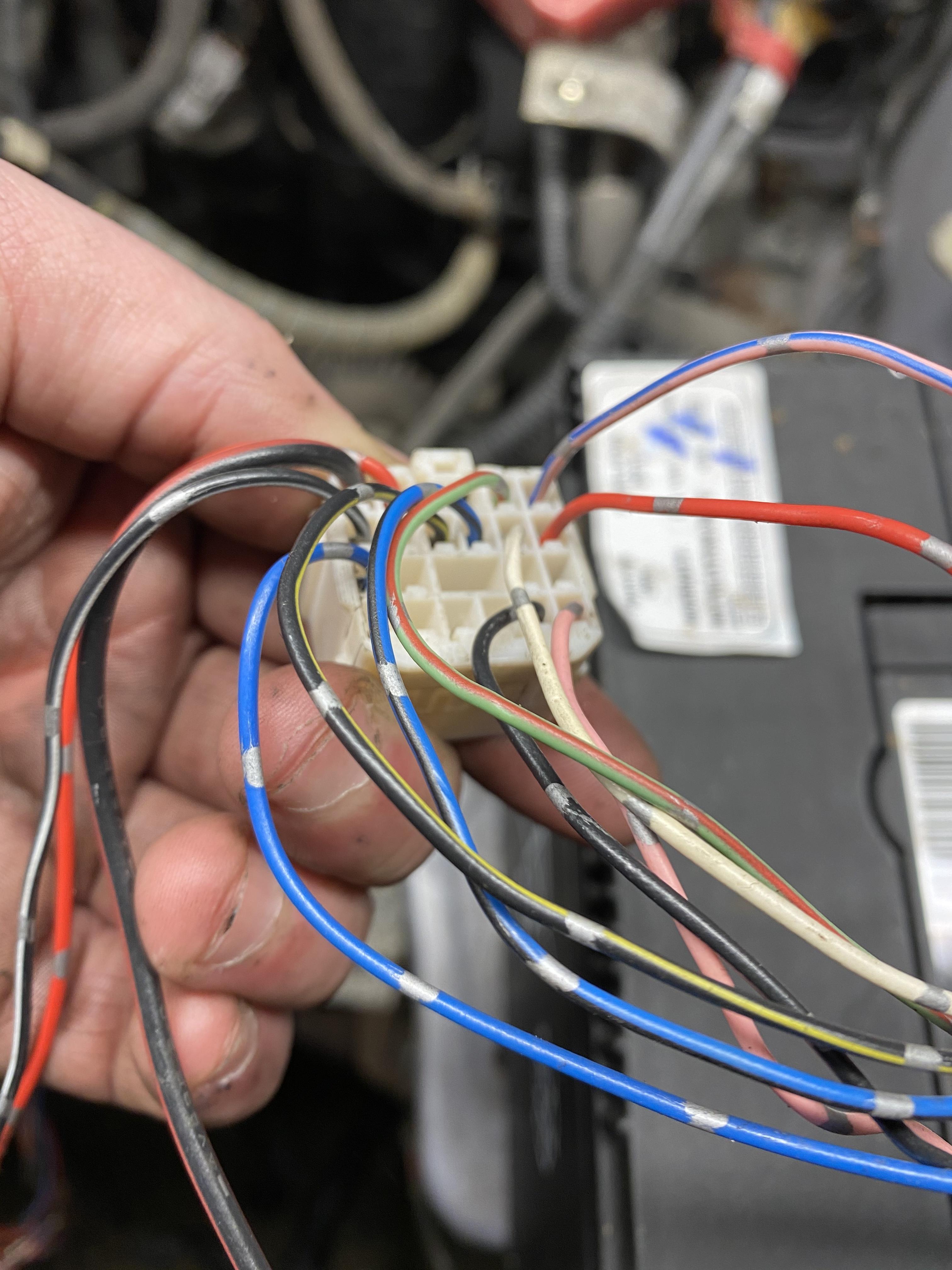

daniel_g Posted January 17 Share Posted January 17 So can you get that loom plugged into the 95 fusebox? Quote Link to post Share on other sites
Glanza1991 Posted January 17 Author Share Posted January 17 (edited) Yeah white plug fits in but wires are all different but down at the ecu the connectors do not match up Edited January 17 by Glanza1991 Quote Link to post Share on other sites
