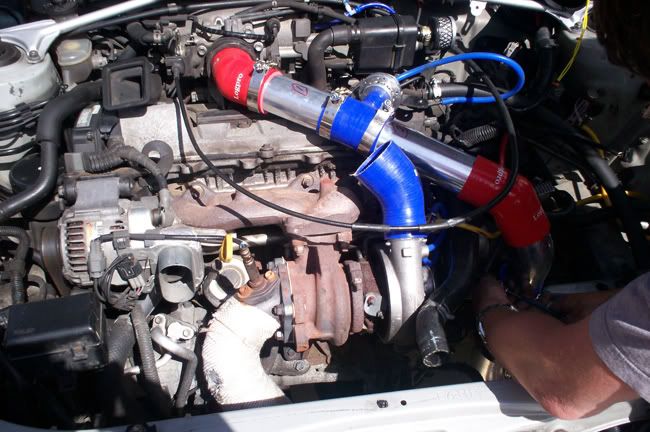

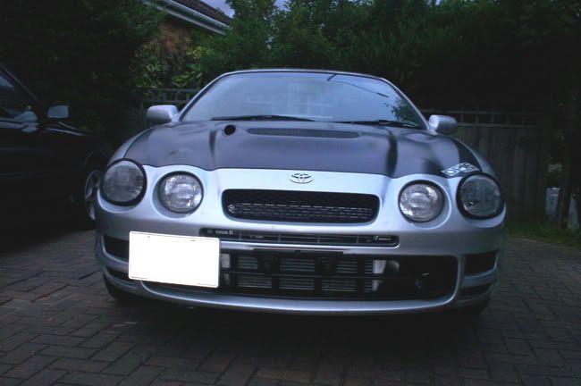

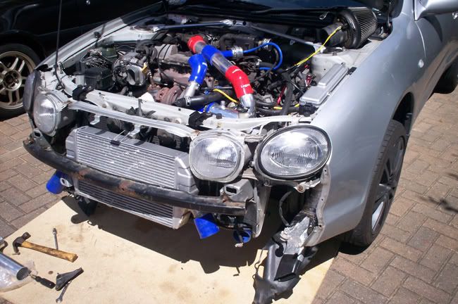

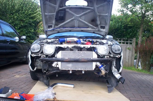

montanajr Posted July 5, 2008 Posted July 5, 2008 So my brother suggests we fit a FMIC to his car, that'll be fairly straightforward riiight?? On a Starlet, what 1.5hrs to fit one? On his, 2 days, 3 people (me, bro, dad) and a lot of swearing and frustration lol. Had to buy a universal kit and cut the shite outta it and use an evo8 core, take charge cooler, pump and rad out, bridge 2 charge cooler sensors, make brackets to hold the IC and just loads of little bits! Took an age!Didn't manage to clock the turbo as the huge circlip holding on the snail was impossible to get off, plus the actuator was round the back behind the mani - how the hell would one get a e-clip on that?! Anyway, few pics, quite chuffed as it works well and pulls like a feckin' train! One problem; his dump valve no longer works even though its plumbed in properly?? Doesn't look too bad eh? I'm welll pleased! Quote
