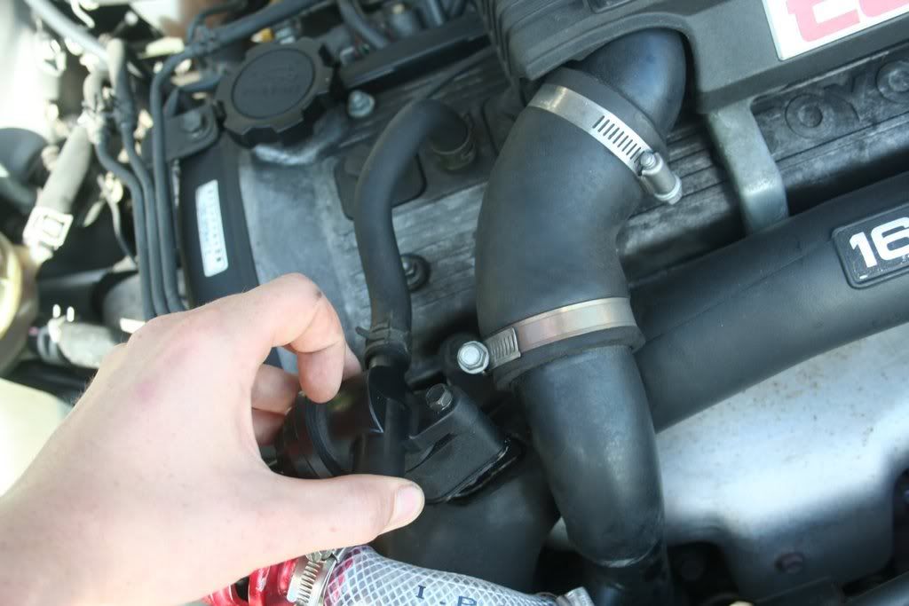

andy.i Posted September 4, 2008 Posted September 4, 2008 fitted the dump valve and went for a spin, came back and this bit had fallen off....?im buying a catcher can for the breather but what can i put over the hole....?ta Quote
andy.i Posted September 4, 2008 Author Posted September 4, 2008 when the catch can arrives mate, can i just take it off all together and plug up the hole? (so to speak) Quote
Hairy1 Posted September 4, 2008 Posted September 4, 2008 in the short term cable tie then epoxy around it ,but even this wont last long -good excuse to get shot of it!where the pipe comes out of the rocker cover replace with a breather-about £7 from your local motorfactor halfrauds etc.replace efi pipe with pipe and filter strait off the turbo mounted behind radiator (asuming u dont have A/C) then throw the rest in a skip.....job done. Quote
andy.i Posted September 4, 2008 Author Posted September 4, 2008 oh gawd dammit why does everything i do turn into a mission will duct tape it on in a moim sure i saw something like a plate tho that blanked it off?like this? Quote
StarletRick Posted September 4, 2008 Posted September 4, 2008 yaeh thats if it isnt broken, your one has actaully snapped off. ideally you need another one. but in the interim you need to block that hole off. Quote
andy.i Posted September 4, 2008 Author Posted September 4, 2008 just zip tied it on and will nap some apoxy from work later.next question.......anyone got pipe from the turbo for sale Quote
Hairy1 Posted September 4, 2008 Posted September 4, 2008 be sure and get rid of that pipe that comes from the rocker cover mate, the turbo sucks up the cruddy old oil through it -doesent do your turbo or emmissions any good....wip it off and have a look inside. Quote
andy.i Posted September 5, 2008 Author Posted September 5, 2008 catcher can should be here today mate, putting that on.gonna make a plug at work on the lathe and put that in the hole as a temp fix Quote

andy.i Posted September 6, 2008 Author Posted September 6, 2008 put the catcher can on, put just zip tied at the mo, will make a bracket at work on mondaymade a butt plug sort of thing on the lathe and it fitted perfectly with some zip ties over the top ;)will put the new pipe on when i get it from jules-bthanks for your help! Quote
