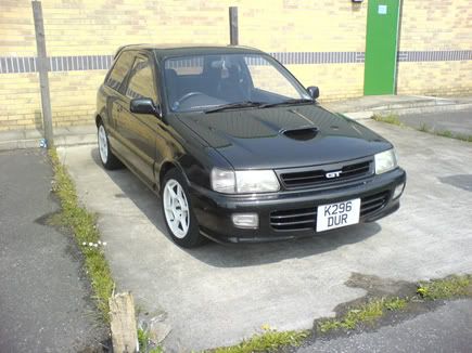

Well after being on the site for a while now I thought it was about time I showed the car to people who haven't seen in the flesh!
So here we are my 93 K ep82 turbo��

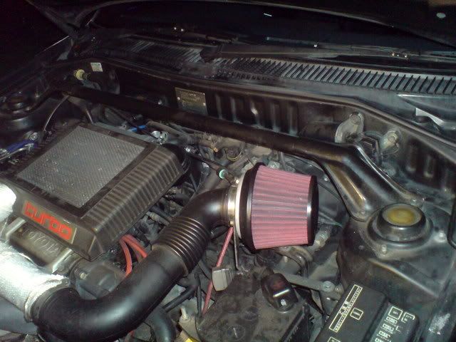

hks actuator Running just under Fuel cut
Apexi Filter

Awesome to drive but spun up as soon as it hit 3000rpm which was a hassle to drive really, After meeting GoldenVtr (Dan) and seeing the setup he was running I sort of made my mind up about the route of power I was going to follow(TD04) as the powerband seemed in a much better place for the way I drive.

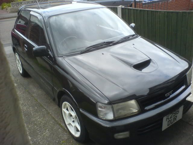

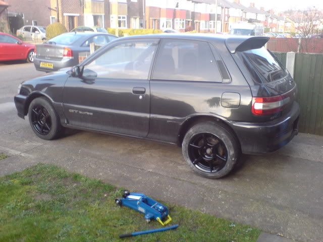

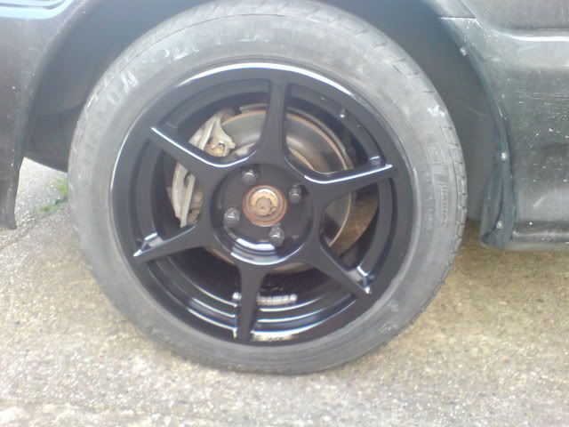

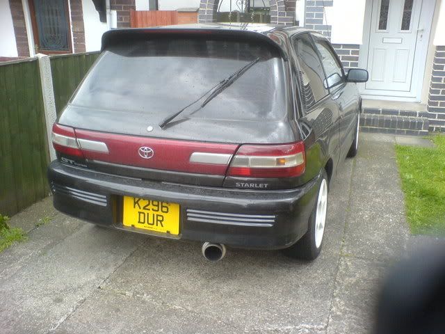

I kept seeing Black Ep's with white wheels and thought crap they all look the same so out came the sandpaper and paint 4 hours later.
Had an experiment with the bonnet for several months
I then spent a fortune and had some of the paint rectified roof etc that were a little rough...

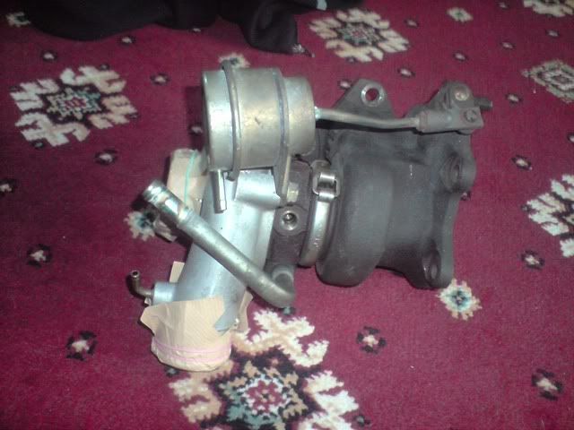

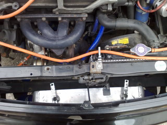

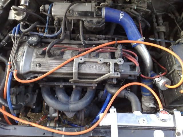

After a while on the ct9 it started to smoke intermittently on idle (turbo seals) and the Manifold had cracked all the way through on cylinder 3! Welder out for the temp fix sorted the crack and put up with the smokeâ?¦It's a daily drive and family car for me my wife kid and dog so taking it off the road was a big no. I started sourcing parts from people off the site and off scoobynet and the TD04 collection had begun!
All in all I spent the Grand total of £513 on everything to convert my car to TD04 power including attachment of the old exhaust to the new downpipe and all intercooler parts .
Turbo Source had 16k miles on it
Bracket made by Rob Bower

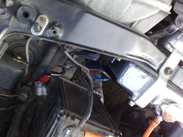

I bought an Apexi Neo fuel computer ages before with wiring harness off Toby and fitted this..(Still not setup lol)

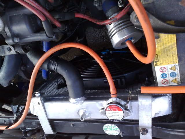

2 Days later and a new radiator
Removing air con must have been the most time consuming part.

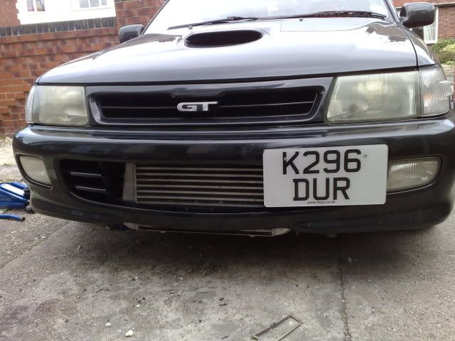

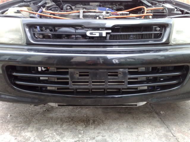

I was running with the intercooler 4inches from the ground
so today I raised the intercooler and cut the front bumper out etc
Thanks go to Rob Bower for his fabricating skills on the actuator bracket and forgetting to tighten the oil pipes later onâ?¦.lolâ?¦ Which blew the oil all over the A57. Fixed next day after a tow home.
Next on the cards is boost control and a proper setup on the rollers with 1 bar etc

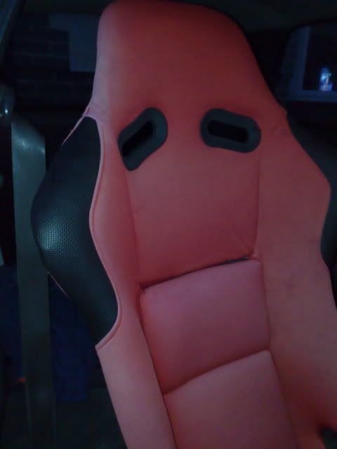

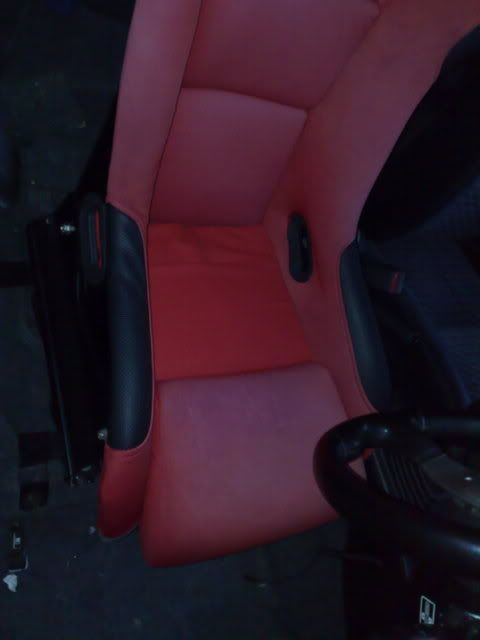

Thanks to the wife's (starbozo) new car and coming with a Bride bucket Seat and Rail (Also the fact that her dad don't fit in it lol and he needs to use the car ) I got my hands on a new seat...
It is very faded so I re-died it but it didn't take as well as I hoped!
And before anyone asks why the bit under my ass looks different its because the original bit was sooooo thin it was like sitting on the concrete and I needed a little comfort...so made a new piece up. Its a little thin also so I'm very snug lol the people that know me will understand I'm not little lol.

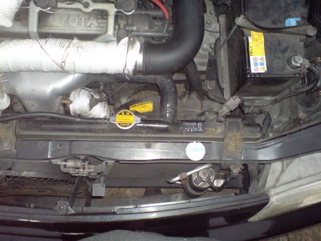

On Friday we had a trip out and the car overheated spat the water all over the road! The AA man said it would be a suspected headgasket?? Yeah right. So I got home and replaced the thermostat and put my new radiator on
Ran it up to temperature and then noticed water all over the gearbox! Turns out the rubber pipe which goes from the thermostat housing to the water pump under the inlet manifold was leaking really bad which had caused the problemâ?¦ I hope.. it took all day for that diagnosis! Now the pipe is now fixed thankfully and the car is back on the road keeping an eye on temps we are going to take it out tomorrow to check for any failures. :lol:

Looks good mate :blink:
But I prefer the white alloys to the black.
everyone has their own opinion but every black GT in this area has white wheels and I like to be different... Also I think it looks more like the track slag its working to be.

ps that seat looks the bizness, must help with driving.
