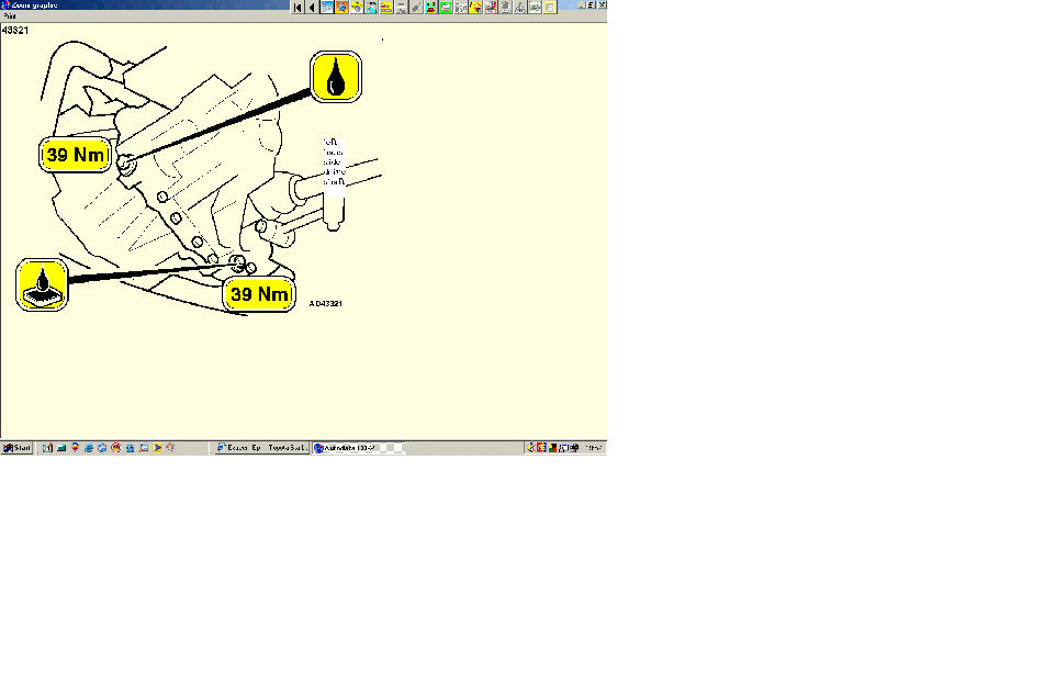

Ep91 Posted September 26, 2005 Author Posted September 26, 2005 I dont supose it would be too much to ask for a picture?Theres lots or bolts and things on the gearbox... i dont wanna undo the wrong thing!Cheers mate. Quote

starletboy Posted September 26, 2005 Posted September 26, 2005 if you are under the car on the front of the gearbox about half way up in the middle you will see a 10m allen key bolt remove that one to top it up if you want to change the whole gearbox oil at the bottom next to driveshaft on the right their is a 24m bolt undo that to drain it all out remember to put it back in before you fill it up and fill it up on the allen key bolt till it comes out of the hole then job done hope that helps mate!!!!! :Dit is manual isnt it other wise its a bit different for an auto!!!!!!!!! Quote
rmsnoel Posted September 26, 2005 Posted September 26, 2005 Got this pic off a service manual CD. Hope it help's Quote

Ep91 Posted September 26, 2005 Author Posted September 26, 2005 75w-90w Rich...cheers rmsnoel your a star! Quote
