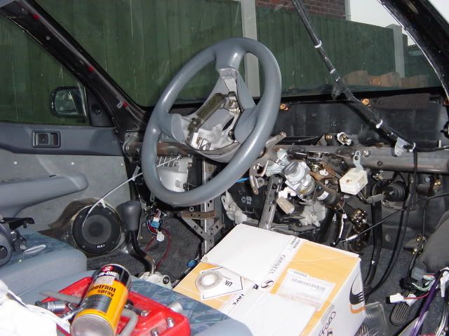

Starlet Nath Posted August 21, 2006 Posted August 21, 2006 Here is a piture of an EP91 with the dash removed.The heater matrix is in the middle(the blackyou can see just under the steering wheel. I have some better ones at home but they are not on PhotobucketHere's a picture of the other end as it come into the engine bay, its the two pipes coming through just under the fuel filterHope this helps and doesn't scare you too much!!!But it is a dash out jobNath Quote

prangers Posted August 21, 2006 Author Posted August 21, 2006 there is no way im trying that myself lmao Quote
