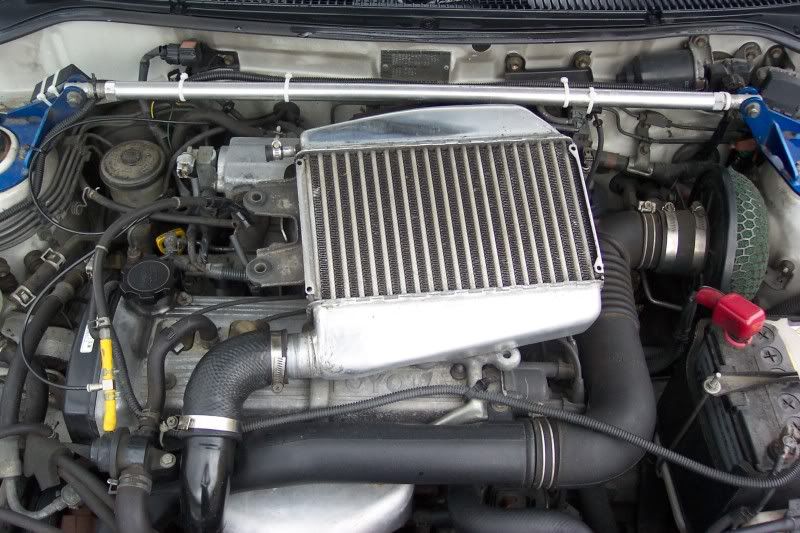

chriswoodfto Posted December 21, 2009 Posted December 21, 2009 http://photobucket.com/albums/f25/rubix_cu.../Picture010.jpghi guys, if you click the link, im tyring to find the little rubber stopper on the top left corner of the tmic, ive been to all the motorfactors in my area and none have any or any advice on were to get one.that pipe isnt needed for the glanza so i need summit to block it off with,thanks in advance. Quote

chriswoodfto Posted December 21, 2009 Author Posted December 21, 2009 hmm, works for me, heres the pic anyways, the rubber bit just under the 2nd cable tie in from the left, on the strut bar, Quote
Russleh Posted December 21, 2009 Posted December 21, 2009 id just get a longer bit of pipe for it and stick the plug in the end with a jubilee clip on it and one behind it to stop it poppin out. Quote

chriswoodfto Posted December 21, 2009 Author Posted December 21, 2009 lol. yeah yours is a cut n shut micky, thats why i reserved it for you. lol. nahh its because theres two diferent series that fit, series 4 and series 5, weve obveously got one of each thats why yours dont have brackets on the left or that little stumpy pipe coming off it and mine does, im gona cut the brackets off the left anyways because they look a little untidy. so, if i by a 2" piece of rubber hose to go over the little metal tube on tmic, a metal bung for in the end of the rubber hose,and just clamp them up nice and tight that should sort it?? cool. cheers guys. Quote
chriswoodfto Posted December 21, 2009 Author Posted December 21, 2009 right bung bought, the pipe i removed from the rocker cover to old standard dump valve fits so ill cut that down and use that as the pipe, cheer sboys, looks like youll beat me to fitting micky!!! damn christmas post.... Quote
