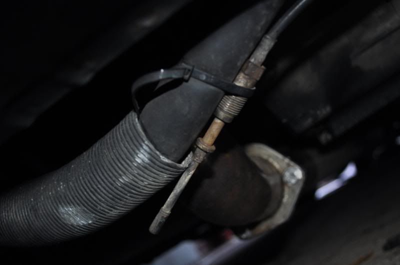

BAZ2CRAZY Posted February 20, 2010 Posted February 20, 2010 While fiddling with my car.. i stumbled across this suspicous fellow..What is it..Mitch Quote
BAZ2CRAZY Posted February 20, 2010 Author Posted February 20, 2010 I see... So im assuming on a standard system, this little badboy is encorporated into it somehow? What is its purpose? are there warning lights etc or does the ECU need a reading or somthing?Mitch Quote
Dan Evans Posted February 20, 2010 Posted February 20, 2010 goes at the bottom of the standard cat.Just warns you if the cat is overheating.No-one really uses them mate. Quote
lukEp Posted February 20, 2010 Posted February 20, 2010 there is a warning light looks like a cat with steam coming off it orange in colour its to tell you the cat is to hot and that means usually the air/fuel mixture is to lean. Quote
