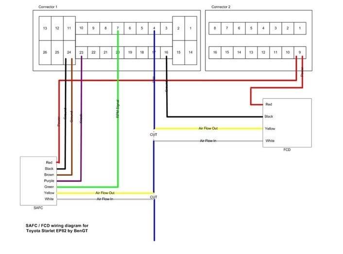

ep91_glanza Posted March 11, 2010 Author Posted March 11, 2010 Anyone got any pics or diagrams of the safc2 wired with a fcd cheers Quote

scot-ish Posted March 11, 2010 Posted March 11, 2010 thats colour match for HKS FCD, but signal wires are the sameseems like youve made a mistake with the wiring, or the fcd is damaged. Quote
ep91_glanza Posted March 12, 2010 Author Posted March 12, 2010 Ive just looked at the wires goin into the ECU and the blue wire on the diagram is green on mine but hasnt been cut Quote
