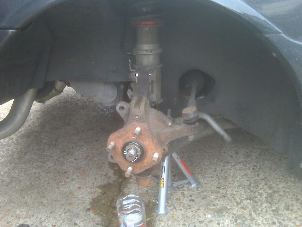

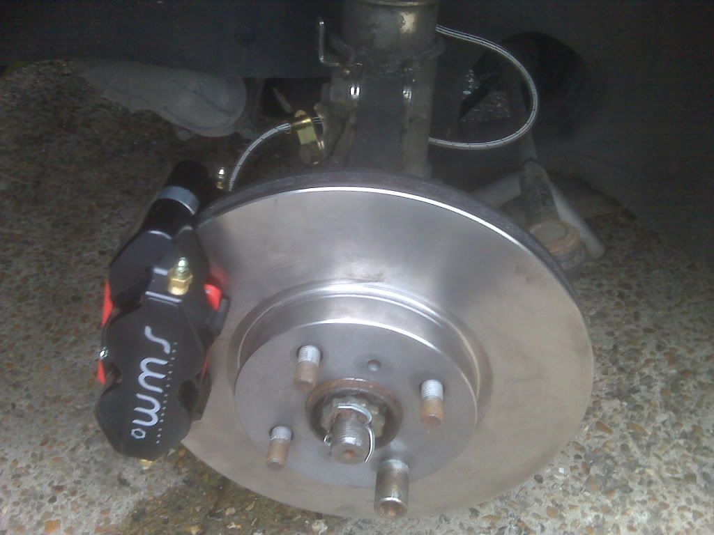

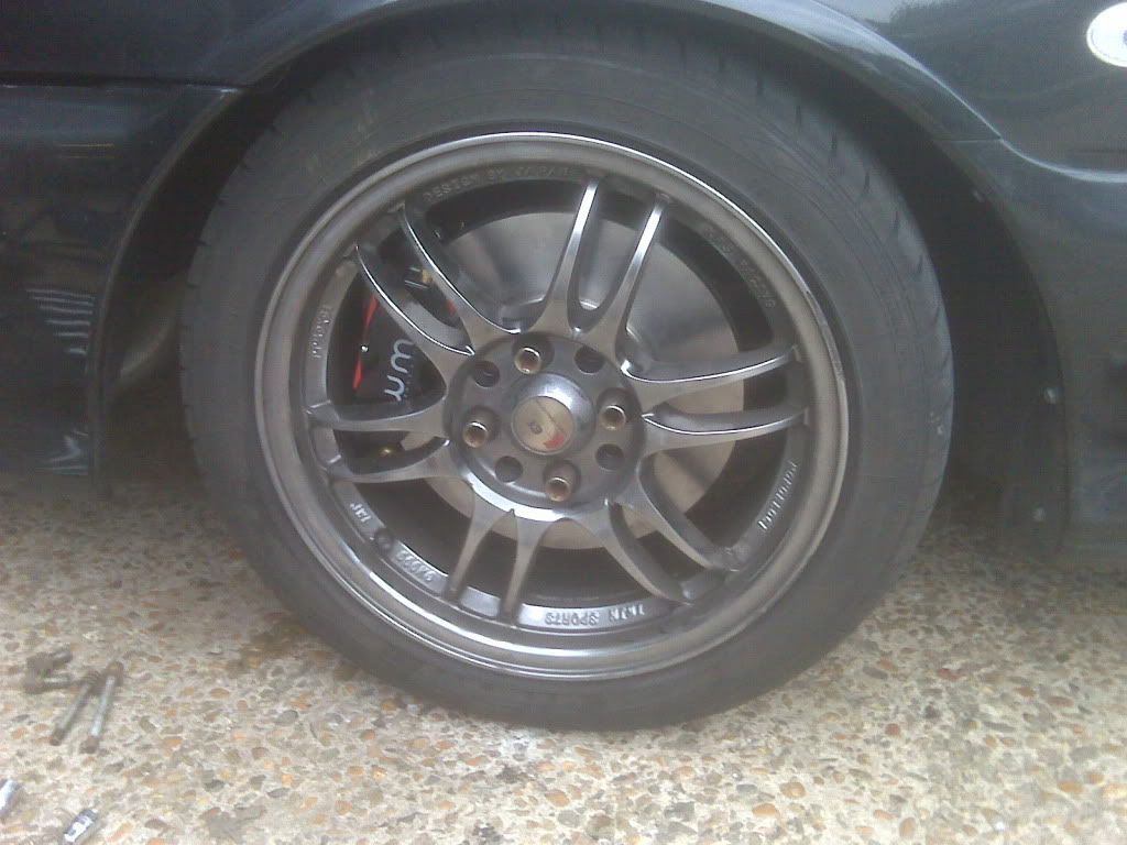

phil0694 Posted March 11, 2010 Posted March 11, 2010 Hi all,After talking to Keri at WMS I decided on a set of his 275x22mm brake kits. When I got the calipers I couldn't believe the lack of weight to them. the quality was fantastic and the price was unbelievable.Once I had got the rest of the kit I knew I had made the right choice and couldn't wait to fit them. Thinking it would be a bit of a challenge to fit them I was proved wrong. I decided to take the brake dust cover off instead of trimming. Next I fitted the brake hoseThen the caliper bracketNext was the discsNow for the caplipers and ebc red stuff padsAfter a while back on the car lift and a few bottles on rbf600 brake fluid recommend by alot of circuit racers and the wheels back on the outcome was Thanks to Keri at WMS for all the support, communication and the production of this kit! Quote

phil0694 Posted March 11, 2010 Author Posted March 11, 2010 look lush mate how much and what size wheels are they as i have 15s would they fit behind them also whats the stoppin power likeCheers was just over £600, they are 15s. At the moment just bedding in so unsure of the full stopping power Quote
Keri-WMS Posted March 11, 2010 Posted March 11, 2010 Great guide to fitting Phil - they look spot on under those rims! For reference the bolt torque settings for people playing with WMS kits are:"hand tight" on the brake line > caliper fitting, it's a 1/8NPT TAPERED thread and will "lock and seal" easily but feel ODD! Don't overtighten...30ftlb DRY on the 3/8UNC caliper joining bolts.40ftlb DRY on the M10 caliper > bracket bolts.65ftlb DRY on the M12 bracket > strut bolts (or 60ftlb DRY on the "beta" brackets).Here's how the brackets should be fitted:And here's how you can trim (plus a bit of tapping!) the heat shield to retain it:Follow the bedding-in instructions in the EBC box, then put some miles on them to ensure all the "brake-in compound" is gone, then give them hell! ;) Quote
