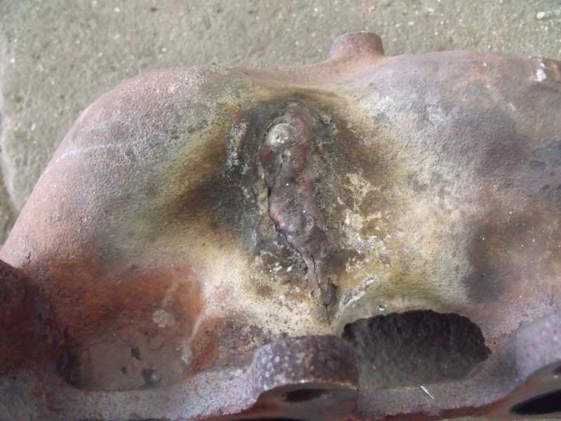

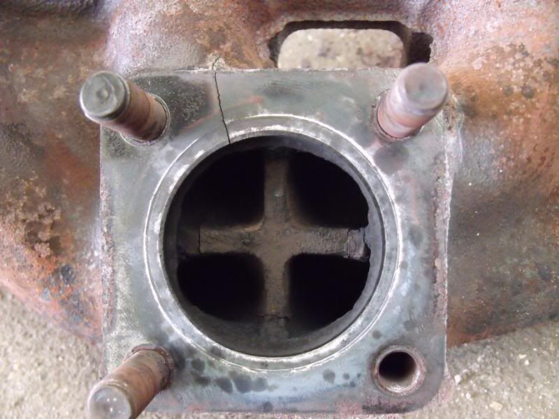

The standered mani was proper cracked right threw, was supprised at how bad it was..

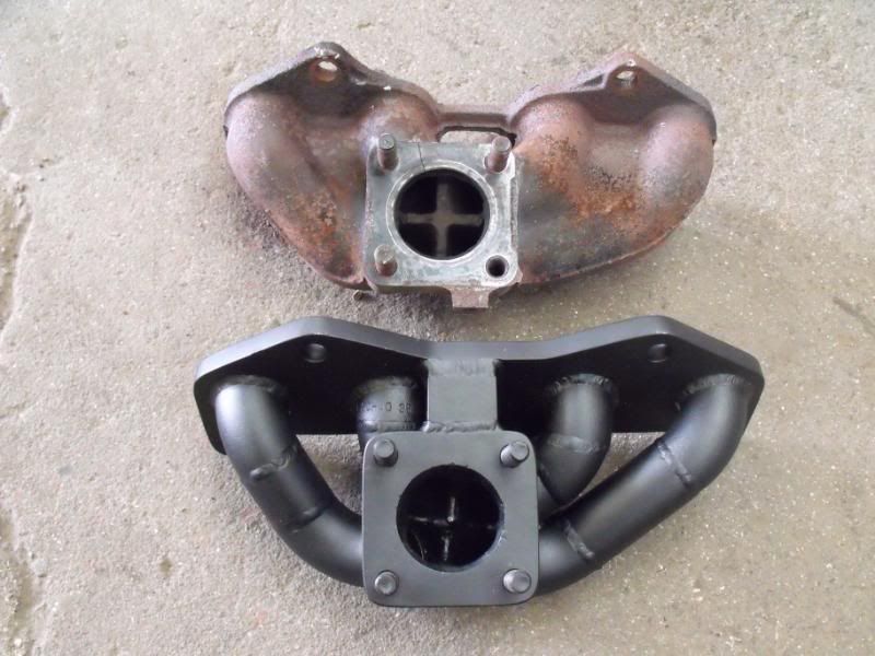

Old mani..
Old an new..

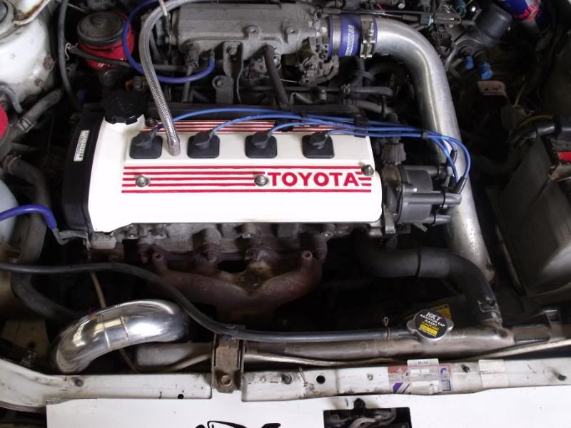

Also while was there had a oil filter an oil change, new coolent fitted some new plugs to...
Have really noticed the difference with new mani, boost feel's stronger so car is going pretty good...
I have also noticed the car does not flutter as loudly as befor, is this because it has a better flow threw mani so does not have such a build up of back presure??? Dont know much about it so if question seems stupid im sorry...
Looks tasty mate, that WEPR workmanship will do you proud :thumbsup:
