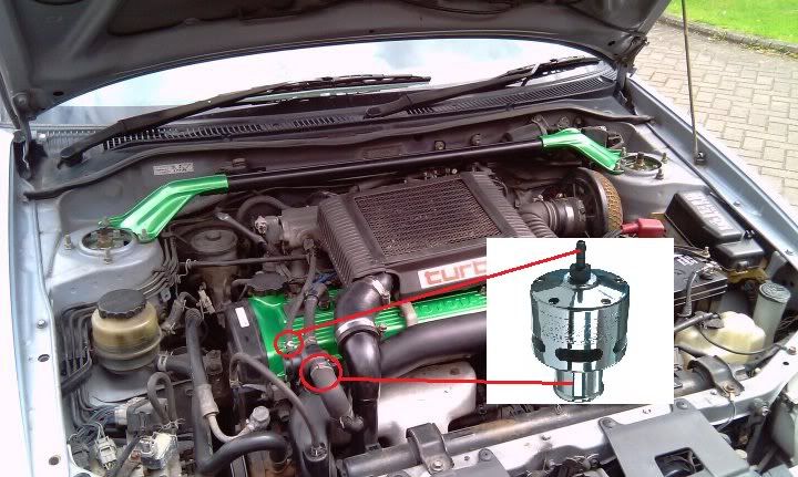

Josh@TunerLifestyle Posted August 6, 2010 Posted August 6, 2010 here you go mate best i can do! if this dosent help i give up lol basicly big pipe to bottom of your dump valve and the little pipe to the top, leave everything else where it is and thats it hope this helps matey Quote
JaymeGlanzaV Posted August 6, 2010 Author Posted August 6, 2010 Nice 1 josh, ill have a go wen I get in. Were I take it off the original thingy, do I have to block anything up, because that right lil pipe isn't really doin much or is it. Or am I makin no sense lol Quote
Josh@TunerLifestyle Posted August 6, 2010 Posted August 6, 2010 the little pipe goes to the small pipe on your dump valve and the large bottom one goes to the bottom of your dump valve, mite fit or as jason said you mite need a reducer pipe ( off egay) to make it fit , mine fitted the pipe neways, once youv done all that you dont need to do any more lol its hard to explane but im doing my best! lol Quote
JaymeGlanzaV Posted August 6, 2010 Author Posted August 6, 2010 ok i done what you said but both pipes are bit wrong size (lil ones to big and big 1 aint big enuf). but i held them on when meg reved it and there wasent any sound of watishh. ill just spend a few quid on 2 bigger pipes. then see what happens Quote
